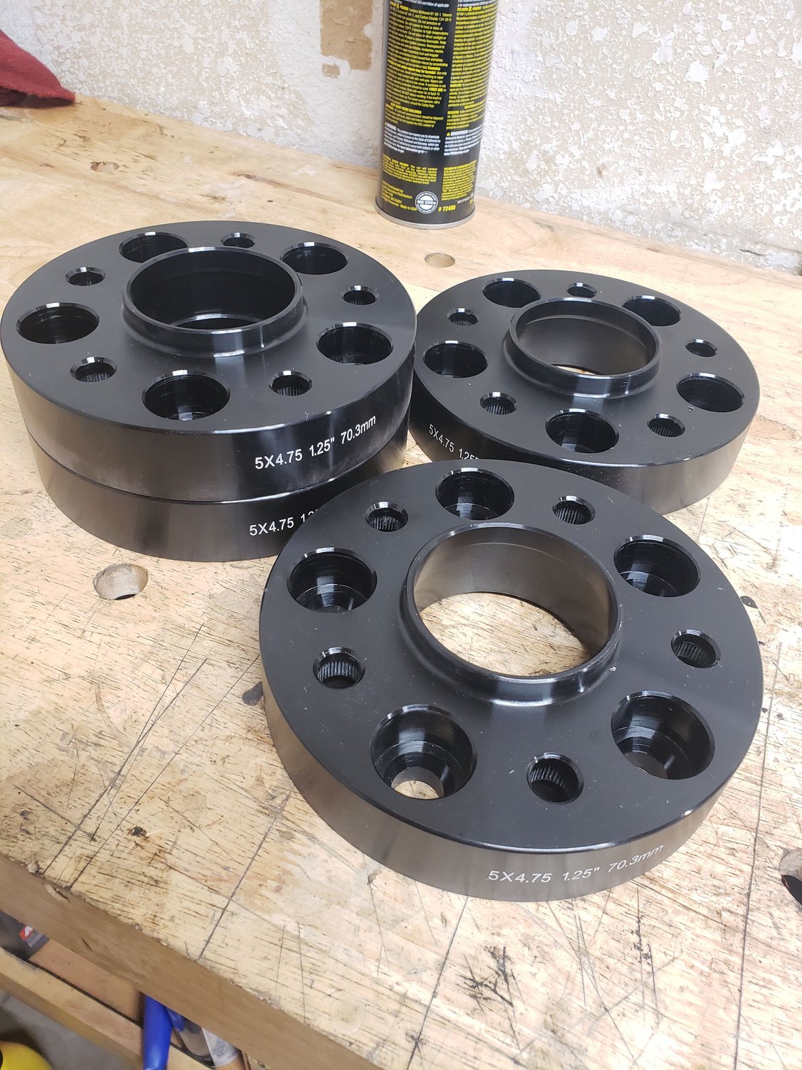

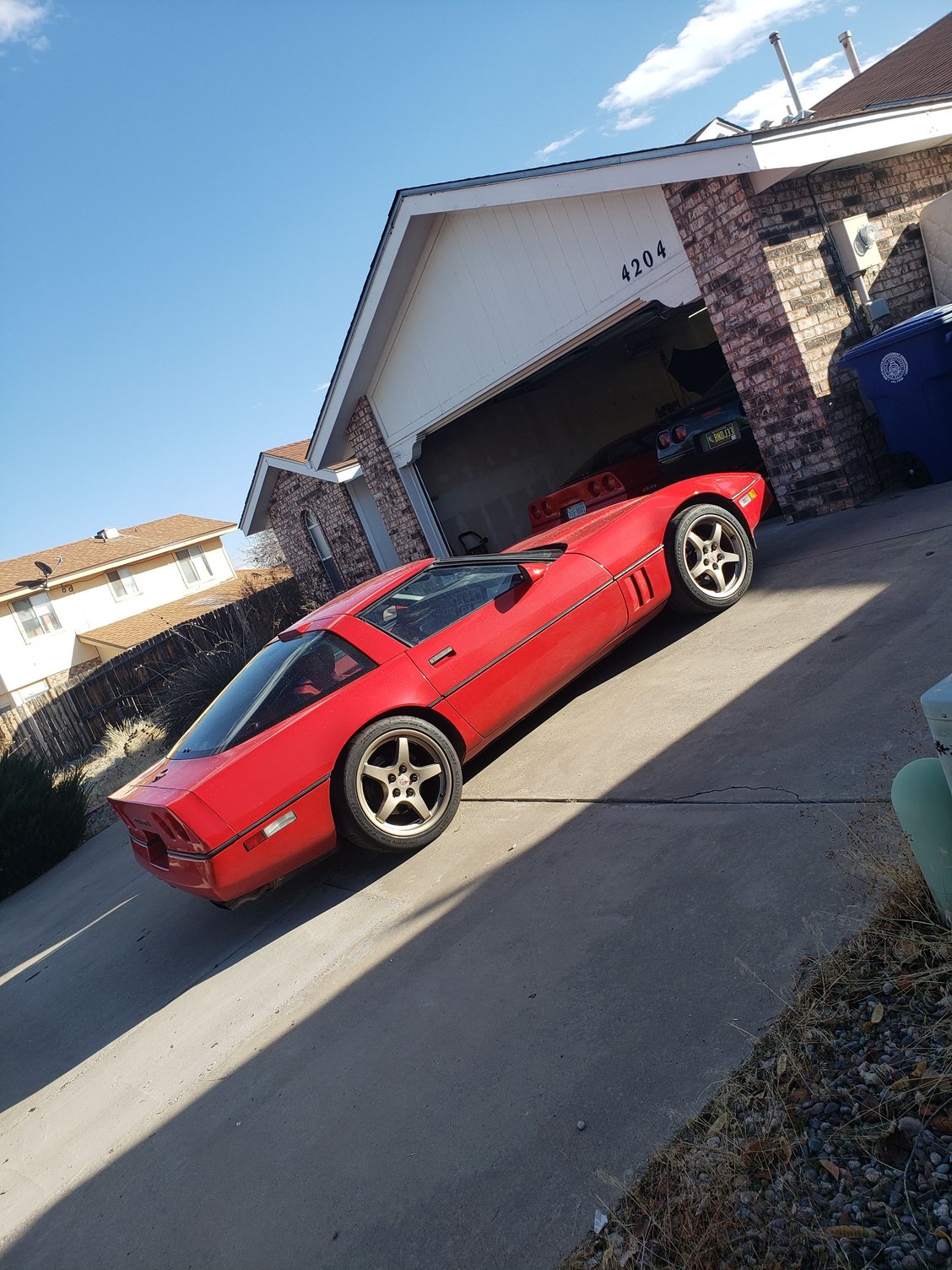

I am running a square set of C5 Magnesium made in Italy N73 option 18x9.5" 65mm offset all four corners with 275/35R18 Kumho V730 tires on my 1989.
I am using very long ARP wheel studs, a 20mm spacer in the front and a 32mm spacer in the rear. Actually they were wheel adapters that I knocked the studs out of to run as spacers.
Hubcentric with correct 70.3mm centerbores. Test fit on my hubs and on the wheels using the paper test to ensure good tight FLAT fit.
These spacers bring the 65mm C5 magnesium wheel offset to a net offset of 45mm front and 33mm rear.
Fitment is decent. I have like 3 degrees of negative rear camber on this car so these skinny tires and wheels still tuck under the fenders. My front camber is unfortunately weak at like 0.8 degrees negative so there is some poke up front.
88-96 base came with 56mm net offset factory wheels 17x9.5" sizes for most years. This means to get factory fitment, you just need a 9mm or more likely a 10mm spacer.
Lots of aftermarket A Mold wheels for 88-96 cars are 17x9.5" 50mm offset. To match that, you just need a 15mm spacer.
