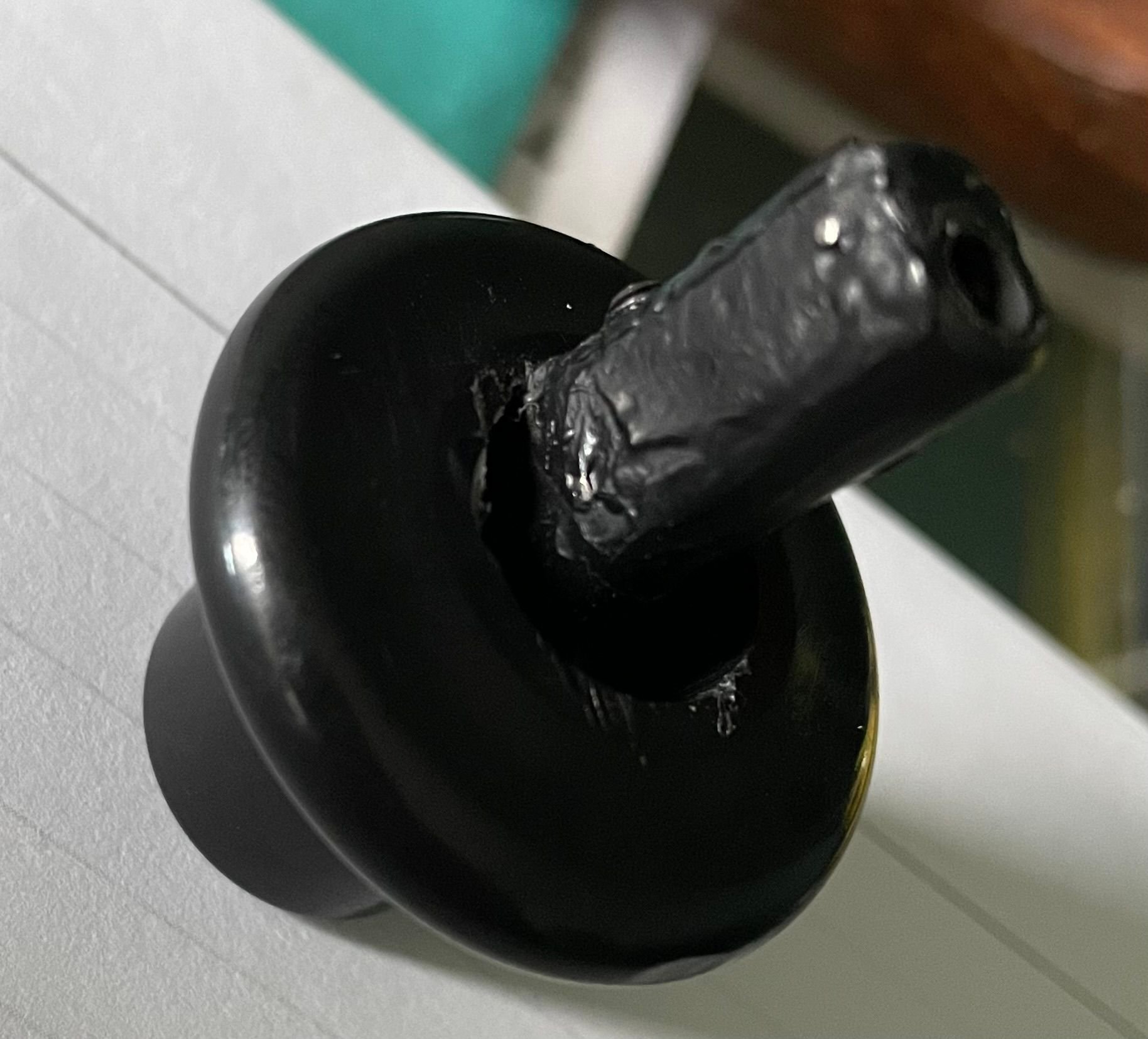

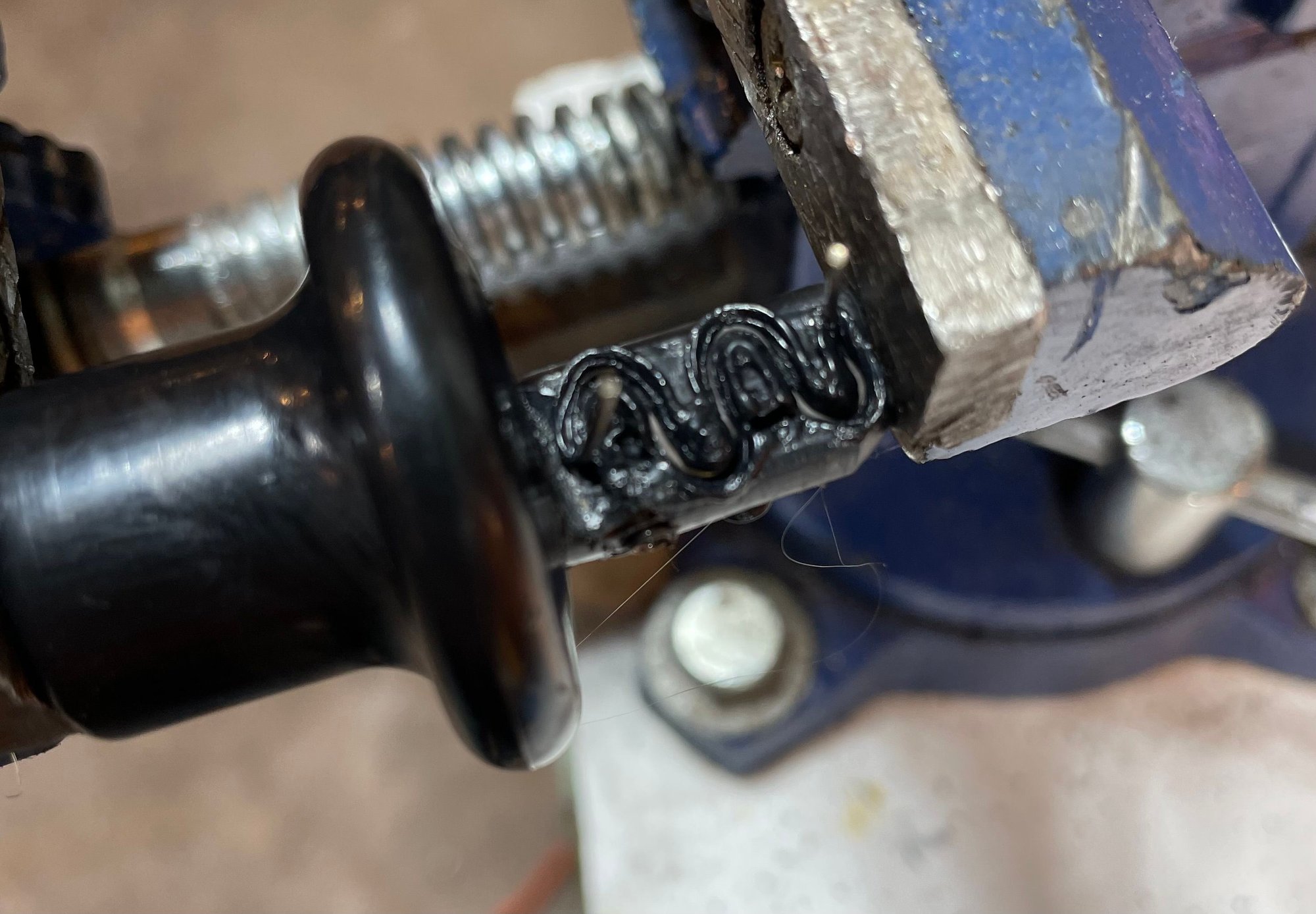

Old Mar 21, 2024 | 08:37 AM
jmgtp's Avatar
jmgtp
Joined: Aug 2009
Posts: 1,971
Likes: 243
Interim solution… plastic welder.
I’ve been eyeballing a plastic welder for a while and this was the excuse to get it. If you are unfamiliar, it works by heating a steel wire filament which is then melted into the plastic, cooled, trimmed, smoothed. So what I have here is my original 1994 lockout ring mended with 2 squiggly pieces of steel.
its not perfect and it ain’t too pretty, but it’s solid. Haven’t installed yet but I think it’s going to hold up just fine, if not better/stronger. It’s so out of sight hidden under the shift **** that I don’t think the imperfections will be noticed.
I squeezed it just a bit in a vice to close the gap in the crack, melted a squiggly wire in each side, smoothed and that is it.
To Solution for broken reverse lockout lift ring?
