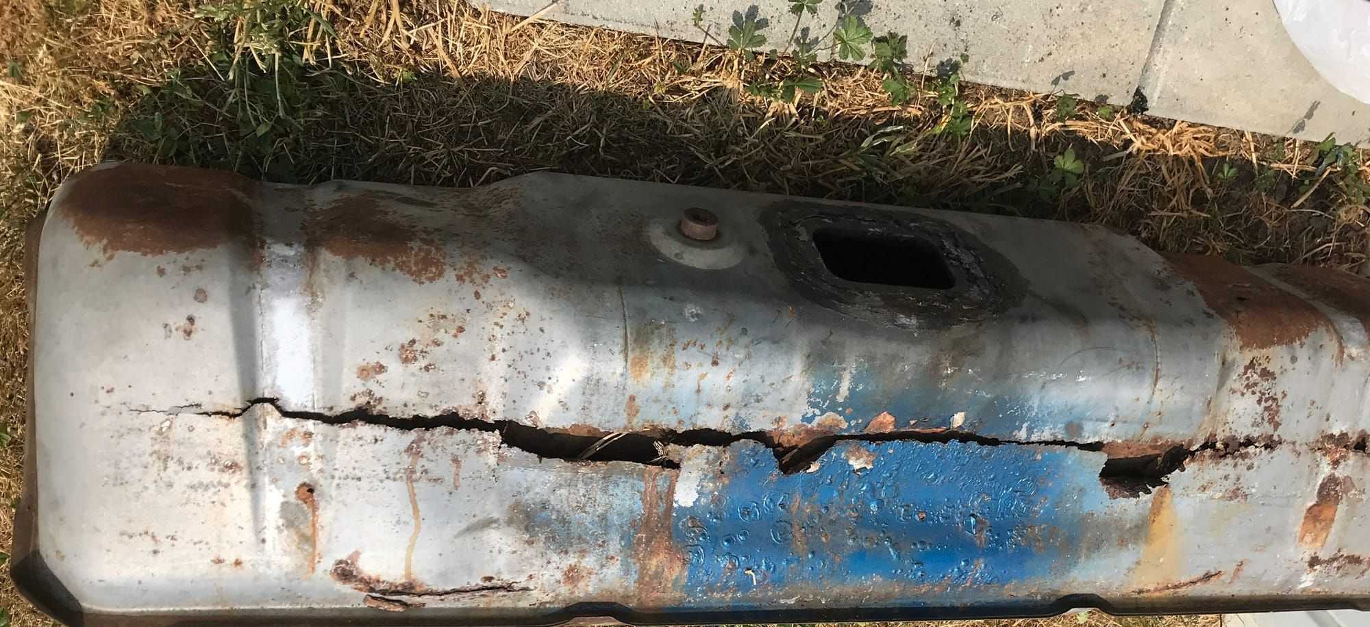

This is purely for informational purposes, but when I had that problem, the rust had spread beyond the rotted bolts themselves and to the filler hole where the sender bolts on.
I opted to just replace the tank on good advice.
But when I removed the old tank, the true scope of the problem exposed itself.
It was between the tank and the rear bumper where you only have a few inches of space so it got overlooked.
You should probably give that area a look wth a flashlight as best you can get a beam in there to see and really give your tank a thorough inspection before messing around with the bolts. These tanks, at least the oem ones, rot from the iside out. At least that's what I concluded after really looking at the old one that I pulled out. Over time, the inner liner of the oem ones start to separate and moisture gets in between it and the tank on the inside. At least in my case anyway. I'm sure it's not an isolated occurance, though.
Fuel tanks are relatively inexpensive for these cars. It's a one man job to just replace. And you get new bolts and gasket. At least I did with the one I ordered from Zip.
