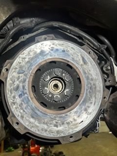

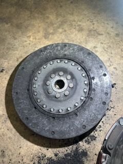

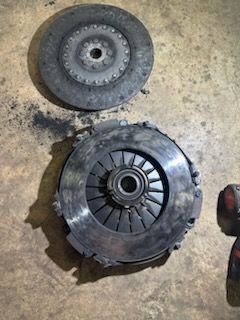

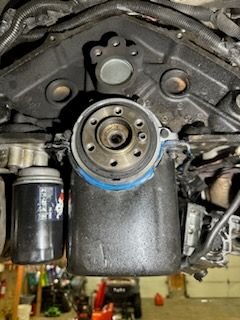

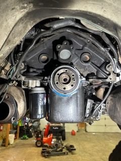

Mechanic isn't sure what happened. We didn't replace the flywheel and I think it burned me. New Carolina Clutch conversion kit to a single mass flywheel ordered with shim kit...

is that a McLeod street twin disc clutch?
looking at the photos , im trying to understand what failed.
was it slipping? Or did you break loose the hub from the clutch disk (as i did once on a spec stage 2 clutch)
i see very heavy pockmarks on the flywheel side

Hi, It was a Street Pro kit. Yes, it just started slipping and shifting was getting difficult - engagement point was right at the top, barely had to push the clutch into shift. I replaced the slave cylinder in desperation to not have to do this but there was no change. So here we are, twiddling our thumbs and waiting for the new parts.

Sounds like it was partially depressed and didnt get full clamp load.
When the disc wore, it started slipping.
Maybe its stack height wasnt the same as stock, your pivot ball stud was modified by a prior owner, clutch fork 'bent' somehow, or a really 'bad' korean copy of the Valeo pressure plate.
The Valeo pressure plate reproductions havent been good, with 'leg heights' varying across the plane. ZFDOC knows how to check and fix these.

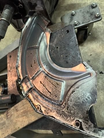

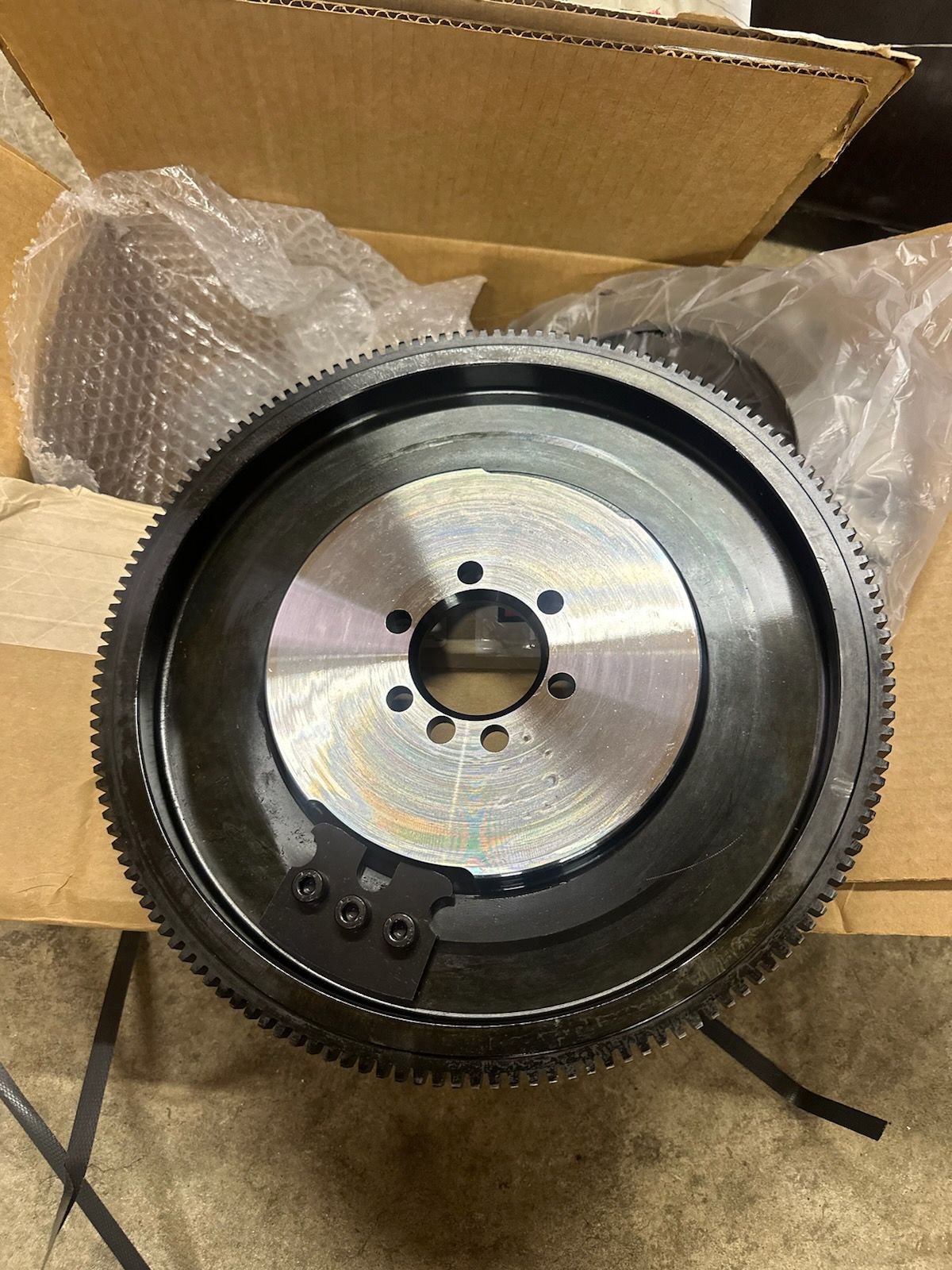

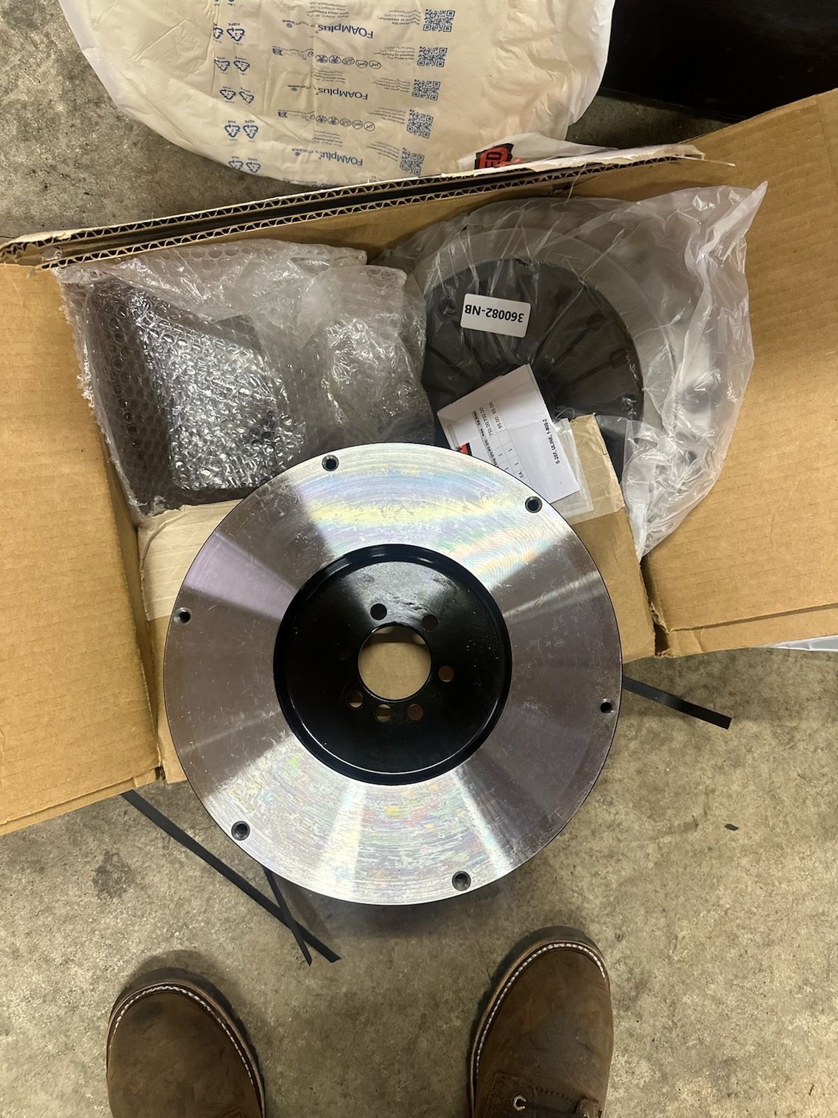

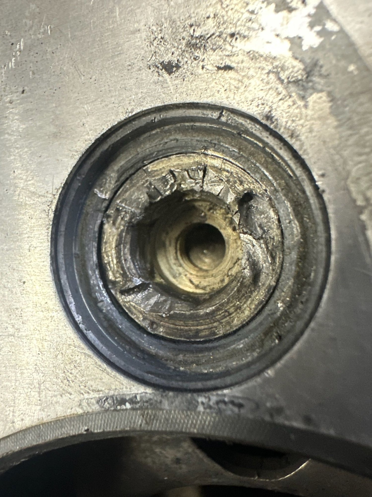

New flywheel is in - super sexy, to bad no one will see it! From my mechanic: That fork ball hardware, one of them is threaded backwards. And yours looks a little wonky
