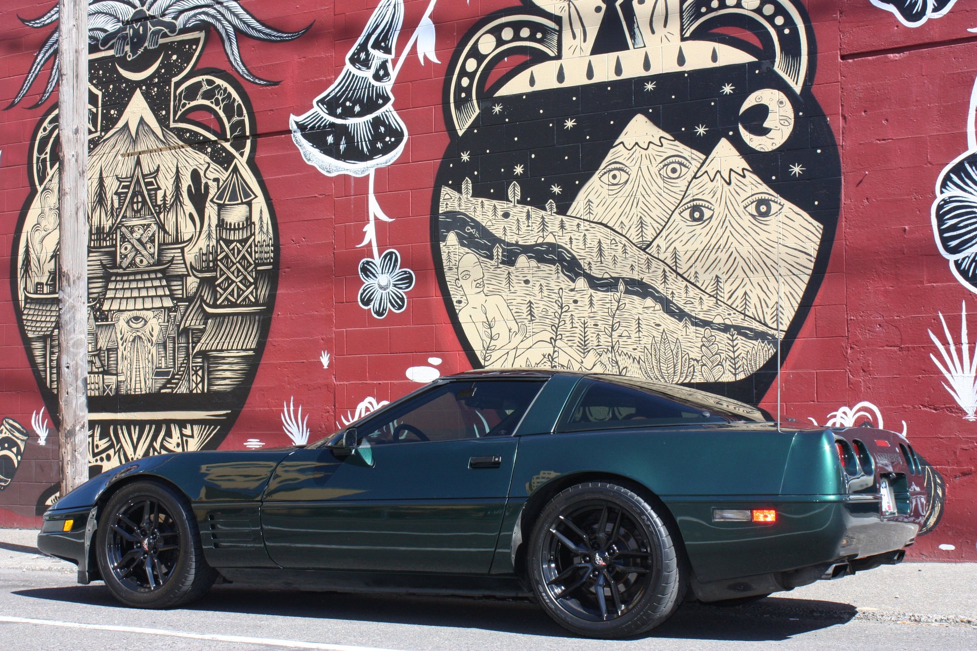

Originally Posted by c4stevette
Here is a pic of my car that I took a couple years ago. It looks the same but with a car cover over it!!
What's your wheel/tire combo..with offset if you don't mind?
Looks great.

The front wheels are P255/45/ZR17
The Rear wheels are 285/35/ZR18

That's one nice lookin' car!
