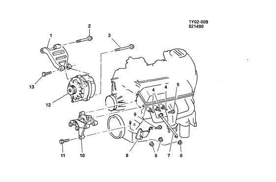

Replaced water pump on 91 vert with L98. Had a bracket left over and I don’t know where it goes. Can someone throw me a bone?

This should help.

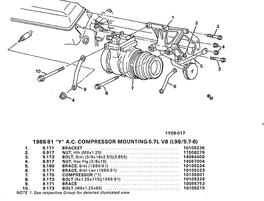

Or maybe this brace

Thanks, I see it on the diagram

You'll notice that those four bolts that mount the A/C compressor to the aluminum bracket - 1 of the 4 is longer than the other 3. That long bolt is the one that goes bottom front of the compressor (115M long) and mounts to that bracket with an M8 nut on it.
