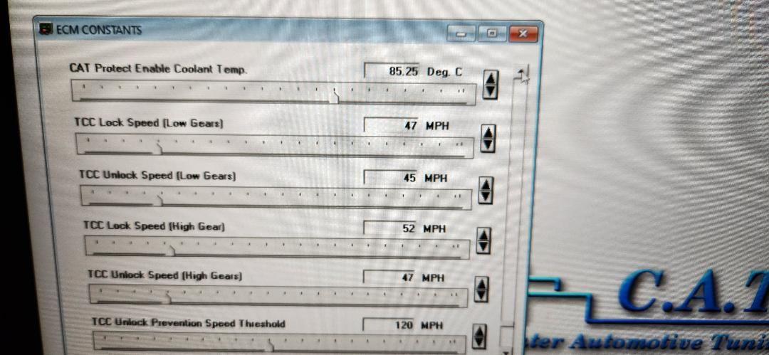

My 93 allows the Converter to be locked up. I used Cats tuner, adjust it to what I want in 3rd and 4th gear. Then I use a moates to burn the chip to a memcal adapter.. Pretty easy.
