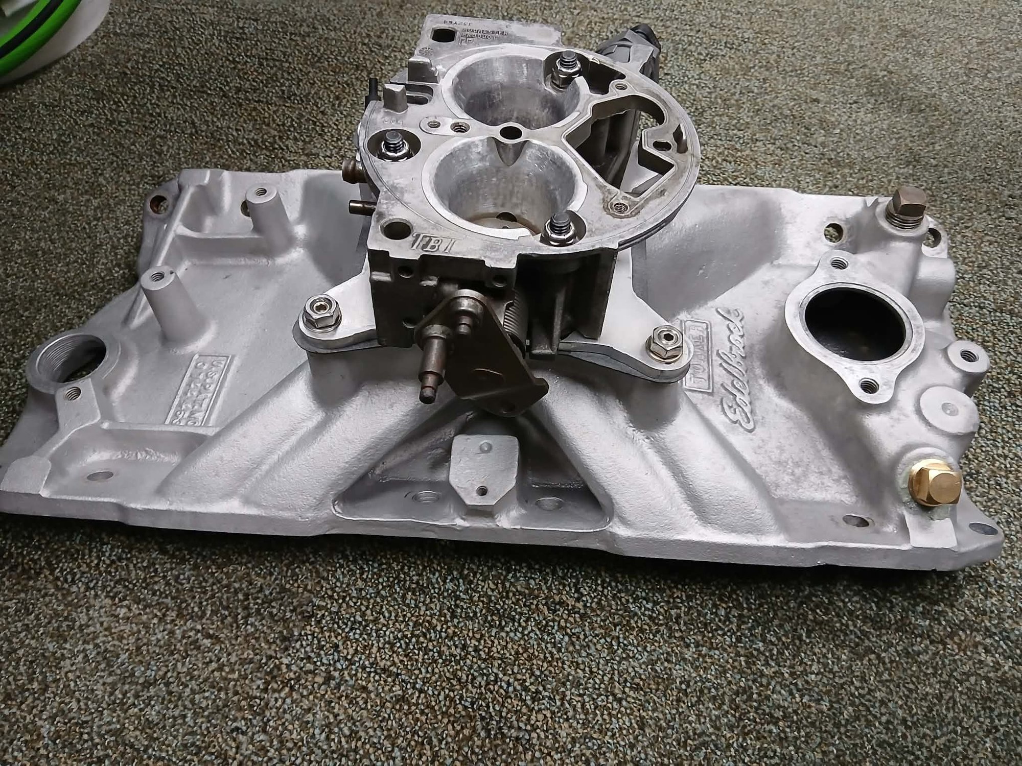

I am in the middle of building my vevor 200cc 68cc heads..bought my own hardware for the bare castings. I also have a torker 1 intake with a TBI adapted to it from a 350 Truck motor...all the wiring will hook up to TBI and can keep the stock ECM and Distributor...I will let you know how it goes...keeping stock cam....

I am going to use TBI and a normal low rise edelbrock intake. 1.6 roller rockers as well

Most likely it will run lean. There's fuel pressure adjuster for sale for tbi. At the very least it will need more fuel pressure. 2v manifold flows 222cfm average. If those are like dna heads, they flow 225cfm at .400 . Dna heads have raised ports. May need port match.

Thanks for the tips. The intake is slightly smaller than the head port, have to compromise and use a 1205 gasket so it will seal both the head and the intake. Better to be a little small on the intake vs the intake being larger than the head port. I know the guy changed the pump in the car, but not sure what pump he put in....I heard only the newer pumps are regularly available..not sure...There is a stiffer spring available for the TBI, or someone said they shim the spring with a quarter. Others drill out the lead or weld on the original tbi regulator and make it adjustable with a set screw...my intake is a Torker 1..which is better than a Torker 2....also smaller ports to keep the velocity up...I made my own adapter plate, since the throttle pulls towards the front of the car and all the fuel lines are in the front it made sense to do it this way. Also the adapter you can buy put the TBI in the rear of plenum vs center, for a spread bore intake. I have all the parts to put my heads together...just went with Z28 springs...Elgin valves, springs, retainers, Trick Flow spring cups...blah blah....My friend has a shop where I can check and adjust spring pressures and he can cut seats if needed....actually he has a full machine shop he bought from a local shop that closed.

that's a different manifold then I was thinking. that will flow more.
