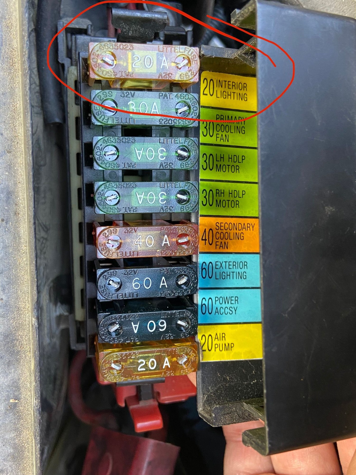

1995 auto lt1. Car started every time but had a battery drain so I would keep it unplugged when not in use (still working on it.) After looking, the biggest pull was from the radio fuse. After removing it, there was still a small drain (0.100 or so) and after pulling the interior lighting fuse it drops to 0.010. I figured this to be the problem until I tried to start the car. I hear the fuel pump turn on but when you first try to start it, nothing. The second time it starts every time, and then dies after about five seconds. When I put the fuse back the car will start like normal. There may be an issue with my battery too from dying too much, as after a couple tried of starting the car the starter will start clicking and nothing happens. Recharging the battery fixes it temporarily. I just don’t know why pulling the interior lighting fuse makes the car not run properly.
This fuse is the one that does this.
