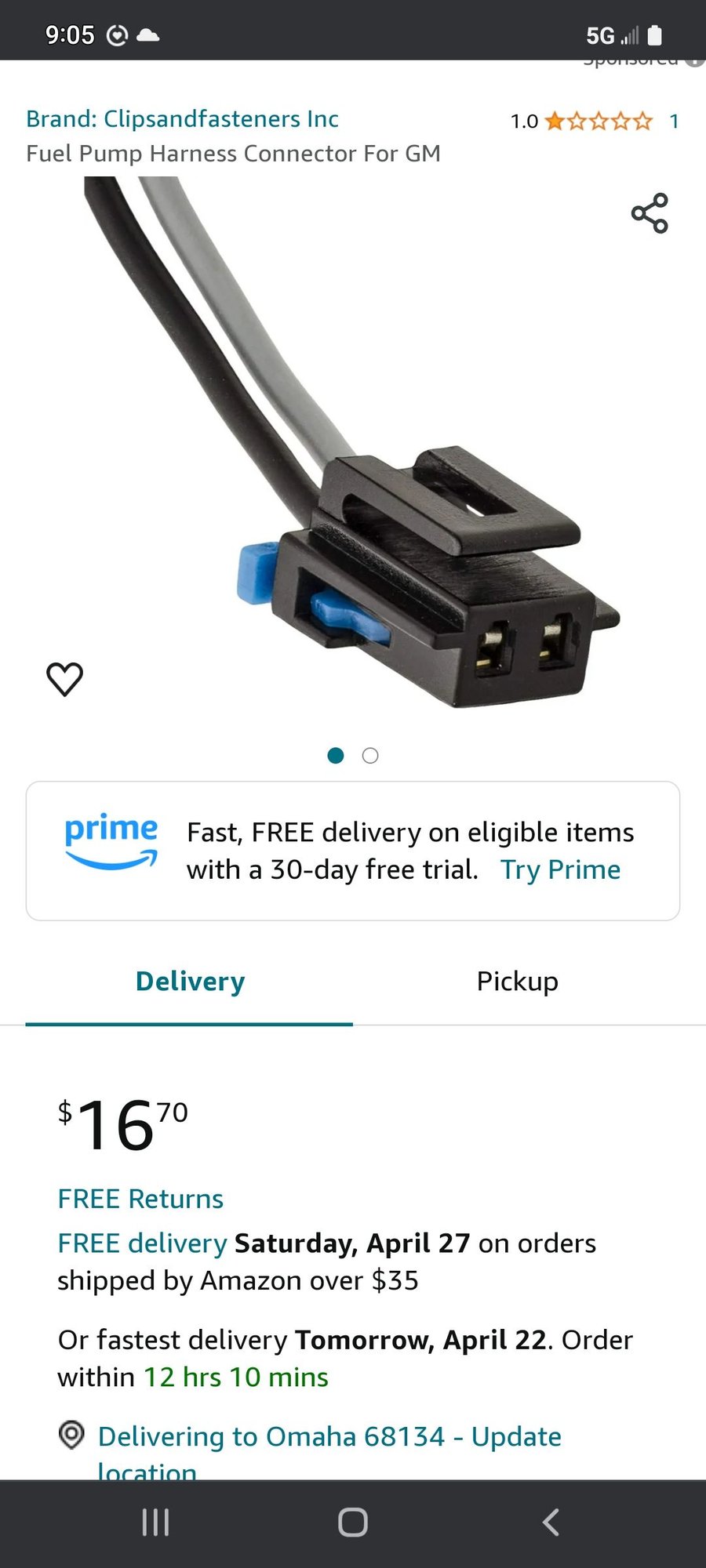

GM 25117765, you can buy genuine or cross-reference the #, assuming you have a Delphi FE0110👍
Amazon using GM #

Awesome! Thanks for finding that. Every parts store I showed the pump to was clueless and I couldn't find the part no. Duly ordered and hopefully my Vette will live again.
