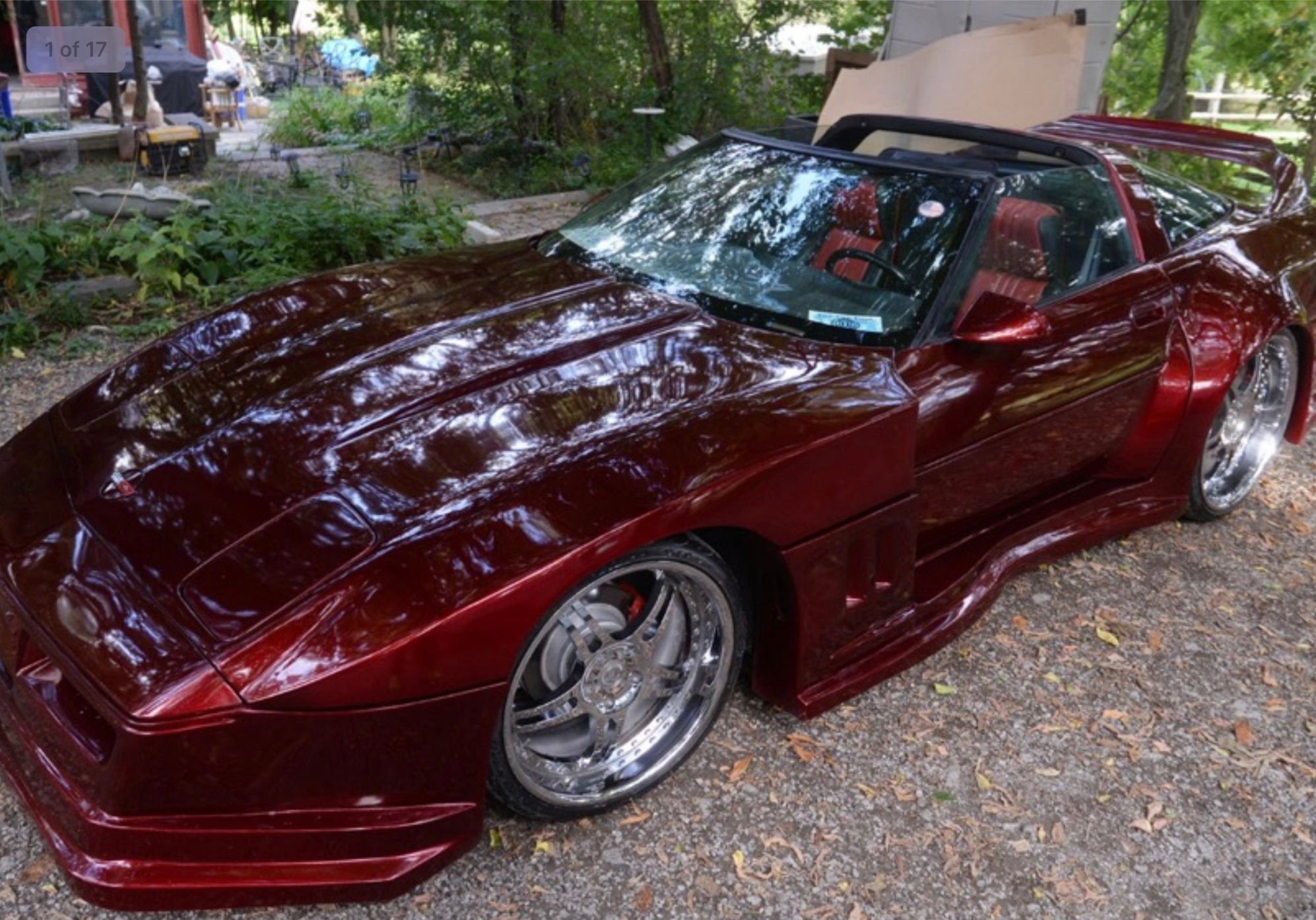

Hi guy wondering if I could get some help this being my first c4 1984 crossfire I had a problem with overheating so well I just removed the heads yup gasket time but in reading about my heads 462624 find out they are literally the worst one to have and suggested not to waste my time reinstalling them do to the fact there are prone to cracks I need help with finding a better set of heads that will work with my pulleys and intake .

If its still got the 1984 Crossfire engine I would not do anything special. Unless your heads are cracked I would consider them good to go and forget about the rumors. Boy somebody sure has some time into custom body work !
