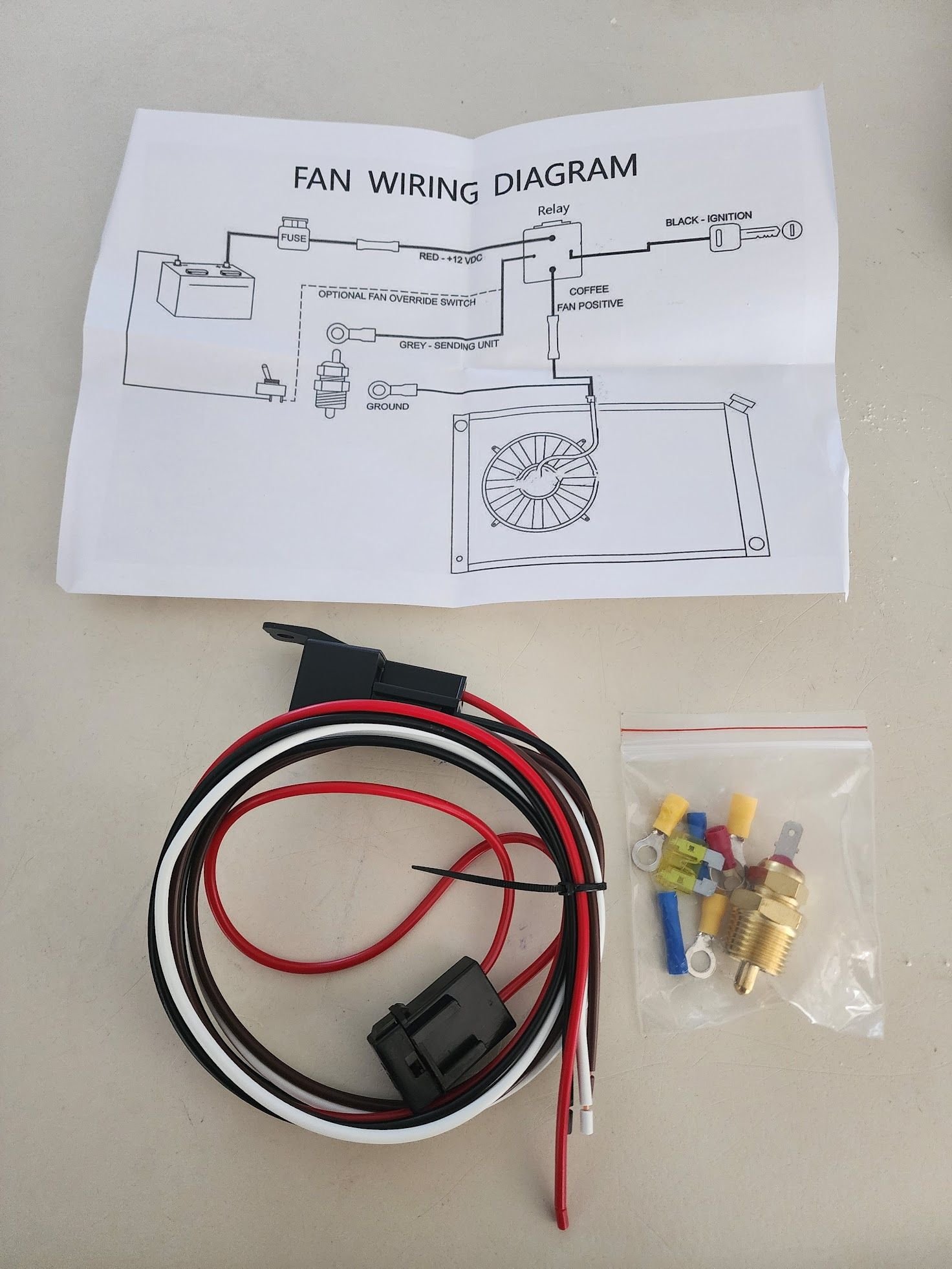

I can't say I've had your issue exactly, but when I bought my 84 the factory relay on my coolant fan was melted and the fan would not spin. I also replaced the relay with an aftermarket relay that had similar wiring and the fan still wouldnt spin. Same as you I connected direct power and the fan spun without a problem. What I ended up doing was buying one of those cheap relays on amazon and wiring it in. Now in my case I am controlling the coolant fan with my FiTech unit as I wired it in, in place of the temp sensor as most would wire in a toggle on switch in the dash. But it is capable as running as a standalone and will come on when the sensor hits it temp. you could also wire in a manual override as mentioned above. Just a thought that might get you by even as a temp solution for very little cost, I paid something like $20. Here is a picture:

interesting I’ll look into it was trying to get it running like stock as it should before anything but this might be easy solution
