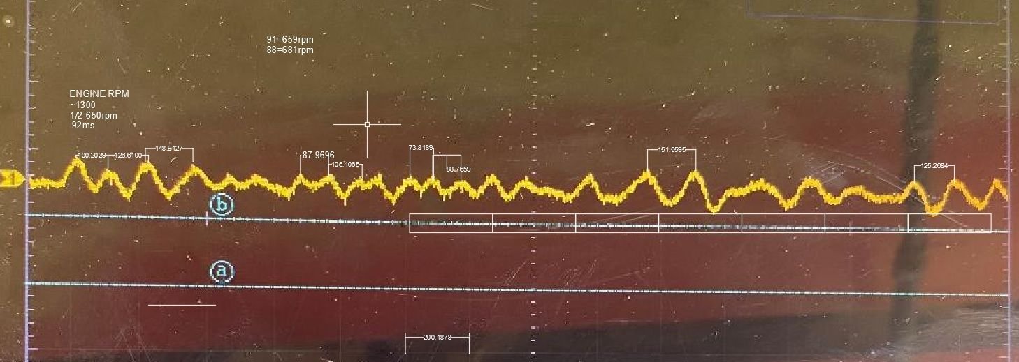

I also have a screenshot from my oscilloscope that was connected to a DIY piezoelectric pressure gauge.
From this picture those pulses may mean one of the cylinders could leak into coolant from one of the cylinders. The larger period between them may be an indication of a missfire. I'll try to disconnect one injector at at time and see what happens.
PS
I’ve repeated the test, this time I held the sensor steady in my hand, previously I had given it to a friend, it’s possible he didn’t hold it properly. The sensor is very sensitive on pressure changes. It reacts to less than 0.5psi. There are no detectable pulses in the coolant when cold. The only thing that happens is if I put a hose from the top tank into a water bottle after like 30s there are a few bubbles coming out then nothing. If there is a leak it is very small and it gets sealed after the engine warms up.
