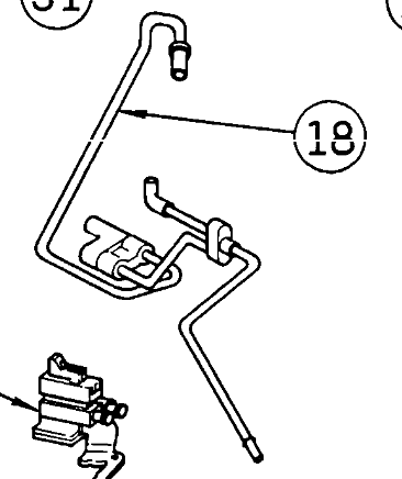

My 1987 l98 EGR Valve Vacuum Harness (10046113) ended up with a damaged line during my rebuild and I'm having trouble finding a good replacement. Anyone have one lying around or suggestions?
I'm hesitant to do an EGR delete for two reasons:
1. It's all back together with EGR compliant Long tube headers, I just need to replace this.
2. From what I've read there's not really any benefit to an EGR delete

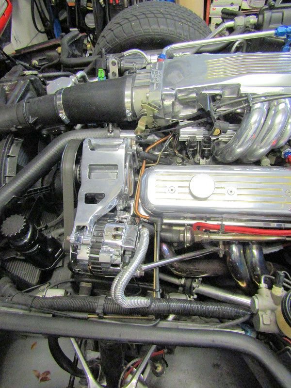

When the 1/8" plastic vacuum lines broke on my '87 I bought 1/8" brass tubing, bent it to match. I drilled out the plastic in the rubber fittings (twist the drill bit by hand) and put the brass in its place. When the 1/4" plastic tubing broke, I used copper tubing. As far as I can tell, the replacement tubing offered on eBay is taken off a wreck. Something about paying $79 for 37-year-old plastic bothers me.
Brass & copper vacuum lines.
