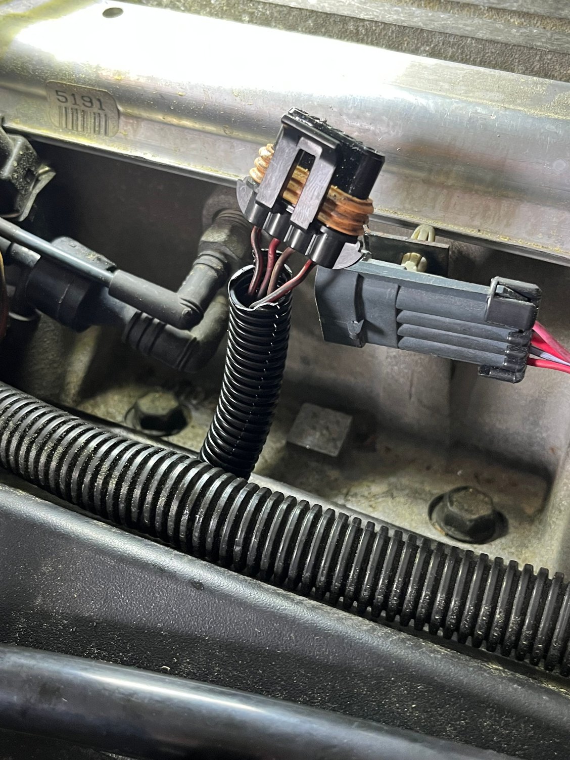

I've made some progress. I discovered two wires from the optispark harness grounding against the fuel rail.
Also, the temp sensor for the computer ohmed out correctly when comparing to the FSM values.

Update. Repaired the harness with shrink wrap on each wire and a new corrugated tubing cover:
I got it nice and hot today, let it sit, ran it again, and idled it for a while. Seems to be running fine so far!
