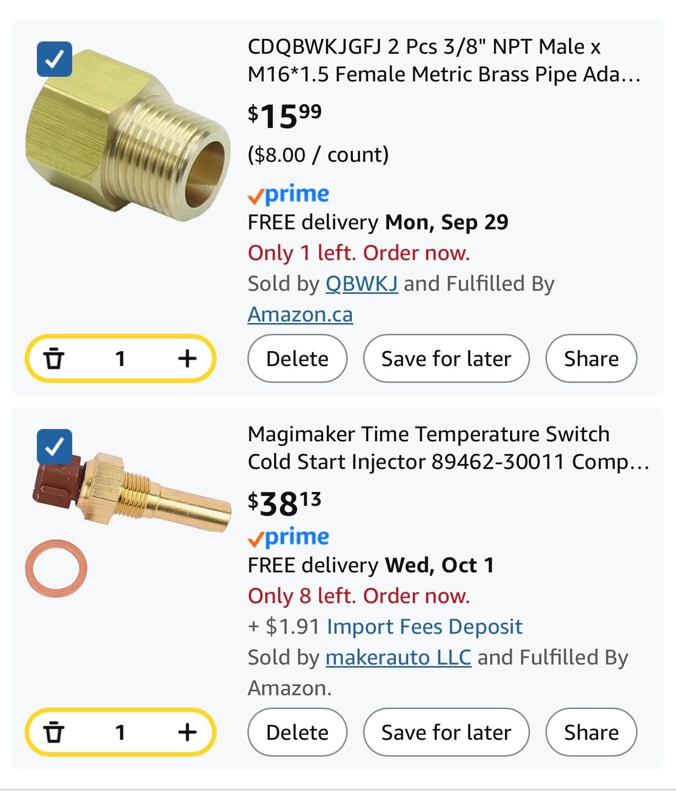

Ran across this. I can't confirm but it's probably worth checking. I see the switch on Ebay with prices across the board. Maybe it'll help someone on here.
"Not sure if this is a known fix but I figured this out. This is for anyone who has issues with their cold start injector and the thermal switch is bad and we all know the switch isn’t available or are stupid expensive if you can find one. I found this thermal switch used in older Toyota 22re engines. The connector is the same the internal wiring is the same but the thread pitch is different. I got a female m16x1.50 to male 3/8 npt adapter. Hope this helps anyone with an earlier car"

thanks I’m gonna give this a try.
