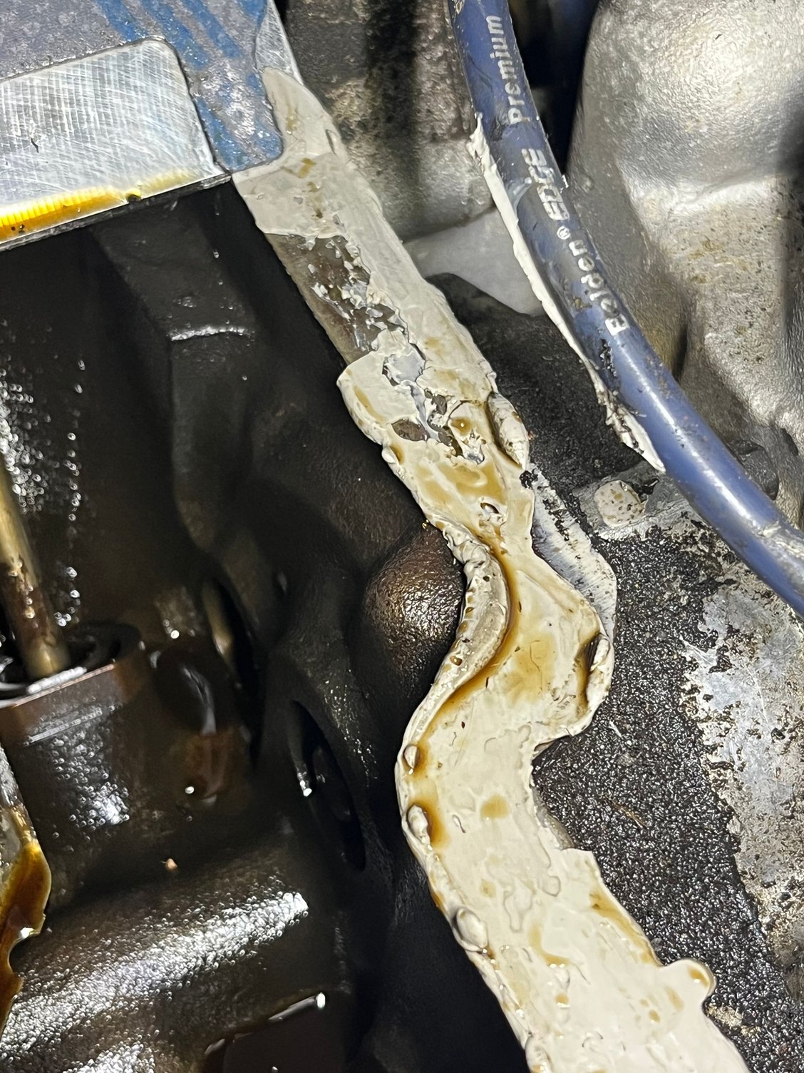

I replaced the intake gaskets for the common LT1 intake wall leaks, but long story short it failed miserably.
I used the FelPro set with the included RTV tube to seal the walls. I removed all the old rtv, cleaned with brake clean, and reapplied. I made a nice thick bead on the front and rear using the whole tube, but it apparently didn't work.
It was fine for a few days but rapidly began leaking. It started dumping oil from both the front and rear of the intake. While running its running down all over the oil pan, oil filter, bell housing, and both cats.
What did I do so wrong? I've done plenty of china wall RTV gaskets on traditional sbc and sbf engines without issues...
Is there a trick to this I failed to grasp?
I went ahead and ordered some more gaskets and a new tube of Permatex Ultra Black to try again.

I just got the intake back off. Something on the front China wall messed up, but the rear had a very nice spread and distribution of the RTV. Kinda scratching my head.

Looking at the pictures, was the manifold itself dirty, oily?

The manifold got the same cleaning and brake cleaner treatment as the block

Sometimes its hard to know.. Warped manifold, not sealant on bolts, bad gaskets? Have to look from all angles.
