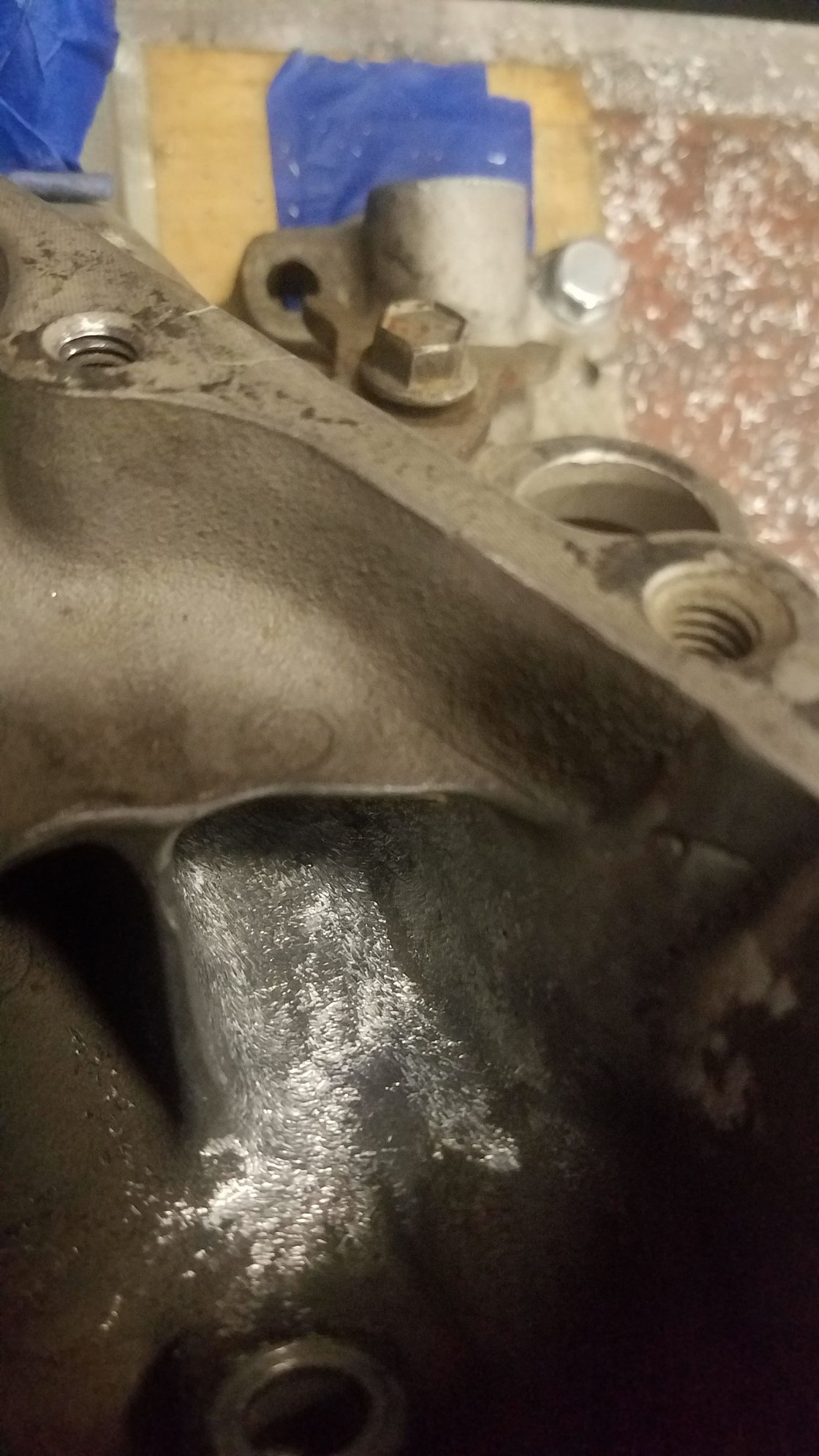

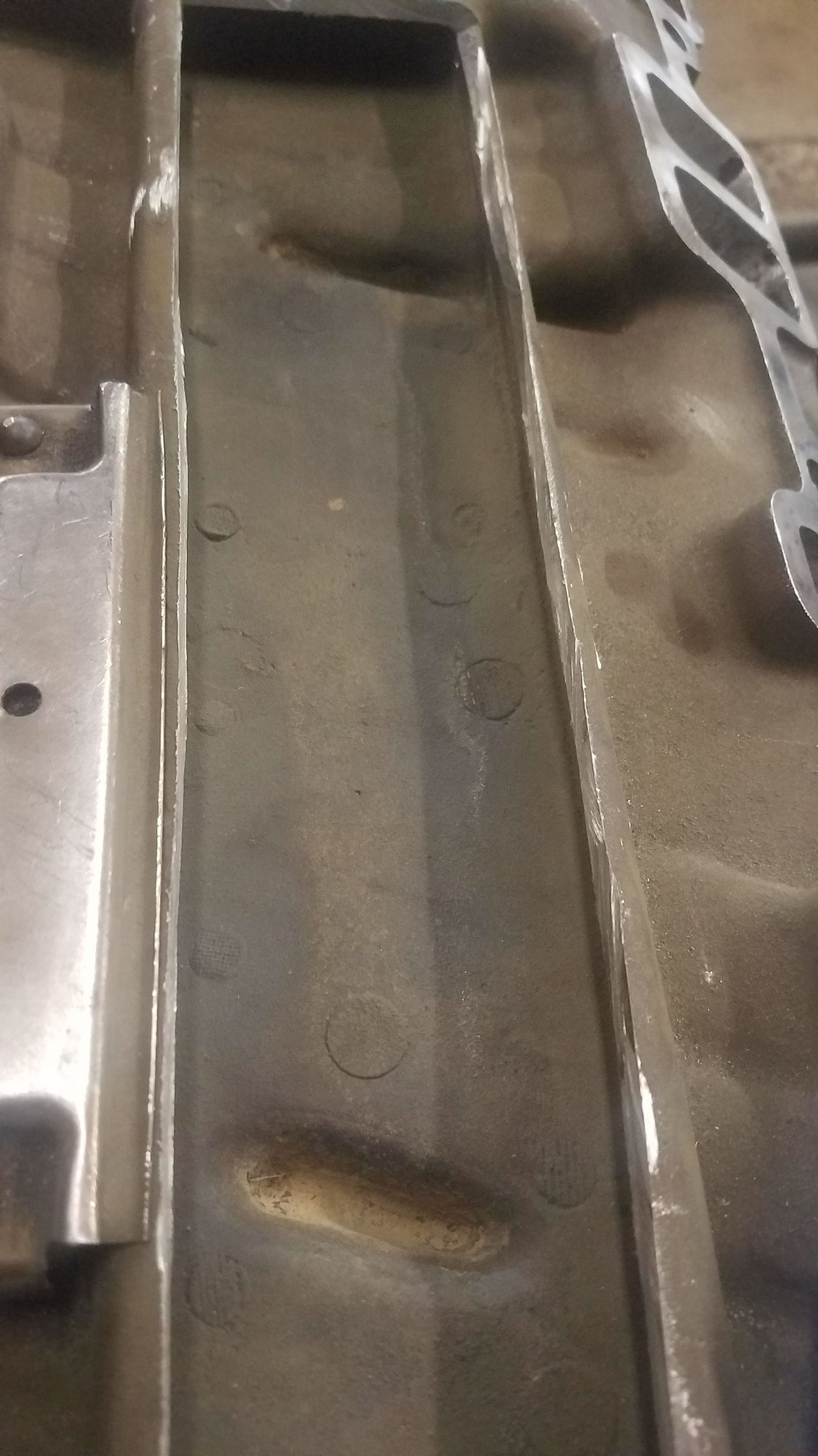

1985 fuel pump and adjust fuel pressure to 13psi
replace stock exhaust manifolds with headers and free flowing exhaust.
port intake manifold. port match head side and taper entrance is all that is needed for stock cam and heads. I would clean up the full length of runner also.
this is relatively easy. this is as far as I would go with stock heads and cam. this is relatively cheap and easy.
after this it turns into a project. just matters what you want and are willing to do
tapered entrance. side to side taper 1.1 to 1.2. top just tapered with available thickness. tapered the end of runners
head side. ended up with gasket match. this picture shows port a little smaller
manifold with rod welded to opening. a lot more work. It's not perfect, for sure. the inner 4 runners are easier to increase cfm than the outer four runners.
can't just hog out runner, because water pockets in-between 2 of the runner walls. can also get into egr passage. maxing out runner with no taper and no radius entry, will flow the same as a smaller runner with taper and radius entry. can't radius all four sides, tapering is effective, but not as good as radius.

WOW! Those runners look pretty familiar, why did you do that?
