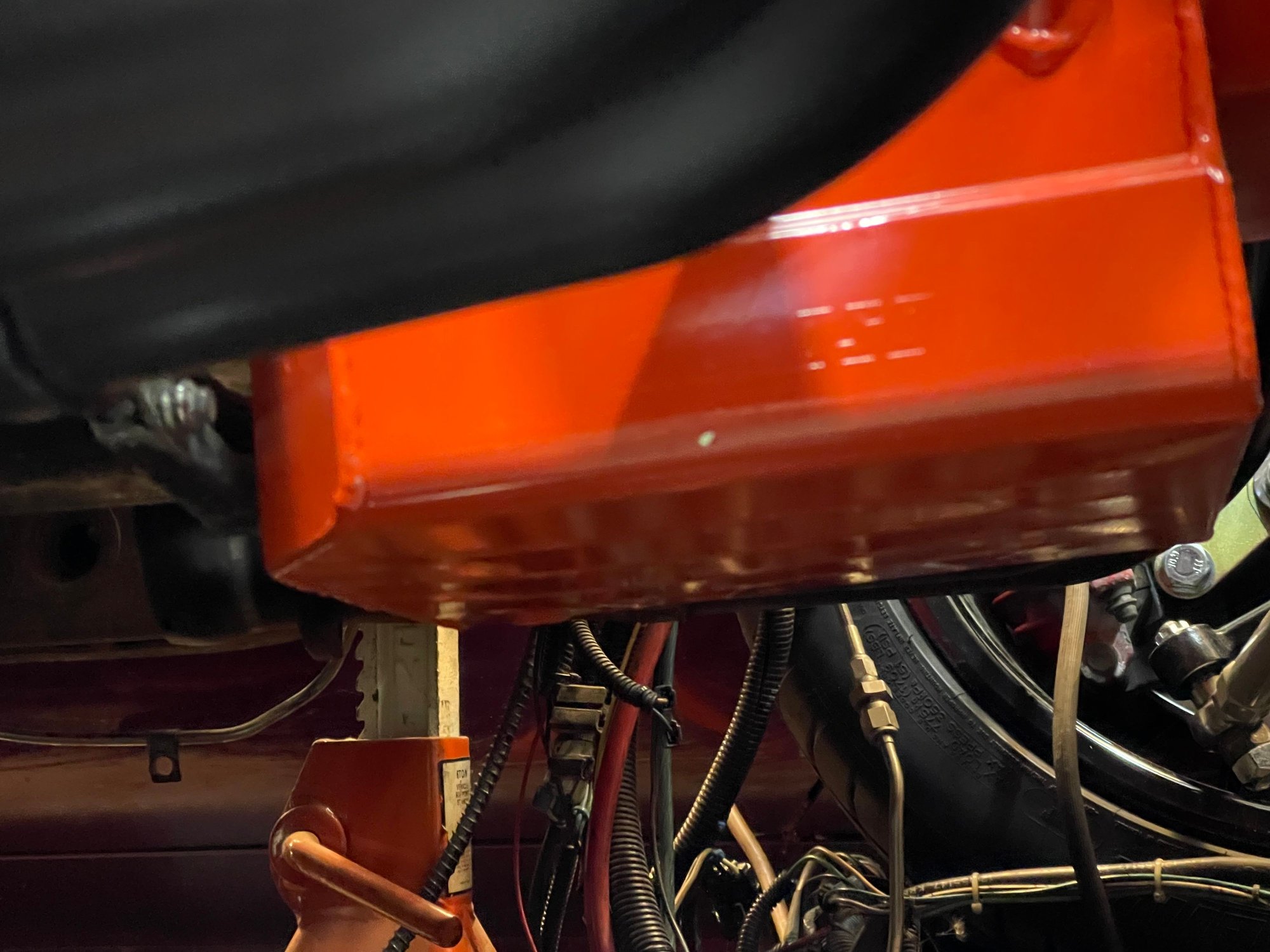

I don't want to go too far off on the OP's thread, but there are a couple of things to consider with the stock manifolds. The F.A.S.T. guys put a bucket full of money into the manifolds and they still restrict the power. They are 2.5" outlets also. I have a hand ported set on my C10 with a 496 in it. They are nice and quiet as a plus. I have the parts to do a custom set of headers for my 95, but I would like to keep it simple. I purchased a set of C3 Big Block 2" primary (#68090) hookers and have heard they require modifying one tube or notching the frame. I think I am about four weeks away from doing a fit up. The plan would be to cut off the collectors and weld on something a little more performance oriented such as a 2" to 3.5" collector and extend the collector 18" or so. That is all dependent on what fits.
so the Big Block has an 8" deep pan vs the SB 7.5" pan. In the name of keeping it simple there is no plan to try and go with a shallower pan. I have one picture I will share here that shows the pan to header fit-up. the heads have raised ports (0.600") but it looks like there will be no hang down on stock ports. I will try to update my thread as I progress through the fit-up process. this is the thread:
