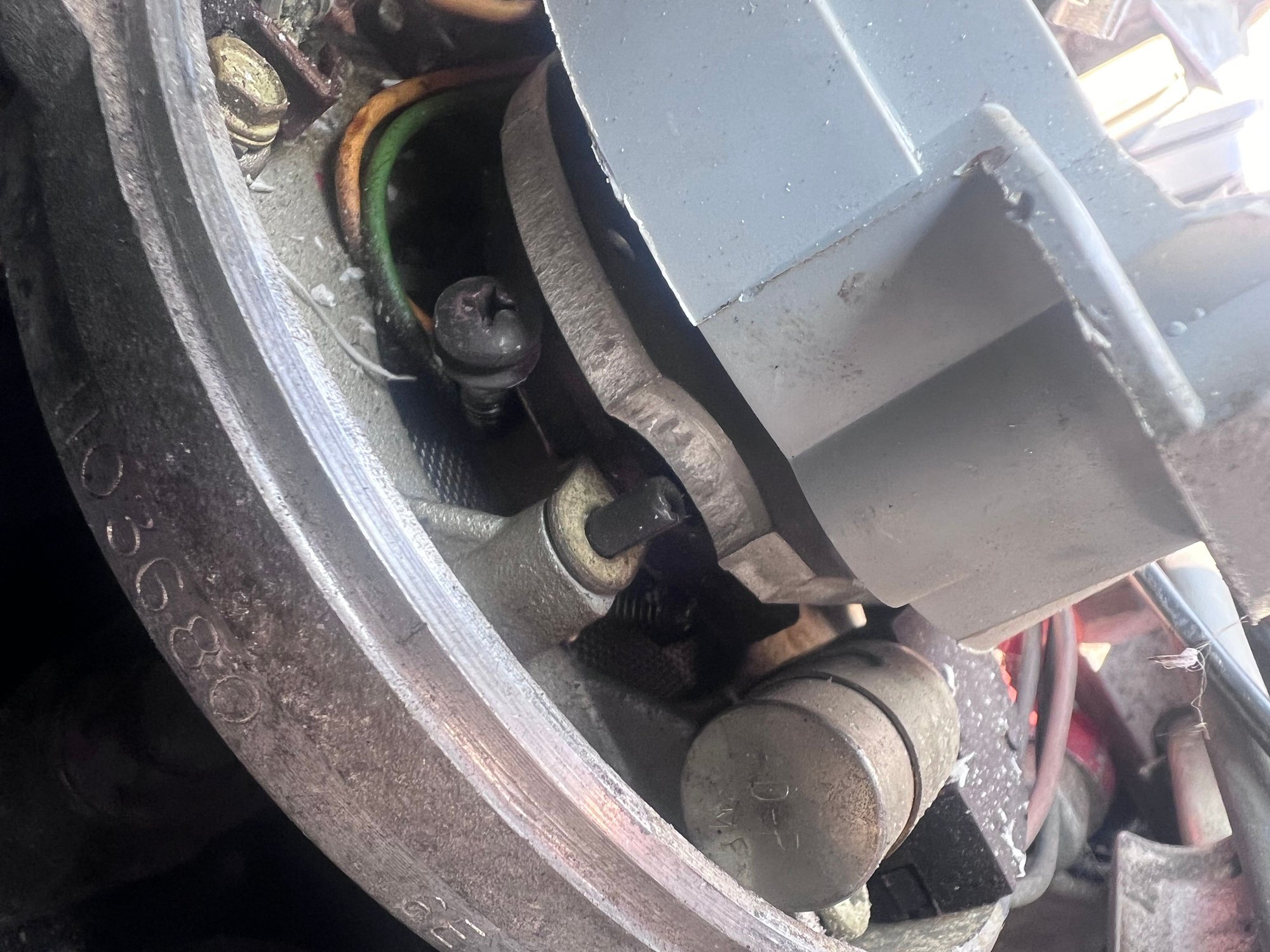

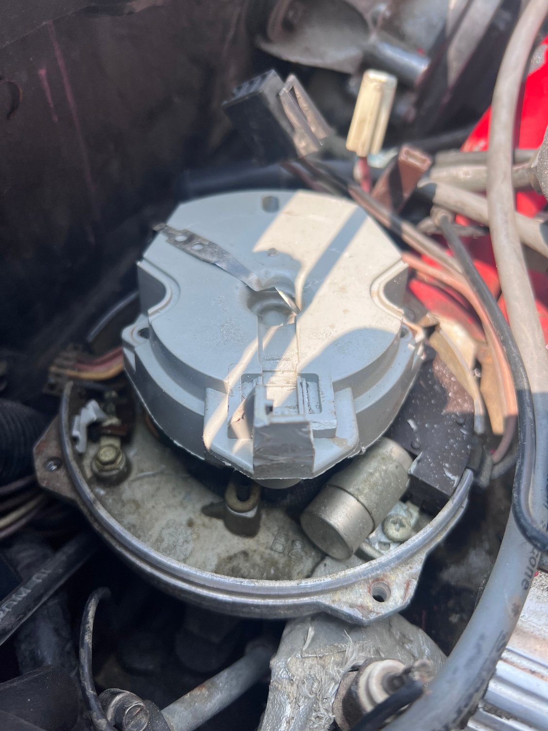

Well, I had a really good find today.
In preparation for getting to TDC and checking against the rotor position, I pulled off the distributor cover. To my surprise, the cap screws were not in. The metal contractor piece had bent and was probably 60 degrees off. I guess it was still spinning enough to make a weak spark on my light. Unfortunately that piece is too mangled and the cap broken. Maybe Autozone has those on the shelf because I would love to crank it with those in position and see what happens!

Is that one threaded bore for cap retention maybe have a twisted off fastener there? It's a difficult view but maybe? Screws generally are serviced with a correct cap I believe. A correct cap might be a difficult 'walk-in' buy at a local. NAPA maybe and if not on the shelf it would be a same day (depending when you place the order), or a next day with no shipping involved.
A GM# 1977046 (cap), GM# 10498150 (rotor) should easily be used for reference at any 'local'.

Well that will keep it from running, so get the cap and rotor
And I can't believe it, a rotor isn't Monkey proof that's a first.

Well, she started right up with a new rotor and cap! But now I have this fun noise... I am hoping it is just a misfire. Would that throw a code? I only have a code 34 after this start up (MAF). I had trouble plugging in a passenger side spark plug wire, maybe it didn't seat all the way. Or maybe a lifter from sitting that will smooth out? If it is a knock I am going to be so sad. It sounds more top end though.
