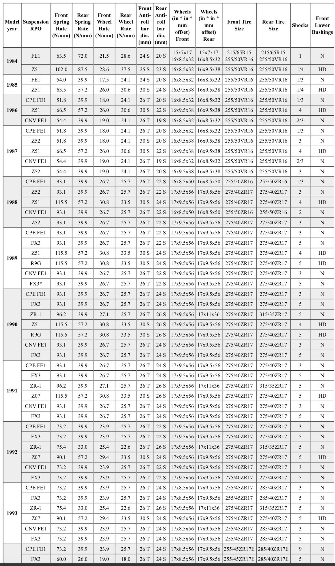

As was mentioned earlier, just measure the diameter of the rotors; 12” standard brakes, 13” heavy duty brakes (J55).
In 1989 one had to order the Z51 performance package to be able to order the FX3 adjustable shocks. The FX3 could not be ordered without the Z51 package. Unfortunately GM in their infinite wisdom switched the Z51 springs & swaybars to a less strong springs & smaller bars. Only the Corvette Challenge race cars were equipped with true Z51 springs bars & FX3 adjustable shocks.
