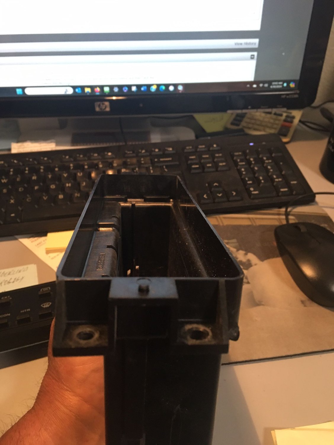

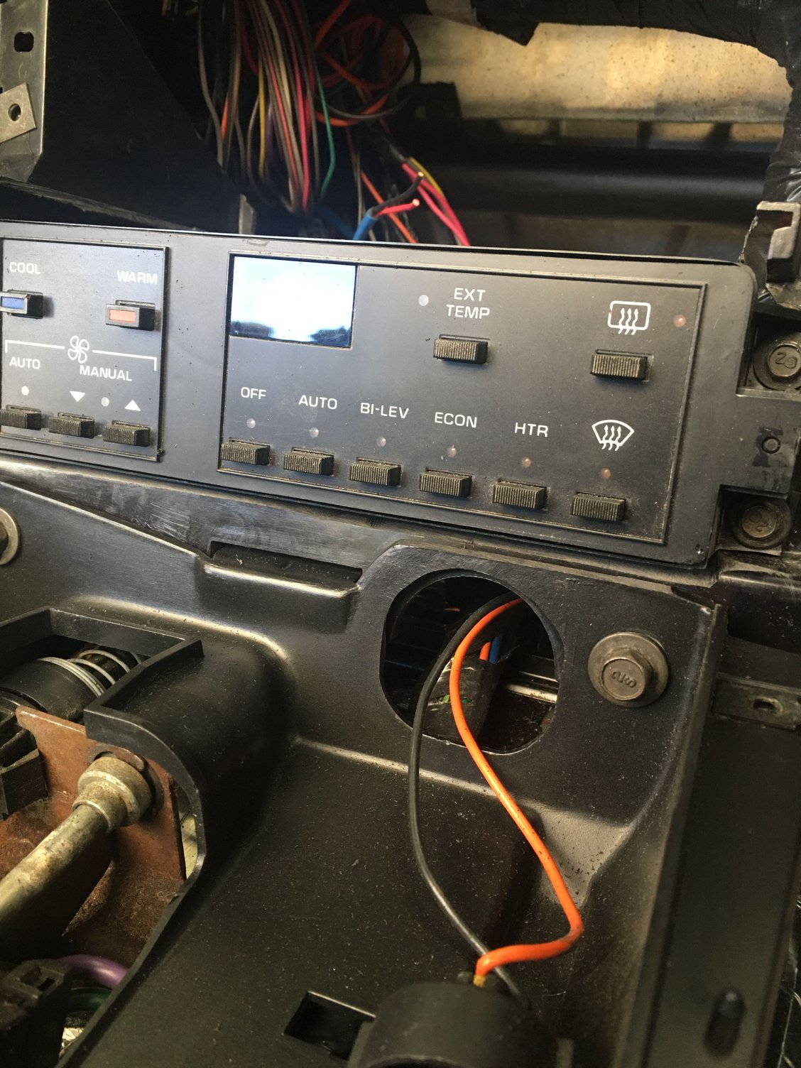

This is the AC panel removed and gutted. There's a clip on each end of the panel that can be removed to dismantle the control panel from the housing. You can see the thickness of the long edges of the housing.

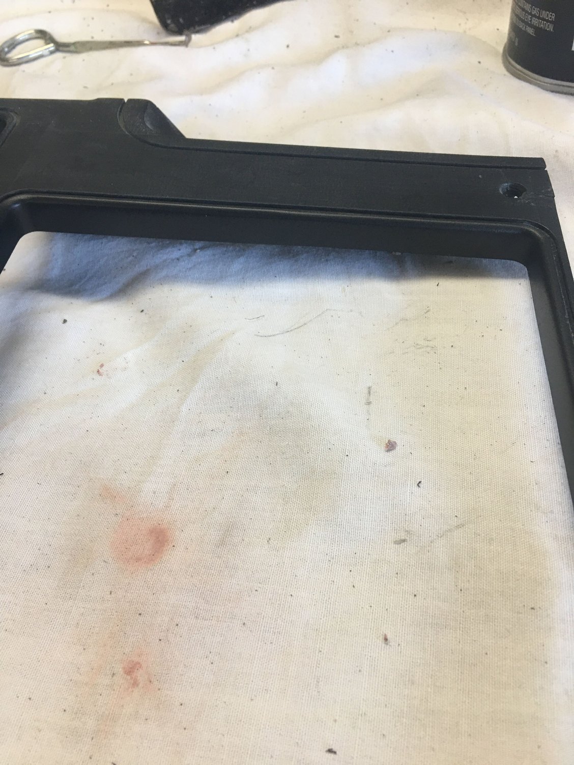

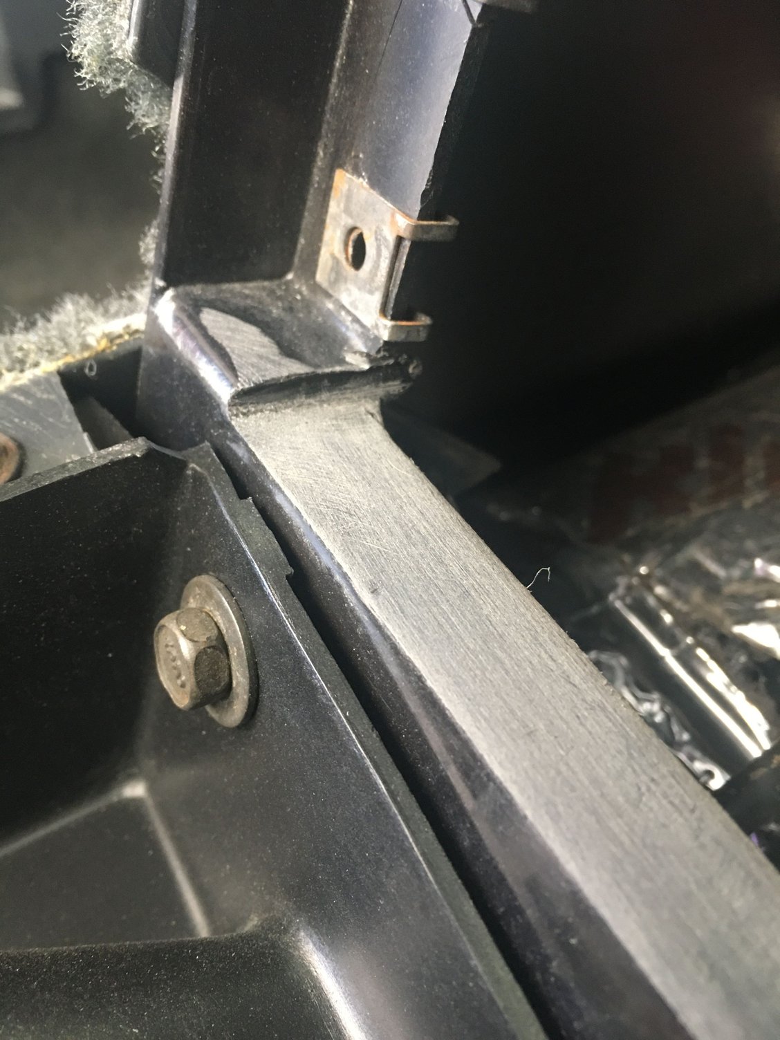

I sanded the top of the flange on the AC control panel, if there's one on the lower side...sand that down too so it's flat to the housing. I'm trying to reduce the height here even though it's not much.
This is after I sanded the top and bottom of the AC housing using the control panel inserted into the housing to sand down onto the housing to get it thin and not sand through the housing. I might of gained an 1/8" of additional height.

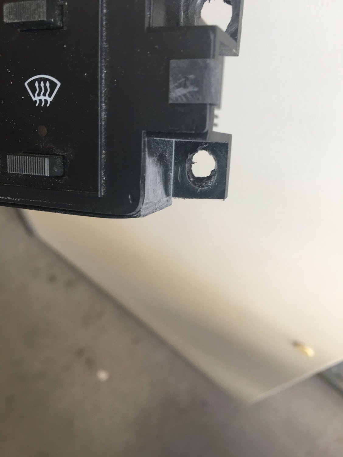

This is what the control panel and housing looks like after sanding.

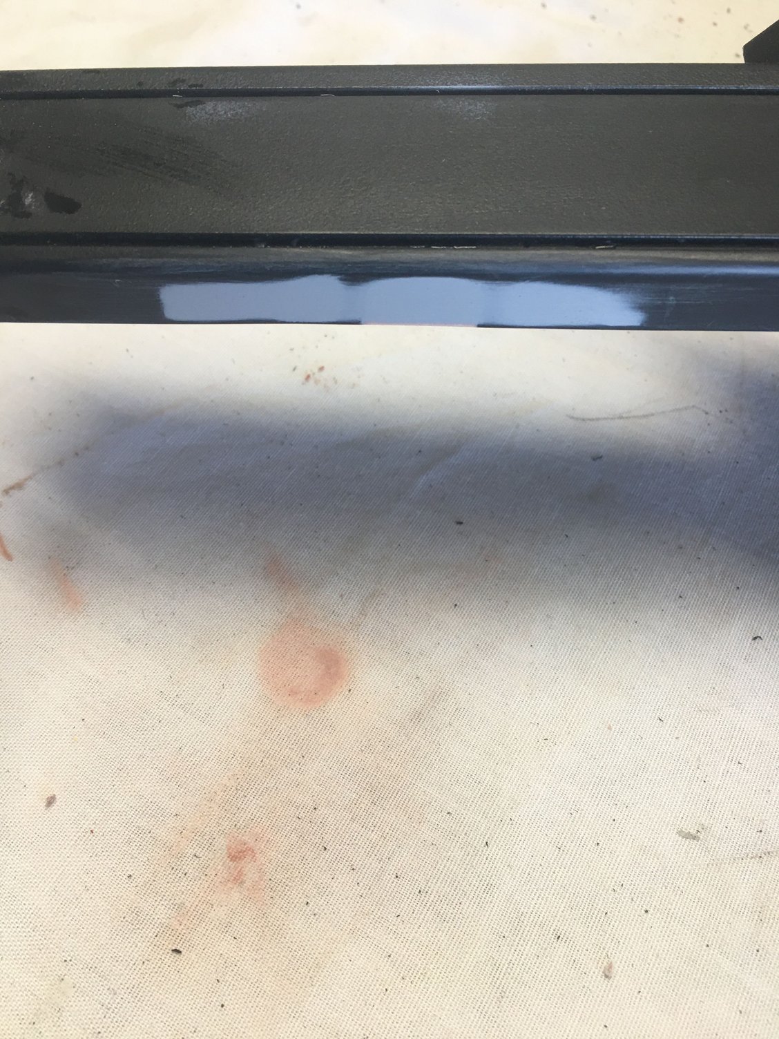

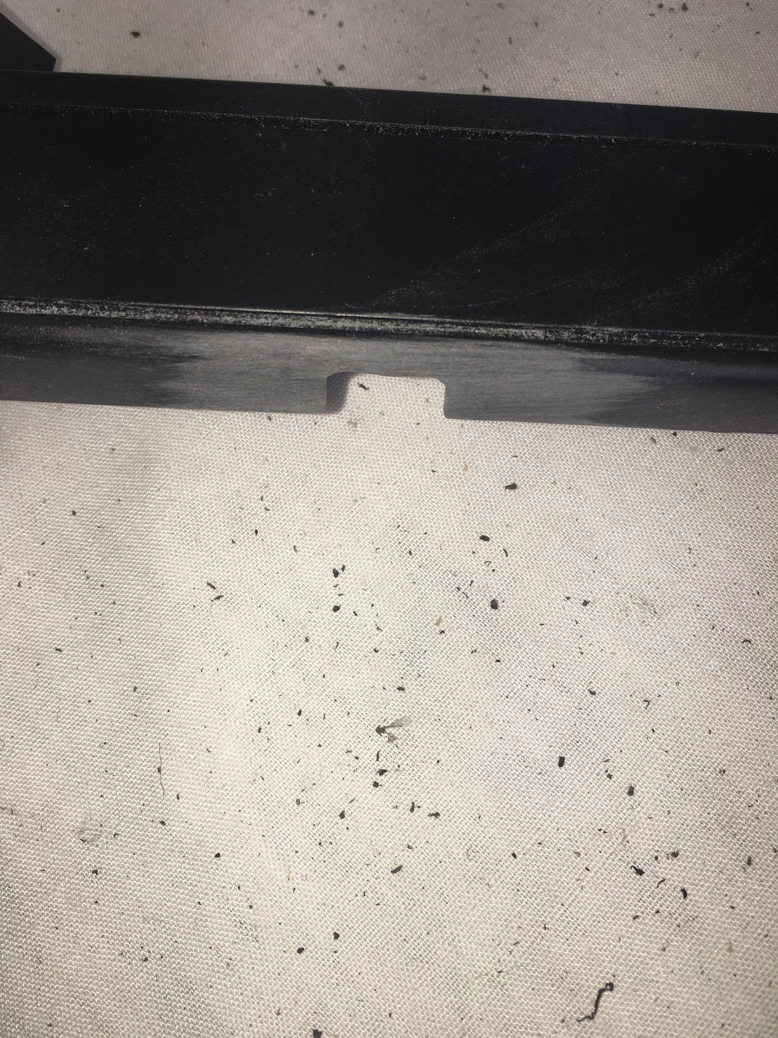

The bottom bar of the dash is very thick. I notched out a relief in it so the AC panel could sit lower.

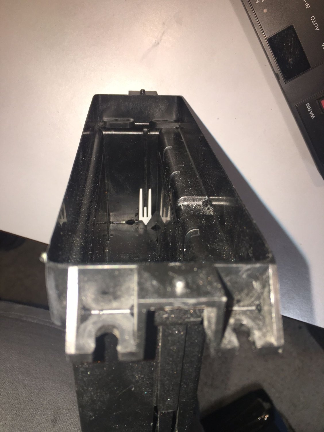

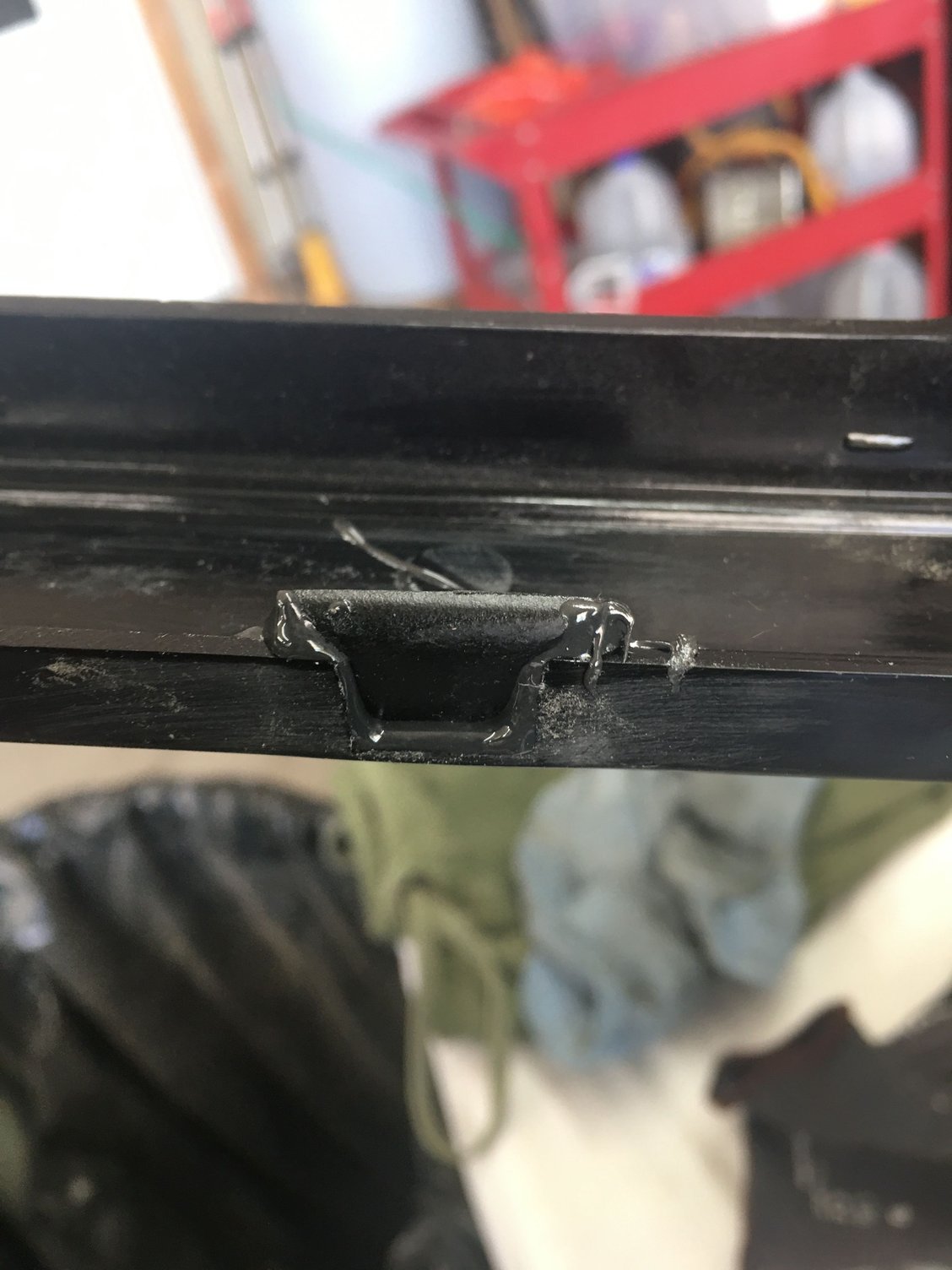

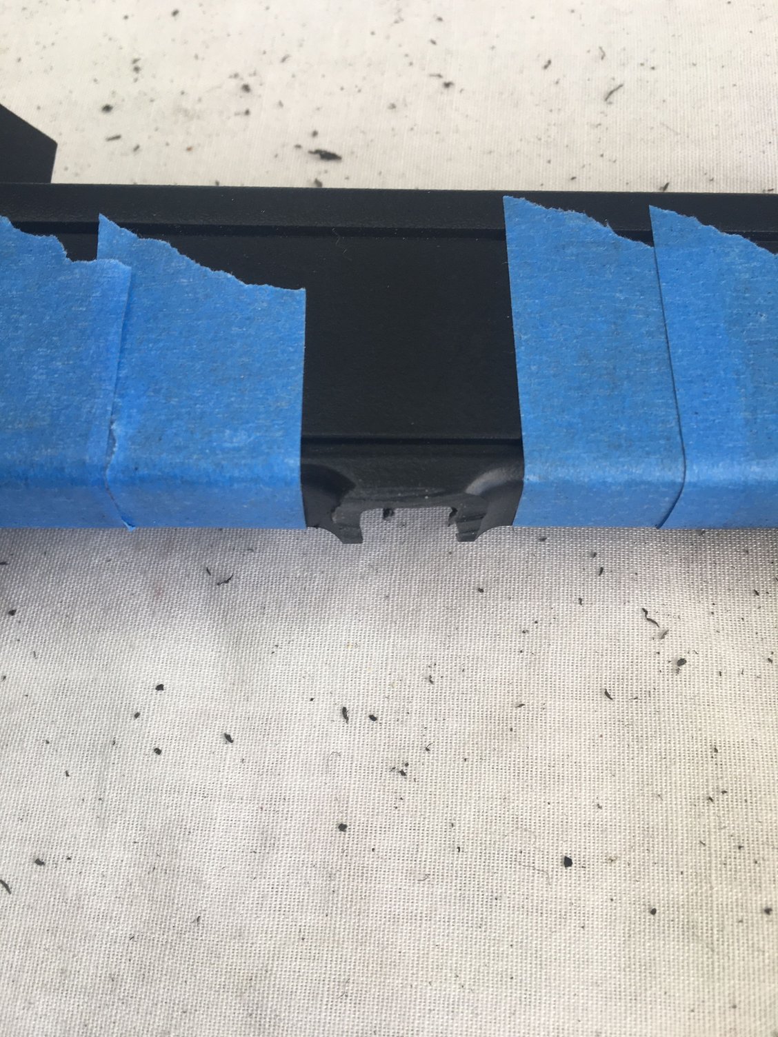

I modified the AC panel lower mounting flange by cutting and notching it so it would fit into the notch I made in the previous pic. Slot any of the mounting holes to get it to sit as low as possible. Same thing where the J nuts are mounted. Every millimeter helps here.
You can see how much lower the AC panel sits in the dash after the mods. For the radio opening the rear plastic bar needs to be removed and the sides widened to allow the double din to sit on top of the AC panel and as flush to the front of the AC panel as possible. I cut and notched the lower AC panel mounting tabs a little more to sit lower after taking this pic since there was still a small gap below the AC panel.

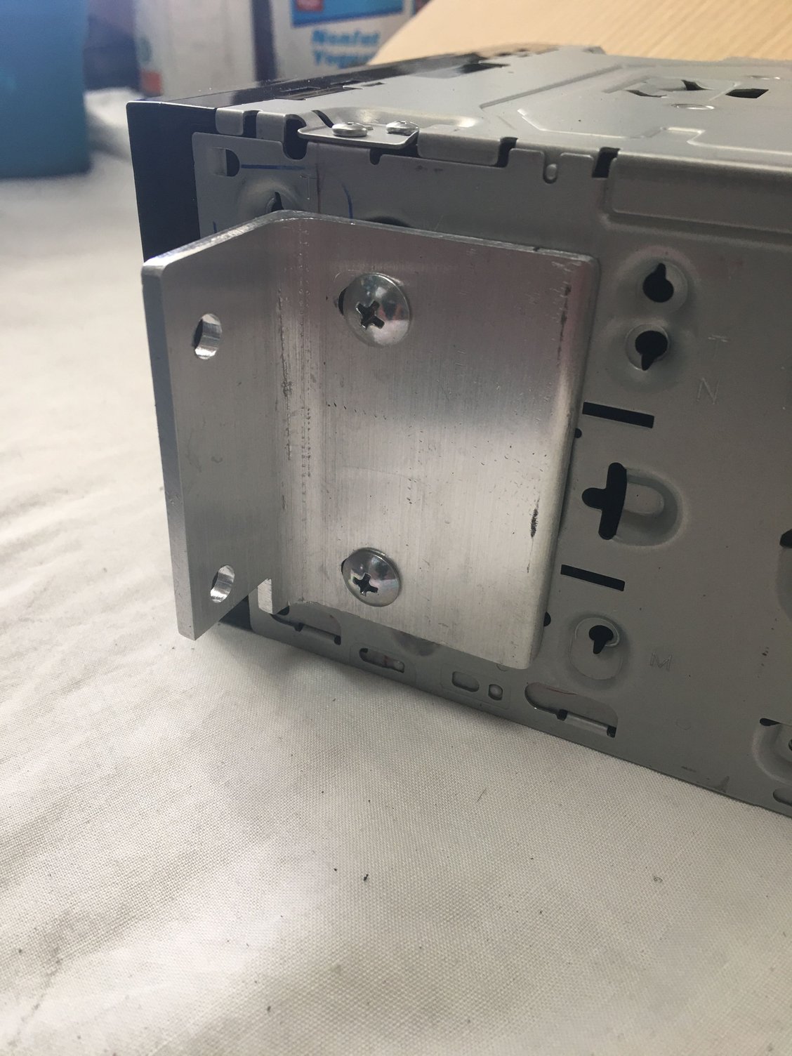

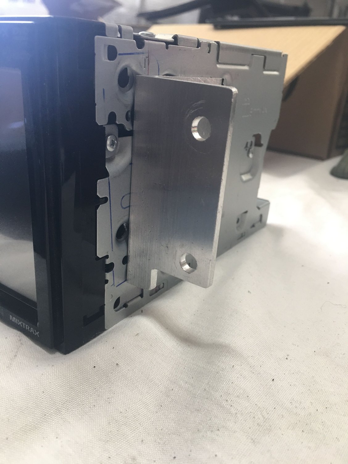

I made some custom aluminum brackets from 2" aluminum angle. Front view.
Rear view. Holes are slightly slotted for any angle adjustments in the opening. The radio sits directly on top of the AC panel and the holes line up with existing holes which may need to be modified with a J nut.

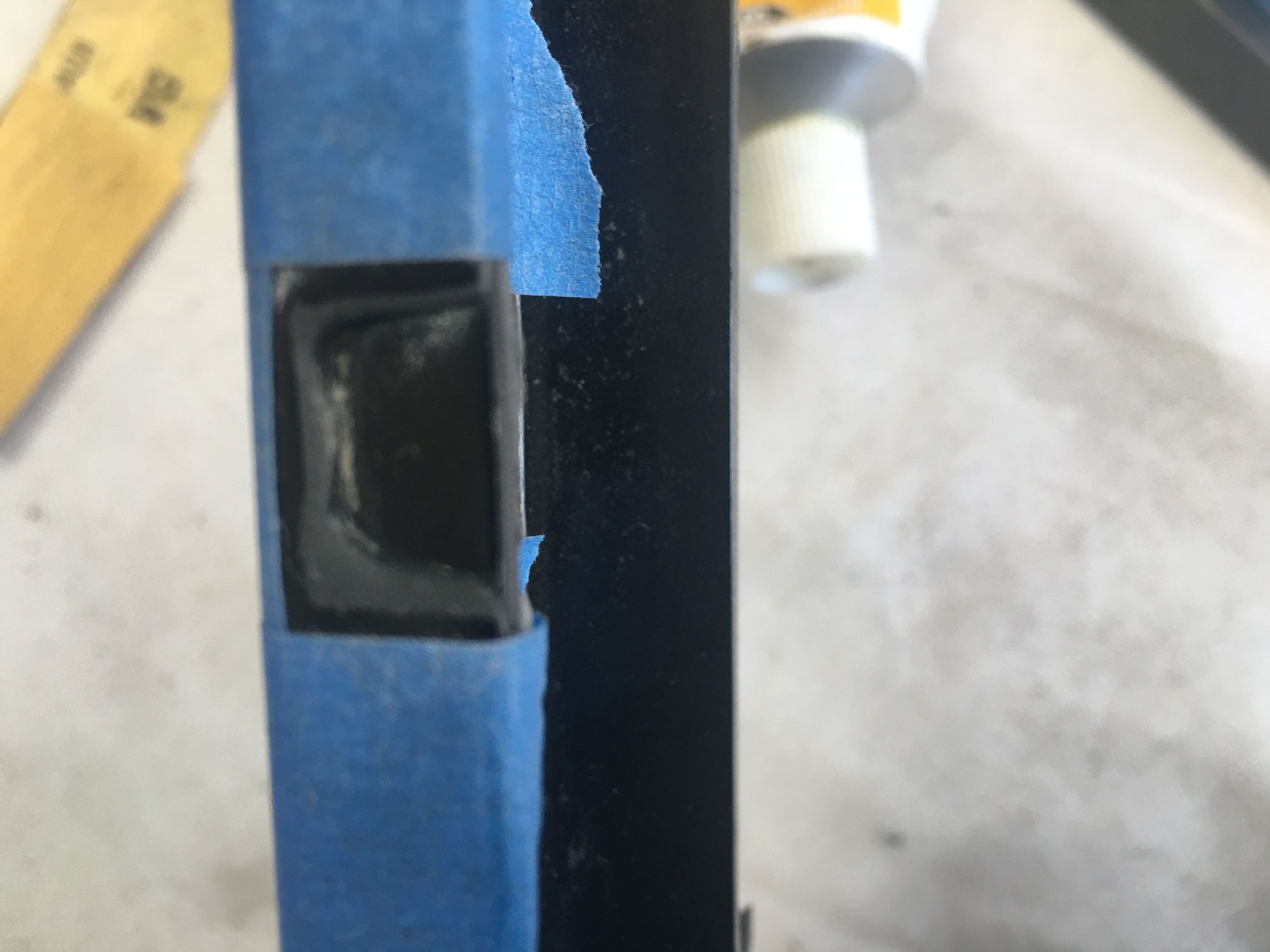

I cut the cross bar out of the radio bezel and placed masking tape repeatedly while I sanded the nub of plastic flush with the bezel.
Nub sanded down flush with the bezel
I used a piece of the old cross bar and epoxied a piece as backup to fill the hole.
Completed sanding the edges flush with the bezel.
Used some two part bondo to fill the hole and blend into the bezel.
After priming and using SEM plastic paint. Hard to tell it was modified.

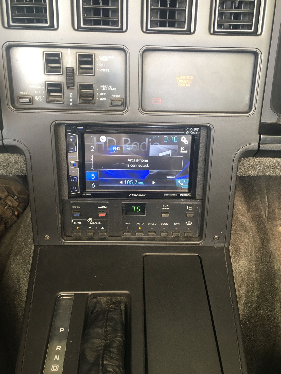

Here's the radio and AC panel installed. The AC panel lower control buttons are still accessible albeit a little lower in the opening.
If you have a double din trim piece then use it and trim to fit. I had some textured plastic that I just cut and used a glue gun to adhere the sides to the radio itself. The glue won't damage the plastic.
This is what it looks like completed. The CD slot and eject button are fully accessible. If you don't have a CD then some mods mentioned probably won't be needed. Obviously, you'll need wiring adapters to interface with the existing radio connectors. The previous owner cut out the connectors so I just hardwired the radio in.
