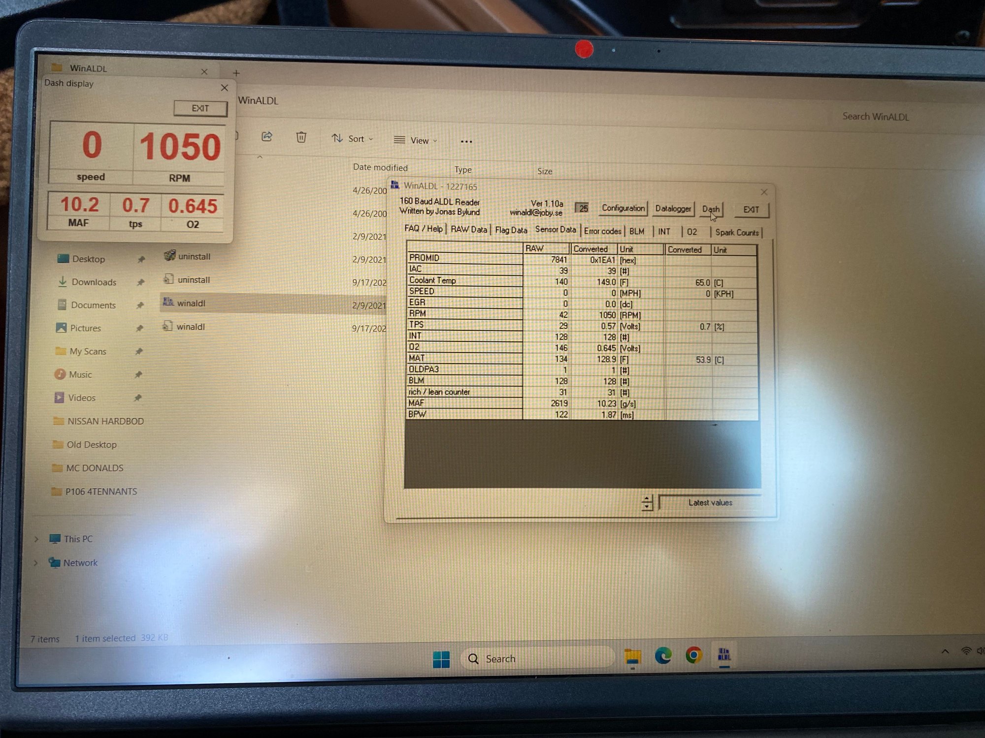

Trying to install this awful convoluted program to get my data cable to work with my laptop. I’ve wasted an hour trying to get this to work. You would think for $60 this would be a little easier to figure out, but when it’s asking you to copy and paste stuff, that bothers me. Anyways maybe by the end of the month I will have this figured out

DataCat is a viable alternative for those that struggle with TunerPro as it is a bit more user friendly, but is not as flexible.

Thank you. Though I finally figured it out. Though by time I was able to get it to work the engine was warmed up a bit, so the cold start issue couldn’t be replicated. Anyways what is weird is that the engine is idling high, around 1000rpm, not sure why this is happening. I replaced the distributor a few weeks ago, and the timing is set a bit higher at 8 degrees, but it was idling around 750-800 until I plugged in the data cable ?

Its idling at 1,000 rpm because that is what happens when running in ALDL mode at 160 baud, the timing is advanced by 8 degrees as well. This is not the mode you want to be in, but is a necessary step for transitioning to 8192 baud.
I see that you're running ABTP based upon the 7841 prom id. MK2 4+3
I guess I need to learn some things, because what you’re saying is blowing my mind lol. Should I set the timing back to 6 degrees? What is 160 baud and what is transitioning to 8192 mean ? Any info would be so much appreciated.

ABTP is the broadcast code (bcc) of the stock bin that has the prom id of 7841, so most likely it is a stock ABTP bin. So far so good. Leave the timing alone (for now).
At least you have a connection and you are reading data at 160 baud. This is an important first step, but you will want to use a scan tool that will put the ecm into 8192 baud such as TunerPro, DataCat, DataMaster, EFILive V4, etc.

Correct. The data that you are seeing now in WinALDL is the 25 byte ALDL datastream at 160 baud. It is only 25 bytes of data at a very slow sample rate. About 1 sample per 1.25 seconds or so. The ecm operates on a 6.25 ms loop time with some functions running at 12.5 ms, so a sample time greater than 1 second is an eternity, and you miss about 200 times more data than you capture.
8192 baud data is 63 bytes of data at a sample rate approaching 10 samples per second (hardware and software dependent). This data is much more useful.
