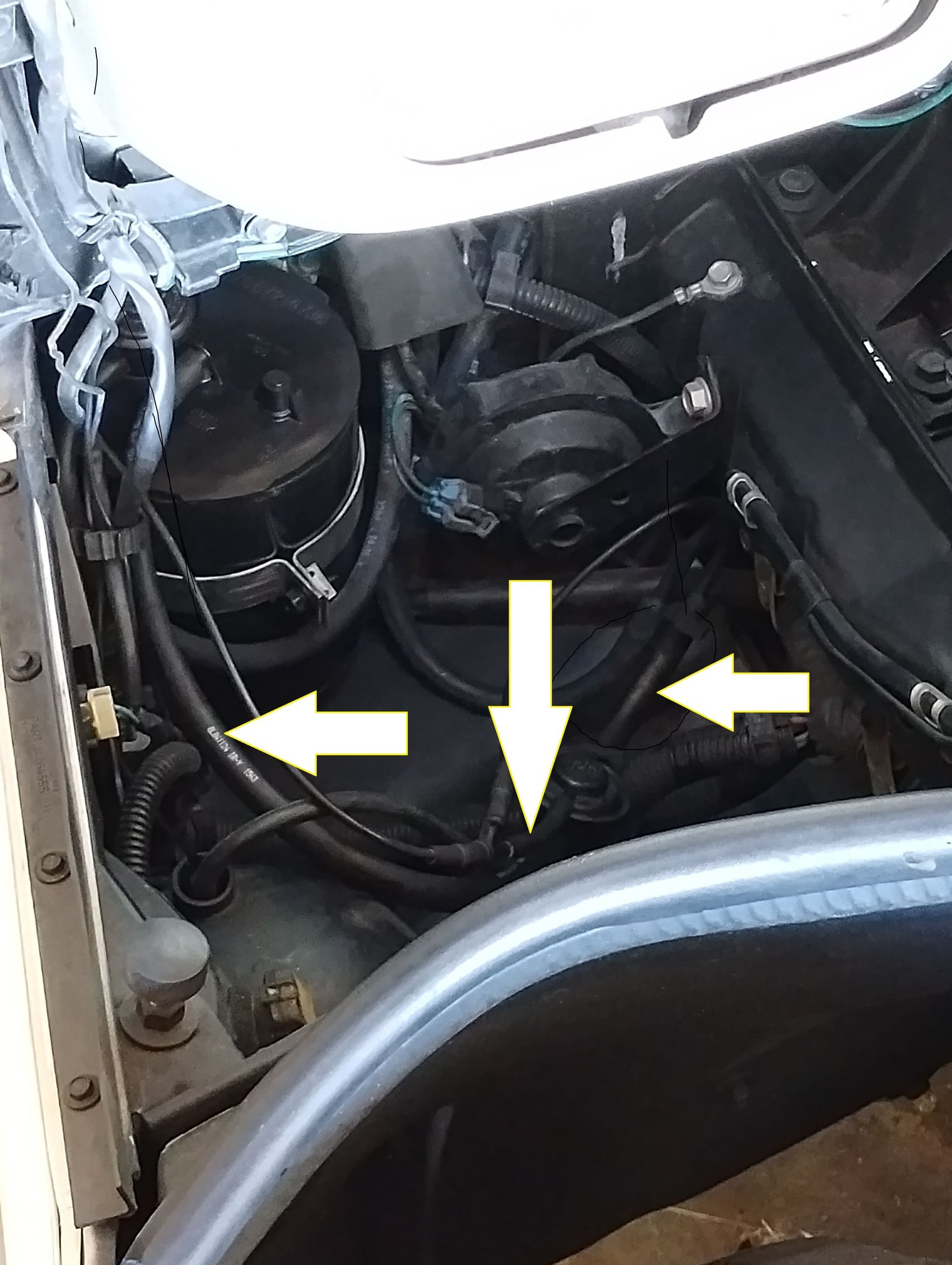

It turned out to be the 4 inch or so rubber hose connecting the Purge Valve into a Plastic hose that runs into the engine. See uploaded photo (The rightmost arrow shows the main cuprite)
Warning: Use Extreme Caution when removing and reinstalling the two weird hose clamps as you want to lock the clamps just enough to secure the connection with the adjoining Plastic Hose. (You could easily break the plastic hose and who how expensive that will be),
I used a screwdriver to gently pri them open and reuse. Although you could try using a regular hose clamp
In addition, I changed one hose from the EVAP Canister (5/16) and the (1/4) hose section into the purge valve. See Leftmost and Center Arrows.
I'm glad I gave this another look before I took it to a shop for a smoke test. Who knows where that would have landed.
Again, Thanks for pointing me in the right direction as it finally passed!
