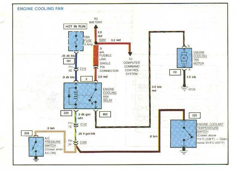

The cooling fan wiring on the 1984 Corvette is about as simple as it gets.
Relay should have constant power from a fusable link.
Relay is controlled on the ground side og the coil and will engage from high engine temp or air conditioning.
Ignition must be on to feel the other side of the relay coil.
If the relay is sometimed on with the key off, then it could be a bad relay or some problem with the ignition signal.

Yeah, I use that diagram when setting up a car for an electric fan that didn't have it originally.

I noticed the red wire also goes to the computer. Folks have been telling me the 84 doesn't use the computer for the fans? Are the wrong? Thanks

It branches off of the battery to the computer and fan relay, the control side is on the rely side that gets grounded. That green wire w/ the white stripe could be grounded with a jumper wire to ground and the fan should run.
