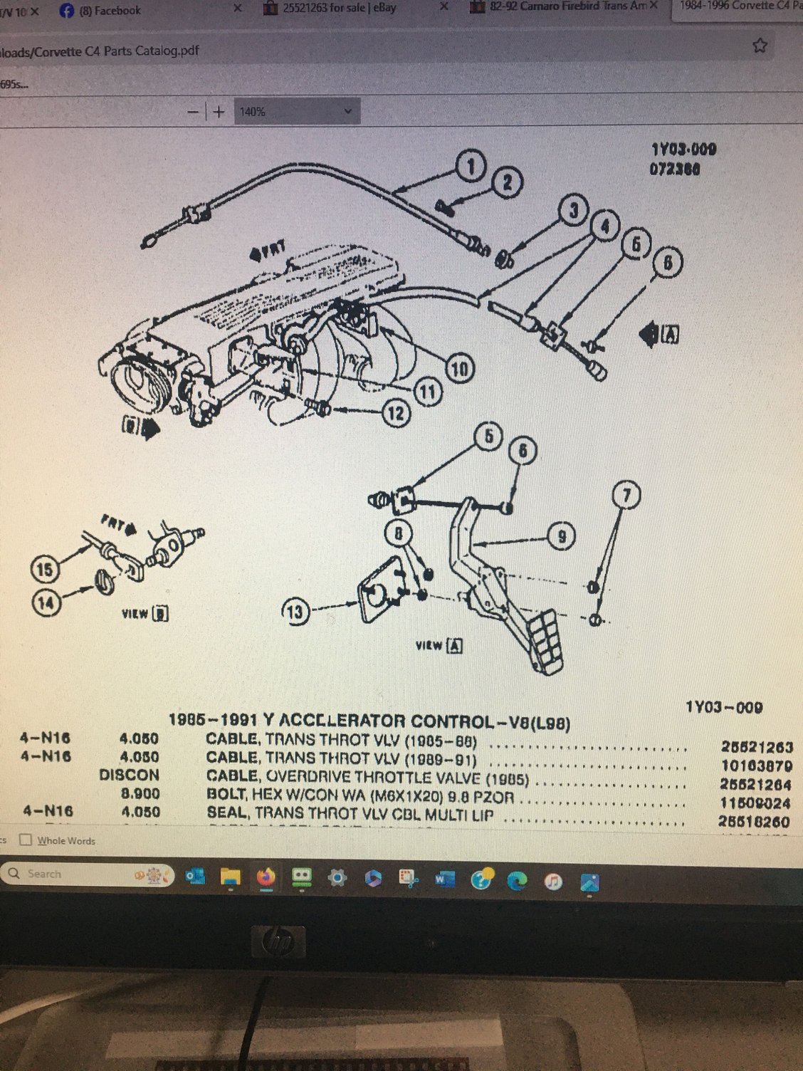

I guess I was just too lazy to do in depth research and was hoping for an answer from the Forum. I don't think these things go bad very often so maybe not too much info on replacement. Anyway, I downloaded an 1987 Corvette GM parts manual that revealed the part number is 25521263 for 85-88. I see them on Ebay as the Y-363 which seems more universal, Ebay's 25521263 as damaged, Corvette Central's 534241 part number looks universal. I looked up the same part in my 82-91 Camaro parts and illustration manual for an L98 T/V cable and it's the same part number 25521263 for an 87-88. So I guess that's what I'm going to be looking for if I want OEM. My old one measured about 45" from the plenum bracket flange mounting surface to the TV transmission mounting surface. I've been seeing some that are 61" but not sure what they're measuring, maybe the stranded cable ends.

I bought a Y-363 from Summit. The length of the cable externally is about spot on. It's just the stranded wire cable that's longer and adjustable. I'll give it a try, might be able to bench measure my old stranded cable and adjust the new one to the same length to start.
