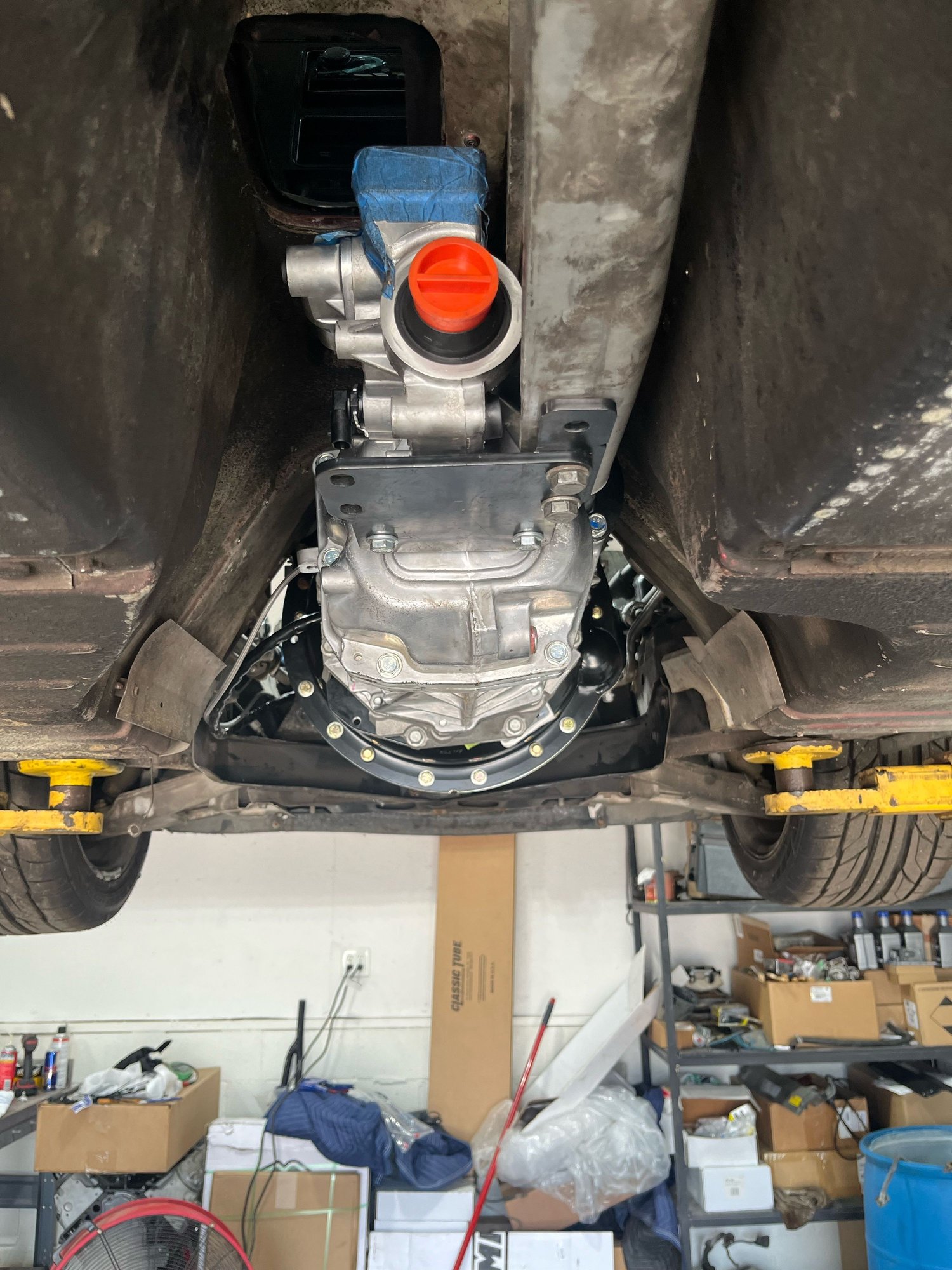

i believe the sfi bell / scatter shield isn't enforced until 10.99 or quicker. 99/100 times the only thing that will cause a flywheel to blow up is improper installation. the other 1 is a genuine parts failure.
oof 14.2 @ 100 is what my 2023 subaru brz (na 2.4L 4 cyl) did on the street over the summer. you have a lot to gain, id say at least 2 seconds worth of ET and 15 mph.
sfi bells will easily fit in these cars, i have one in mine with a scatter shield.
