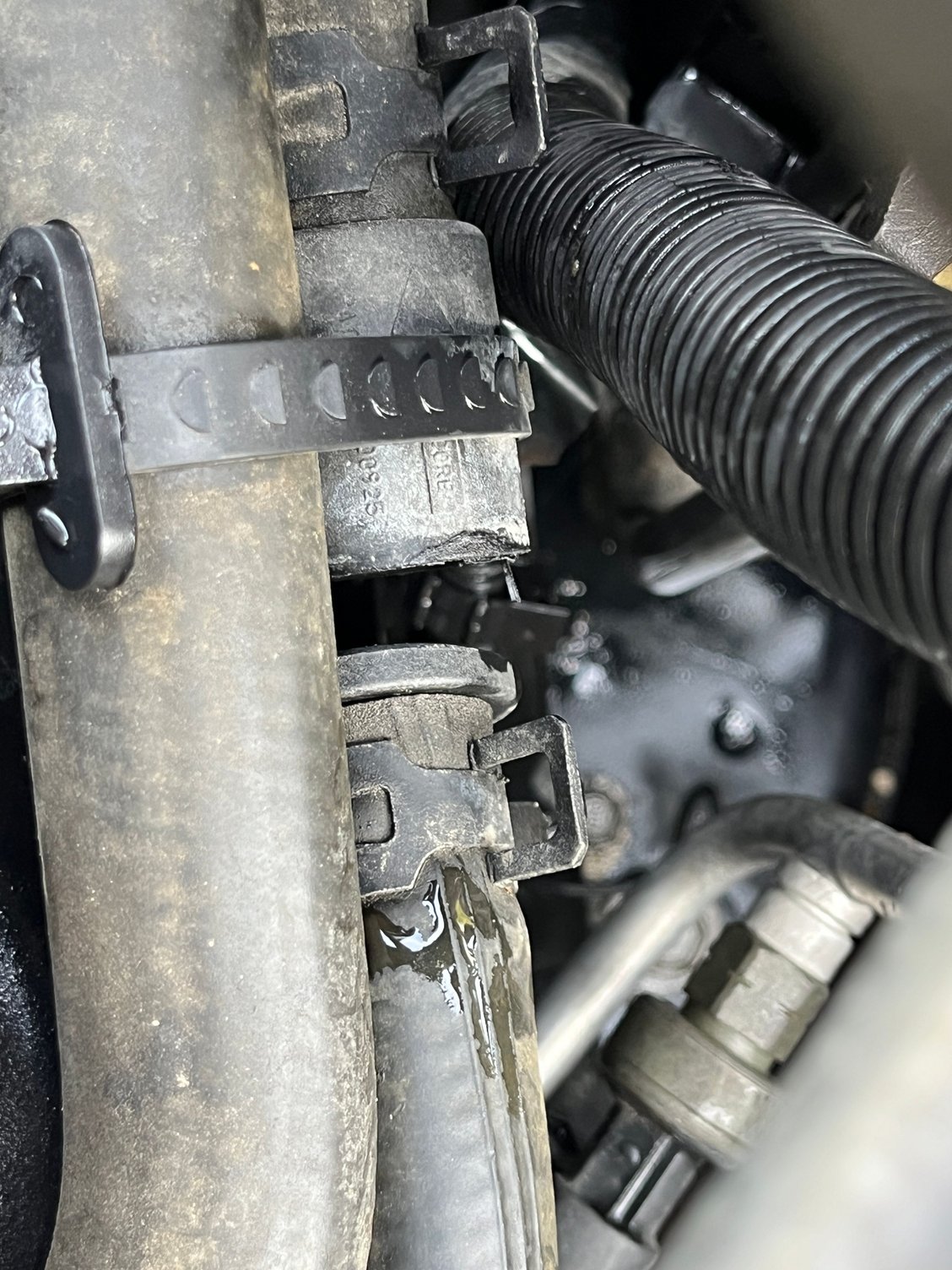

The Primary fan came on at 228F. Once the fan kicked on, I started seeing my coolant temperatures bouncing back and forth for a little bit but the temps still slowly climbed to 238F and then the secondary kicked on. Even with both fans spinning, it still crept up to 244F. I got my food from the window, started driving away and then I decided to turn on my heater to help drop the temperatures a little bit. I set it to the highest temperature possible (I have the auto climate system) which is 90F and I started feeling the heat come through the vents. After about 5 seconds, I noticed steam coming through the passenger side of the hood. I immediately knew something happened with the cooling system.
Thankfully, my house is only 2 streets away from the fast food place so I limped it home and shut it off immediately. I found that it was the heater core hose that has the one-way valve (please correct me if I'm wrong). Seems like it was under immense pressure and it exploded. I already ordered a replacement from Corvette Central, and I also ordered new radiator hoses while I was at it, as they were pretty squishy.

Everything has been working as expected. The new hoses have been holding well. I think I have found out why my C4 has cooling issues. The previous owner replaced the stock radiator with an aftermarket one. However, the aftermarket fans that came with the radiator are absolutely junk. They barely cover any surface area and there was no shroud around it either. I'm going to save my money up for a Dewitt single + fans.
It explains why the C4 did fine on the highway but not in idle/slower speed situations. The fans were barely doing anything, which is why the coolant temps wouldn't drop below 238 even with both fans on. Thanks everyone.
