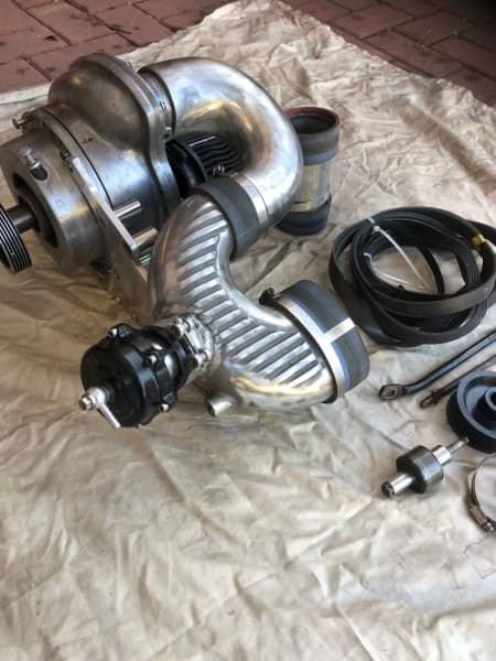

Then,
I accidentally stumbled across a cheap Paxton kit for $2k, only 1500 miles away in Perth, Western Australia.......

And THAT is how a suspect cold start injector turned to me "accidentally" supercharging my C4 Vette.
