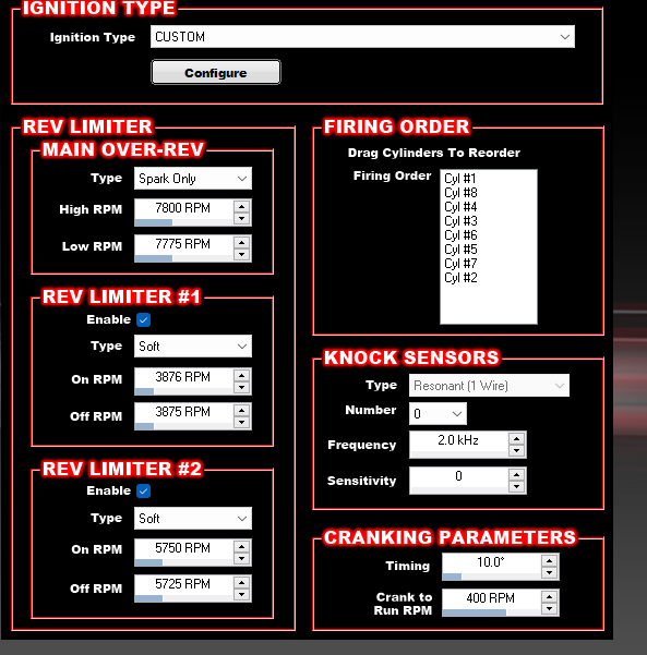

Well I won't have a lot of time to tinker with the car this weekend. I need to get power out to a carport on my property before winter. But I did have time to plug the laptop in and make some quick changes to timing and then see what happened. I noticed that the default Holley cranking spark timing was <400 rpm = 15 degrees. So no matter what I had in my timing table the crank timing will only be 15 degrees if the rpm is 400 or less. Well according to my data logs anyway during cranking it's showing an rpm of 400 to 500. 500 rpm is where the timing table starts. I had 26 degrees at this point to help keep a stalling engine running. So I made two changes. I removed my added "wall" of low rpm timing (pulled 6 degrees), and I raised the cranking timing rpm to 500 instead of 400.
So I started the engine and let her run until the fan kicked on. Then I shut it down and sat for just a minuet. Then started it back up. It fired up with MUCH less hesitation than before. The starter still sounds just ever so slightly slower than when cold. But unless you were that familiar with the car you wouldn't notice. I'm going to pull a couple more degrees of timing in the 500 to 600 rpm range and see how it goes. But so far I'm thinking this was the issue. I'm still going to install some kind of heat shield for the starter. It just seems like a good idea.
Thanks guys for explaining the timing issue to me and for all the other ideas. I just couldn't wrap my head around how ignition timing could do this when hot vs cold.

I do 10 degrees while cranking.
