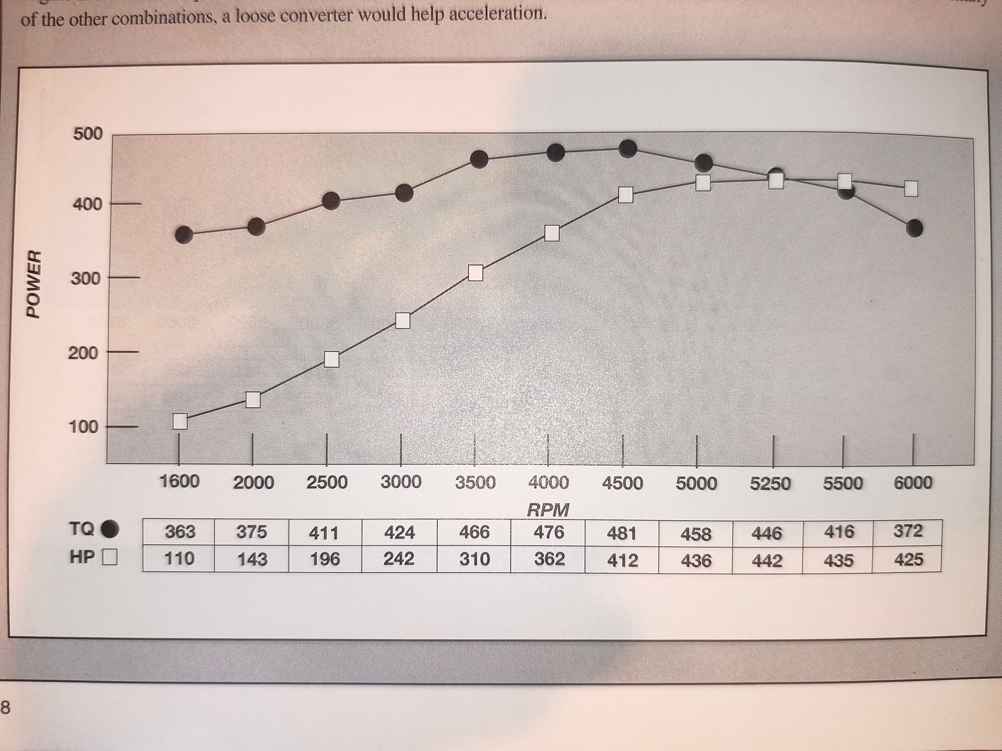

Here's a dyno chart from John Lingenfelter's Modifying Small Block Chevy Engines book. This engine has 9.2:1 compression, ported 113 heads and his LPE 219 cam which is a single pattern 219@0.050 and 0.525 lift 112LSA. Peak numbers were 442hp and 481 ftlb torque. Your engine has more compression, a little more cam and better heads. You should be above 450 HP and 500 ftlb torque at the crank. You'll need a free flowing exhaust and a good tune.
