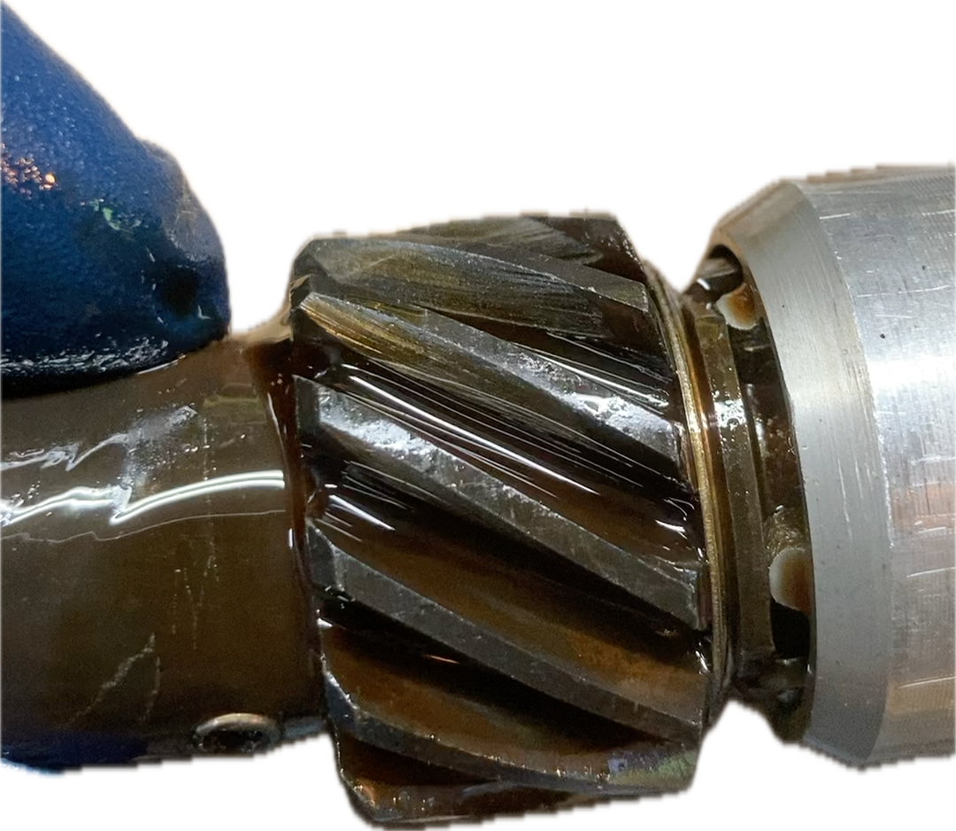

Hi, I have a 1990 Corvette with a stock L98 engine (125,000 miles) with a slightly sloppy idle that I have tried to make smoother. I had the heads off 5 years ago because of a leaking head gasket so I took the opportunity to freshen things up at that time. When looking at the timing with a strobe light, the indicated position seems to wander more than I would expect, maybe 3 degrees. I am thinking this may be the cause of my sloppy idle.
Worn?
More Gear Wear
Less Gear Wear
The refresh included: plugs, wires, cap/rotor, fuel pump, fuel filter, fuel pressure regulator, air filter, fuel injectors, valve job, cleaning of the throttle body, re-bushing the throttle body, and likely a few other things I forgot. The engine ran the same before and after my repairs, minus the coolant leak.
I am currently working on resurrecting dad's old 1952 MGTD and it has a badly worn distributor. The timing on that car is a mess, but the drive gear is fine. It got me thinking bout my Corvette and I remembered I had taken a video a few years back when I shimmed the end float to about 0.012". I didn't think this would help, but I wanted to inspect the internal gear and see if there was anything wrong. Looking back at my video from 2021 there is visible wear on the Vett's drive gear, but I don't know if this excessive, or normal for 125,000 miles.
I have attached a few videos to help with your evaluation. What do you think, is my gear worn out

That doesn't look terrible to me. In fact, it's about on par with how much play my rotor has. That said, it wouldn't hurt to put in a new gear.
But I also don't think the 3 deg of timing variation is the cause of your idle issue (my guess is you measured that with the EST connector disconnected?). When the EST is hooked up, the ECM itself can actually vary the timing up to 5 deg in either direction to help maintain the correct idle speed, and it does that without the driver even being aware of it.
What gives you the impression there's actually an issue vs this being normal for the car? Was it smoother before?
For the age of the car, one thing you might want to look into is the pick up coil under the rotor. I found it can have a profound effect on how the engine runs.
https://www.corvetteforum.com/forums...l-for-hei.html

The gear looks fine. If you are concerned, since you have the distributor out already, it takes only a couple minutes and a few dollars to pop out the roll pin and put a new gear in.

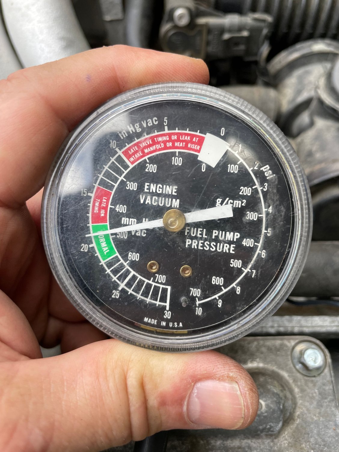

I'd probably expect about 19 inHg out of a stock engine I'm neutral at that rpm. It's kind of a proxy indicator for idle quality

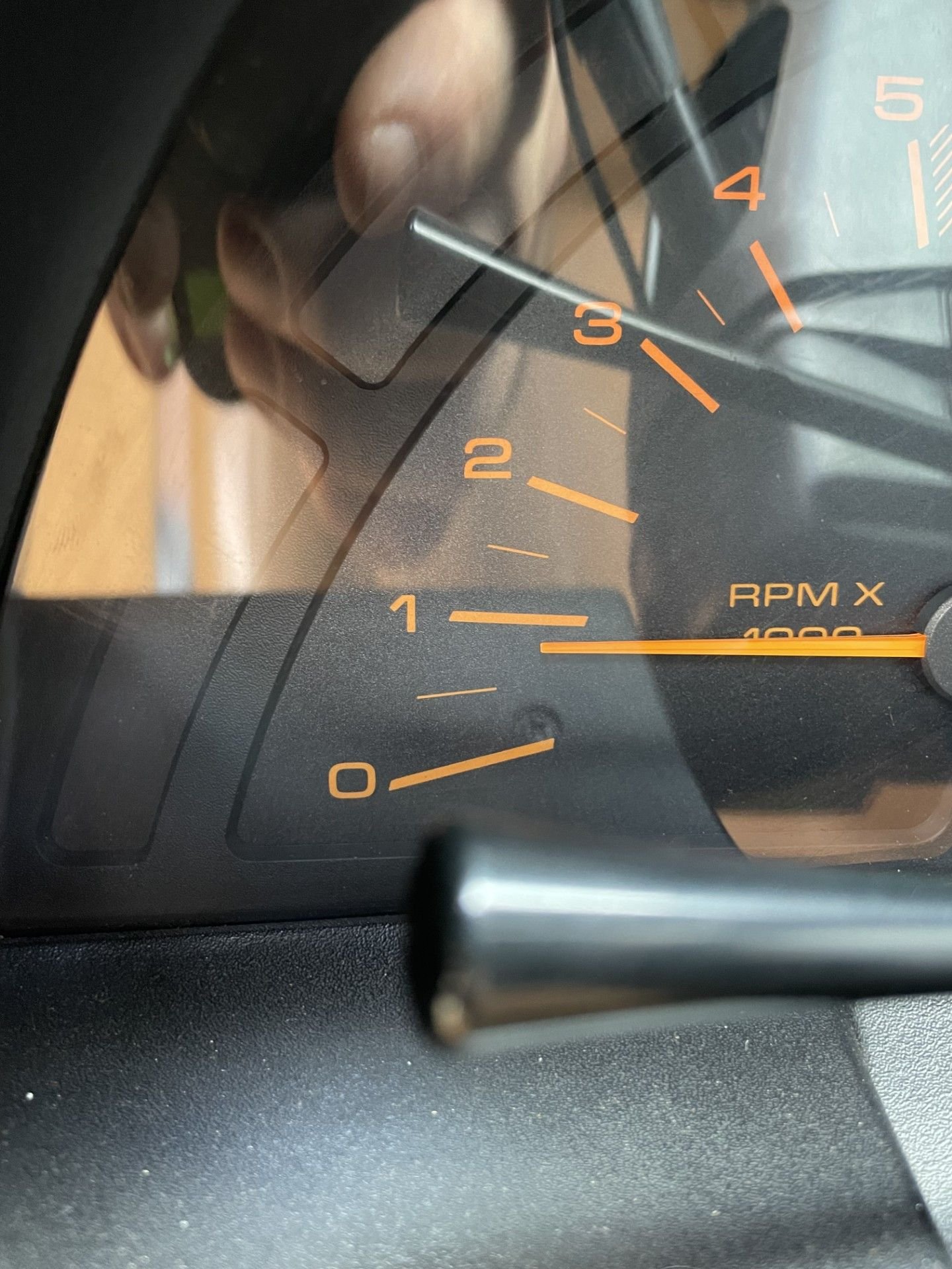

So, I just hooked up a vac gauge and I see around 19" at 900 rpm.
You can see/hear the sloppy idle in the movie.
-Tim in Mass

To be honest this all looks really normal to me for a car of that vintage. That vacuum reading is actually quite stable IMO. Barely fluctuating a 1/2" of Hg.
