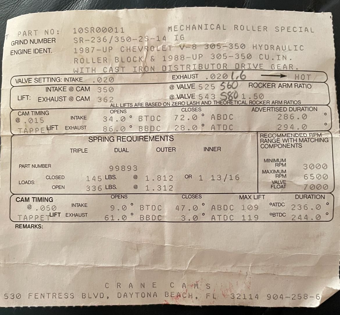

Ok thanks for the heads up. I bought this mechanical roller Crane cam 20-25 years ago, and it’s still brand new, with the intentions of using it in the future if I ever built a new engine/ or stroker. I’m assuming that it should work fine, right? Here is the cam info:
