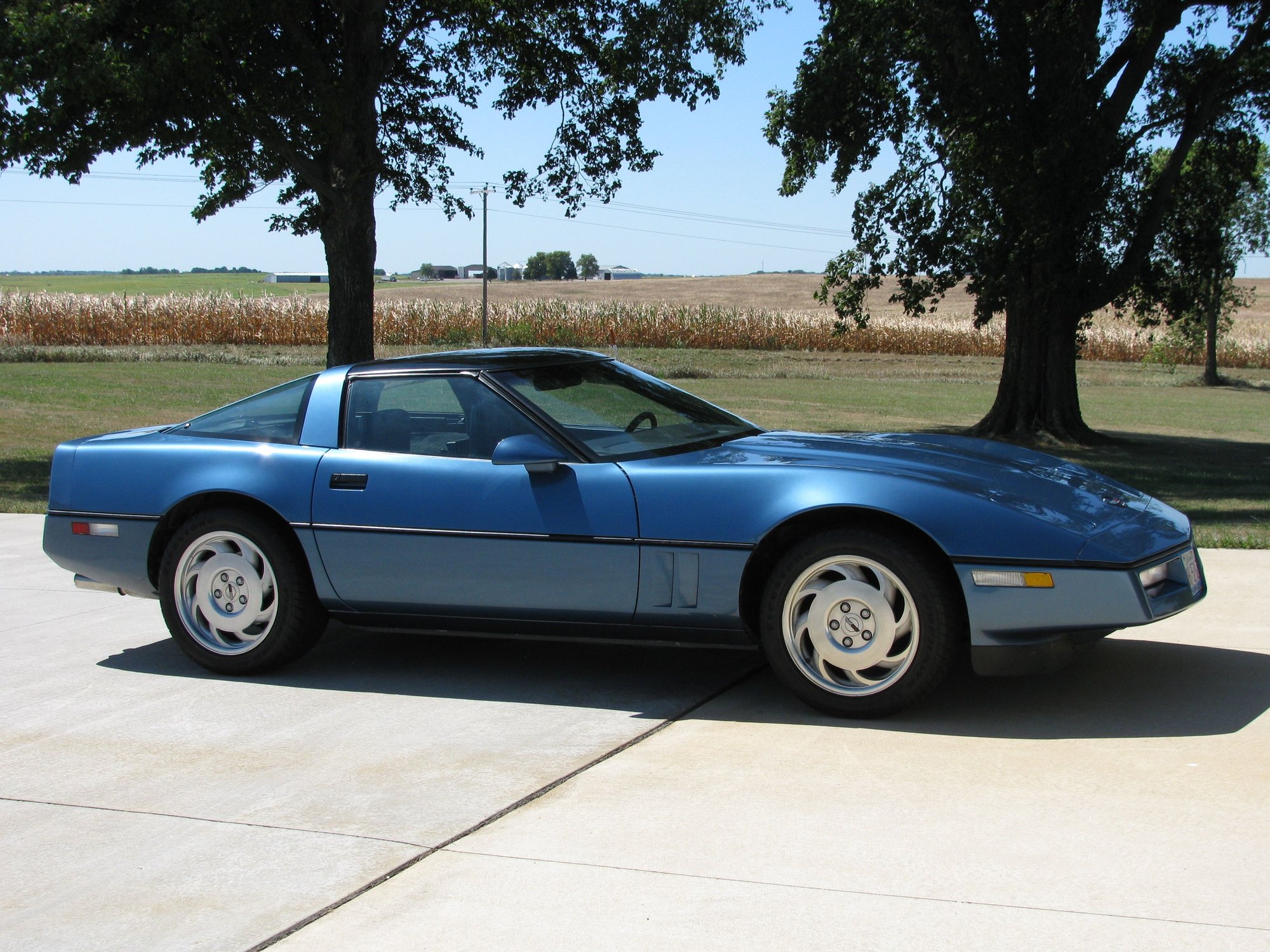

The 12mm spacer (1/2") matches the offset difference between the 9.5" '87 wheels and the '93 wheels.
However, the 8.5" '87 wheels could use a little more (about 3/4").
I prefer the adapters to just spacers. In practice you will need to check how far the studs stick through the adapter to make sure the studs don't contact the wheels.
You also have some flexibility in spacer/adapter size. I have seen the later wheels used on the earlier cars without a spacer/adapter. I have also used 1 1/4" adpaters with the staggered set of '93 wheels.
In my case, I had some 1 1/4" adapters from another project and used them on my '85 with '93 wheels. They fit fine, however, I had the 8.5" fronts and I think if I had the 9.5" fronts it would have been too wide an adapter.
My '85 with '93 (actually '94) wheels with 1 1/4" adapters on all four wheels.
