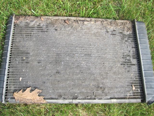

yes i took it out completely and made sure it is completely cleared and i can see daylight clearly through the fins.

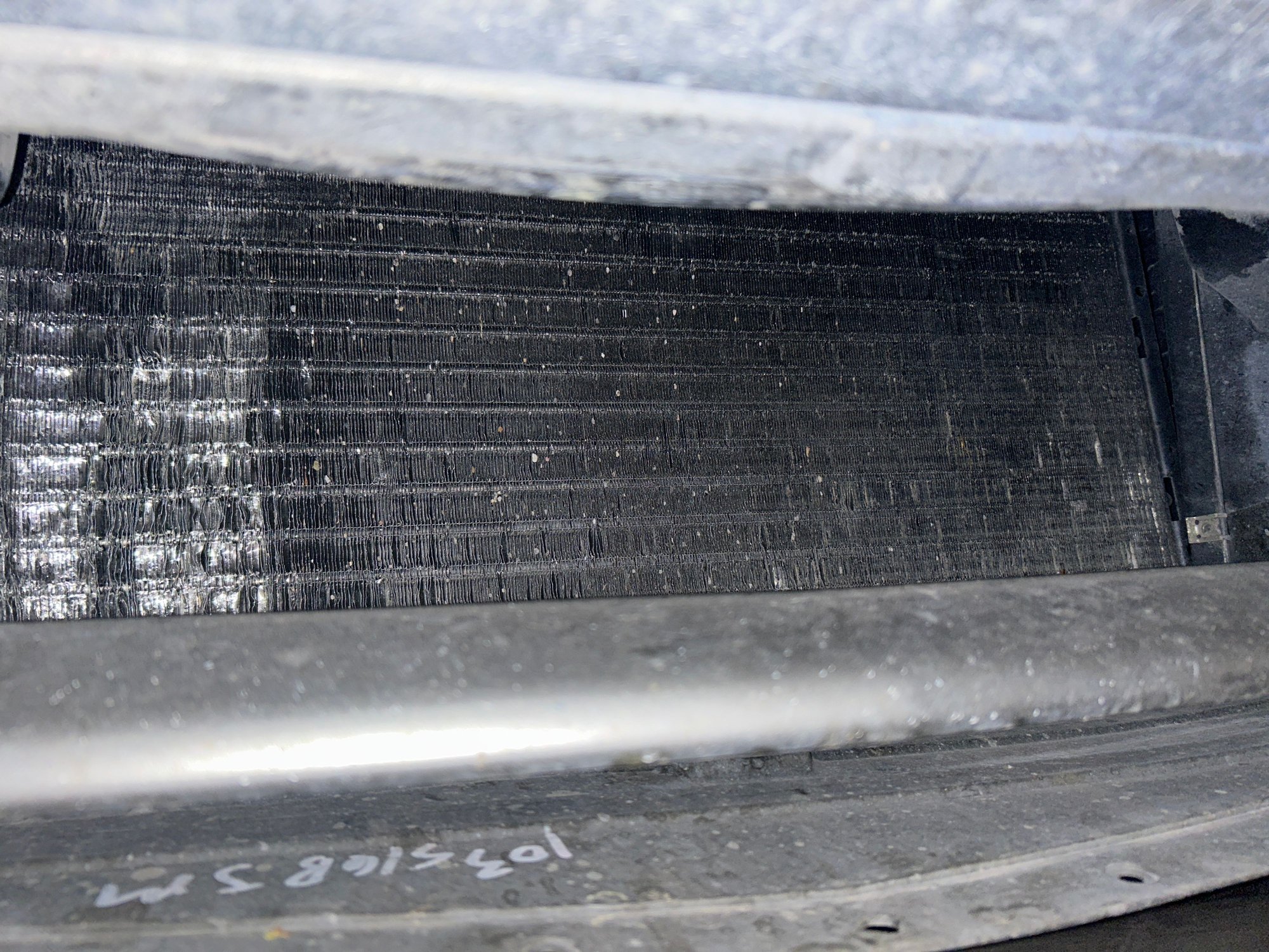

I haven’t done the same with the ac condenser yet because I don’t have the equipment to evac/fill the system. I just ran a hose through it while it was still in the car
This is the front side of the ac condenser. Ive done my best to clean it while in the car but not sure that is enough

That condenser is pretty banged up blocking air flow
