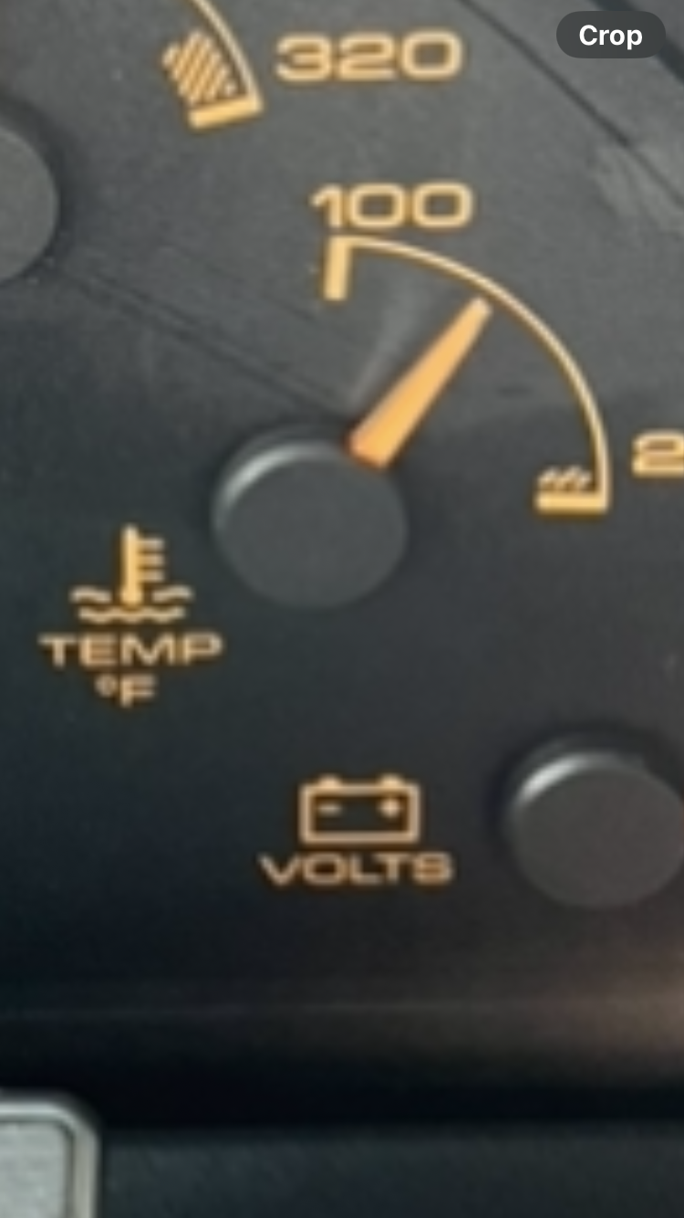

I know there are numerous threads regarding this. I have a 96. Bone stock Automatic. Have owned it for years. Has 86K on it. Runs great with no issues other than it runs REALLY hot. Here is an example. Yesterday I went for a 20 mile drive up the coast. Some stop and go but most of the time I am driving around 35mph average. Temp outside is 63 degrees. .I have the numerical temp gauge on and the standard gauge both on. My car was running at 226 degrees after about 15 minutes of driving.. I put the AC on and it went down to 205 and at one point it was at 198. Shut the AC off and it jumps back up to the 220's. Traditional temp gauge needle wasn't pegged but it was past the 3rd hash mark. My wife was freaking out because she was convinced we were going to overheat. I know there are numerous threads stating don't worry about it and that all LT1's run this hot and its the design of the cooling system etc... but after years of wondering when this car is eventually going to over heat I figured I would ask the question. There is no debris blocking the radiator.
I am now contemplating replacing the stock single core radiator with a 2 or 3 core and be done with it. Its unnerving driving around with an almost pegged temp gauge.. especially when its only 63 degrees out and I am cruising at 35mph.

If the temp went down when you turned the A/C on it tells me that was because the fan came on. Try just idling (with A/C off) and watch temp gauge to see if the fan comes on at around 229. If not then fan is the problem. My 95 started running hot a few weeks ago and found the fans didn't turn on at temp and when A/C was on. Turned out the fuse was blown.
In your case it could be one of the fan relays or sensors are bad,

A 1996 has (2) fans and (3) Relays. Low speed (On at 226F) runs both fans at half-speed, High speed (On at 235F) runs both fans at full-speed. A/C turns both fans on at High speed.
For 1994-1996: First diagnostic: With cold engine, start and let idle with A/C on. (Fans should turn on from A/C head pressure long before engine temp reaches turn-on threshold.) Are both fans running with A/C ON? They should be. If = NO, only one fan in High speedcan be caused by a bad Low speed relay which is the only relay of the three with a single dk green wire.
To validate the cooling fans system and control. (Stock ECM calibration, not a "reflash"):
Coolant temperature <200F. A/C mode OFF. Start engine and let idle.
Watch digital coolant readout: At 226F both fans should come ON and run in Low speed.
> When they do, unplug the single relay with the dk green wire. Both fans should stop.
Watch digital coolant readout: At 236F, One fan should turn on in High speed.
> Reconnect the unplugged relay. Both fans should run in High speed.
Watch digital coolant readout: At 229F, both fans should revert to Low speed.
Watch digital coolant readout: At 219F both fans should turn OFF.
If the above tests pass, there may be radiator restriction or airflow blockage.
The "blockage" that makes a difference accumulates between the condenser and the radiator. Removing the upper shroud and taking a look is definitive. Taking a peek under the bumper isn't. You may be able to see something with a camera-scope between the condenser and the radiator, but I've never tried it.
