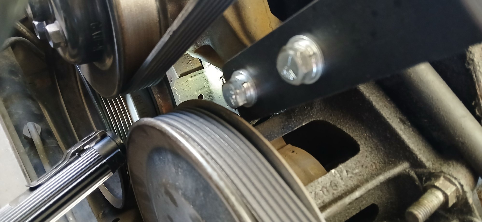

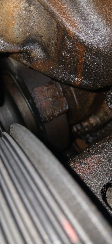

Having a bad vibration as you may have read in my other thread about what is making this noise. The AIR pump I replaced wasn't the problem. Took a look at the balancer and noticed the timing mark would not be visible. So I looked at my other 85 and took a picture of each. I am 99.9% certain I have a bad balancer. What are your thoughts? Here are a couple of pictures.
Other 85 that appears ok.
One I'm having the problem with.
You can see how far forward the timing tab appears to be compared to the 1st picture.
Thanks for looking and any advice you can offer.
Joe K

Truthfully I don't think either is Healthy, if memory serves the timing scale rides more center and the ring is flush with hub. Put a timing light on it usually when they fail they twist and line is off scale. When testing make sure to disconnect the EST wire like your checking the timing.
https://corvetteparts.com/item/balancer-350-engine-crankshaft-harmonic-aftermarket-1981-1991
Since it's the same balancer here's a picture of my 81s

I agree s carter, it appears both should be replaced. Thank.
