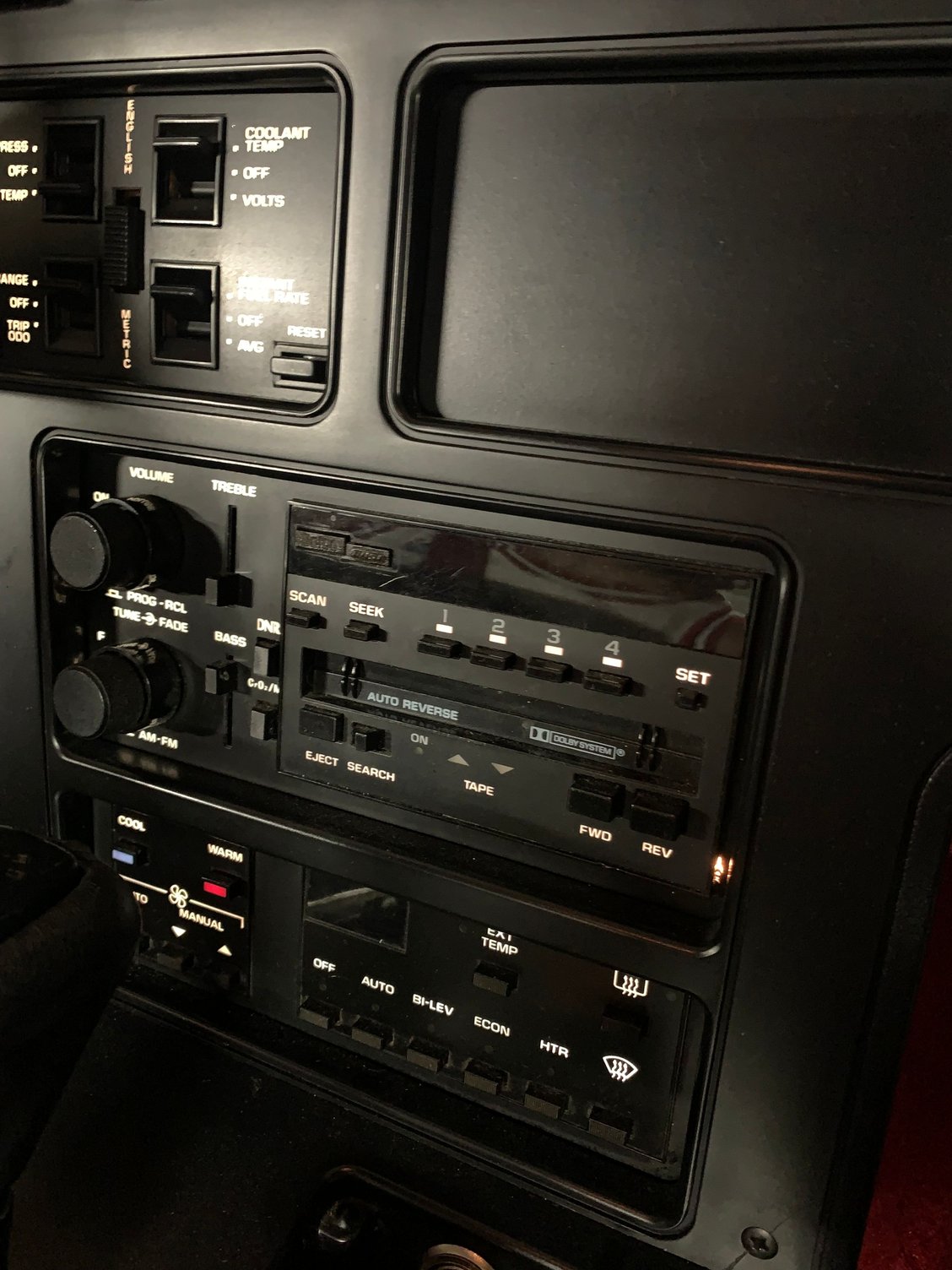

Hello everyone
I want to ask all of You if someone had the same silly situation as I have. My „lady in red” is sleeping now in winter garage (Norwegian winter &#128533 .
Waht is the problem and question…it stars few month ago …when I took a cruise it starts that the number on the screen of air condition starts somethimes , I will say, disappear. For a moment, somethimes for a longer time.
And now at last is like that like on the pictures. Air condition panel shows the temperature and light shows options but when I tur on the position lights everything on everything is shining but then the air condition not (weird ☹️).
I things important fact is that not happend before. Everything was ok.
please help
Air condition have a lights and screen
When I turn on lights then I have position lights and every interior lights but air condition desapper( I took out radio fuse because that took me a power from battery but that is for another post but maybe important fact 🤷&#127995

When the temperatire display goes away, does the HVAC system still work totally normal?

Unfortunately it looks like it doesn't.

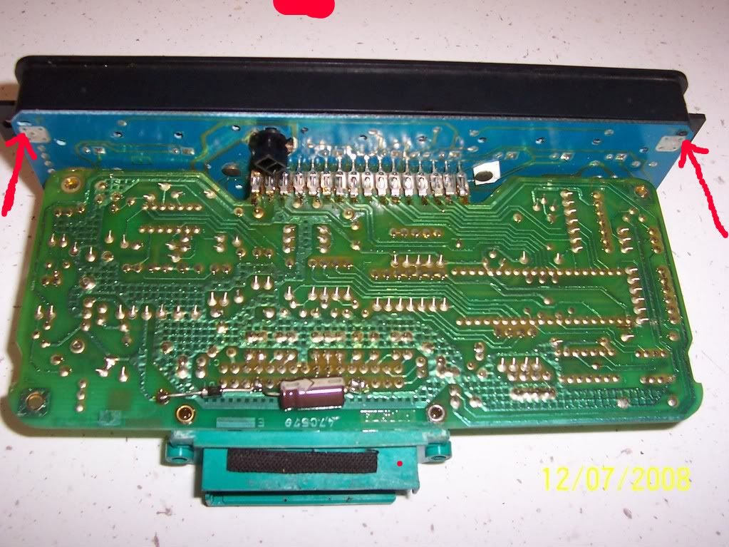

Yeah, Batee is kinda good. You can't ask a question and expect a reply, but they'll fix yours for reasonable price and have intimate, long-term knowledge/experience.
You're probably having trouble where the main circuit board plugs into the back of the face. It's a fairly common problem -- especially as our cars age. One owner got so miffed they soldered them together....
NORMALLY, THE TWO PLUG TOGETHER.
I took mine apart several yrs ago and cleaned the contacts to "fix". Need to do it again. If I had circuit board (level) soldering skills, I'd do this modification too!!!

Clean contacts with pencil eraser.
