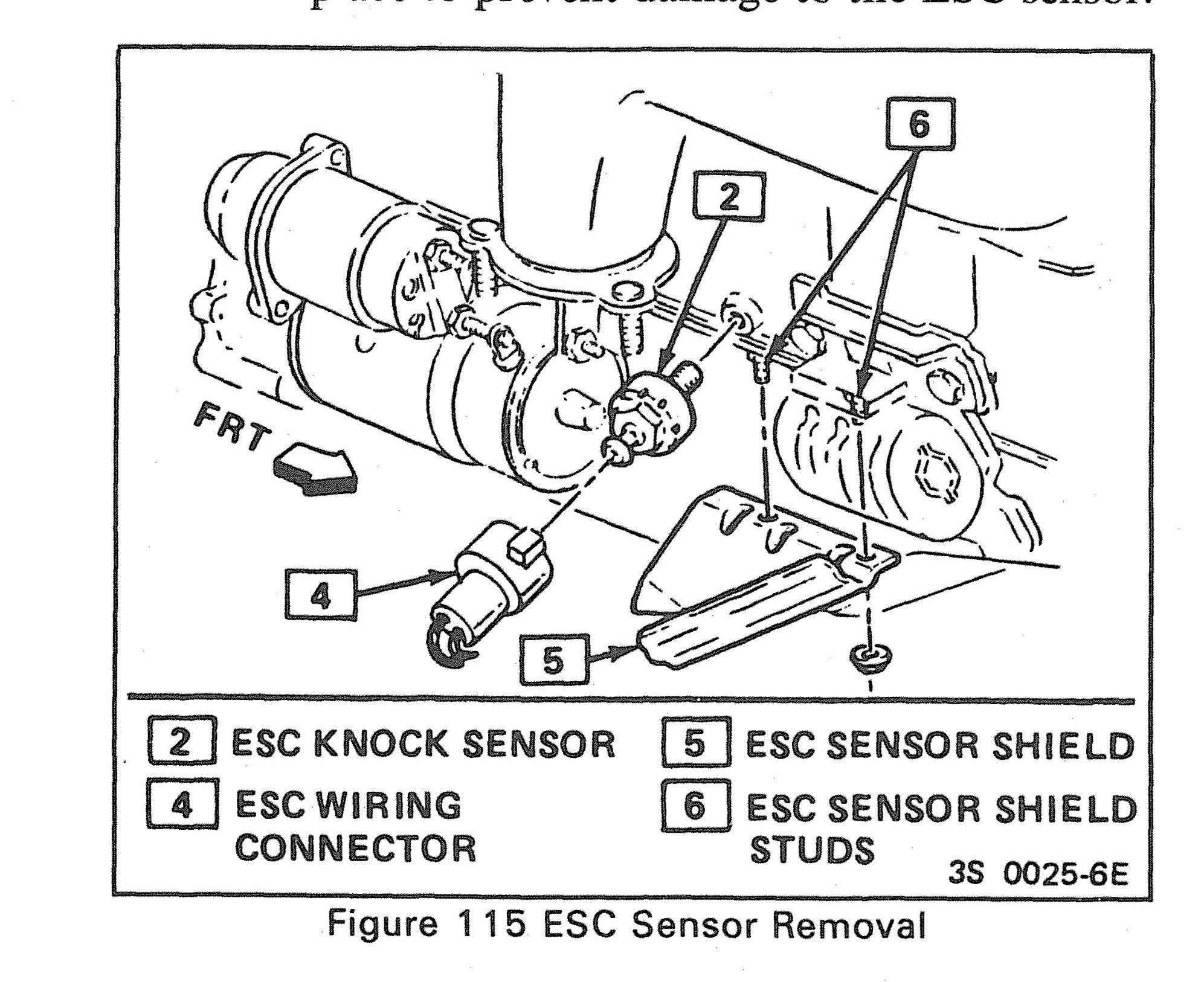

On the passenger side you have to remove the knock sensor, it's threaded into the block drain hole.

If you have the same 1985 FSM that I have, there is a picture of the location of the knock sensor on the passenger side on Page 6E3-107. Section 6E is Driveability and Emissions Fuel Injection (Port).

From the FSM 6E-107

Thank you. I didn't realise that the passenger side block coolant drain plug was just the knock sensor itself
