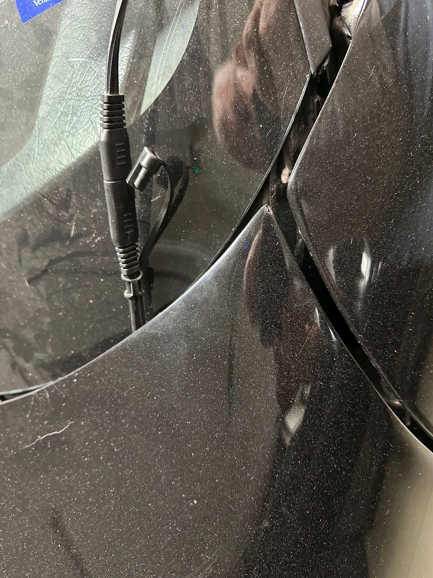

This is the same as I used on my '91. They did come with a quick disconnect.....not sure about now.........I purchased battery clamps that were fitted with threaded posts to fasten rings on quick disconnect. I then used the fender gills to run the cable to the battery tender. And simply folded the cable on itself and placed back into gill when not in use. Ran this for years without any problem. I purchased the clamps at NAPA. And if not sold as part of the battery tender in the box, believe the quick connect is available from battery tender. Good Luck! Do a search on forum, I may have created a pic of my setup years ago.[/QUOTE]
Found a pic of disconnect cable out through the gills on the linked post. I actually ran the cable out of one of the gill openings and back into another instead of folding over......a lot of time has gone by and mind is not what it once was. https://www.corvetteforum.com/forums...ry-tender.html
Found a pic of disconnect cable out through the gills on the linked post. I actually ran the cable out of one of the gill openings and back into another instead of folding over......a lot of time has gone by and mind is not what it once was. https://www.corvetteforum.com/forums...ry-tender.html[/QUOTE]
Interesting... thank you!
