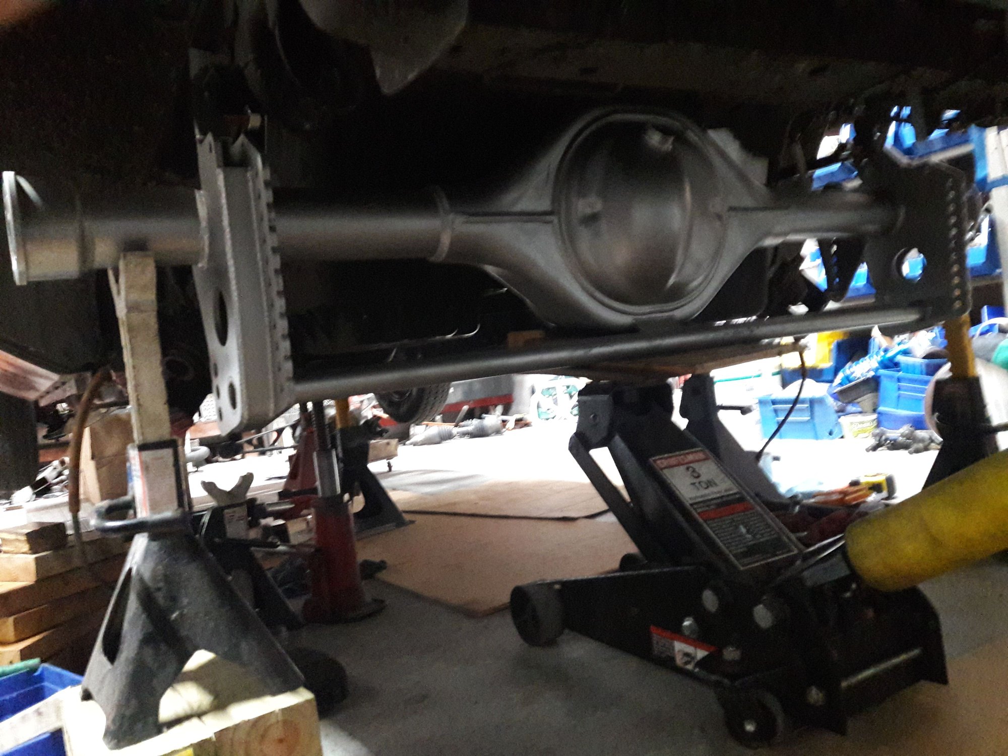

Originally Posted by C409
what is the bar hanging under the diff do?
How is handling on the street? And are you still running ABS sensors on the street with it?
i have some expensive decisions to make shortly - wish i could have bought some of your IRS beef up components when you had them for sale - if i decide to stay that route
Old Dec 2, 2024 | 08:56 AM
C409's Avatar
C409
Joined: Feb 2005
Posts: 6,475
Likes: 565
From: Clearwater Florida
The bar keeps the link brackets in place ... a little side-to-side stiffener . I never drove this car on the street after the 9" install ... I cut the exhaust off just ahead of the diff and put turn downs on the pipes . Routing pipes over the axle would have been challenging . I have a spool in it also ... when I still had the D44 and spooled it , street driving became tedious when making any kind of a turn . Surprisingly , Drag Radials were easier to turn than the Michelin Pilot Sport street tires were . ABS pump has been gone for a long time .

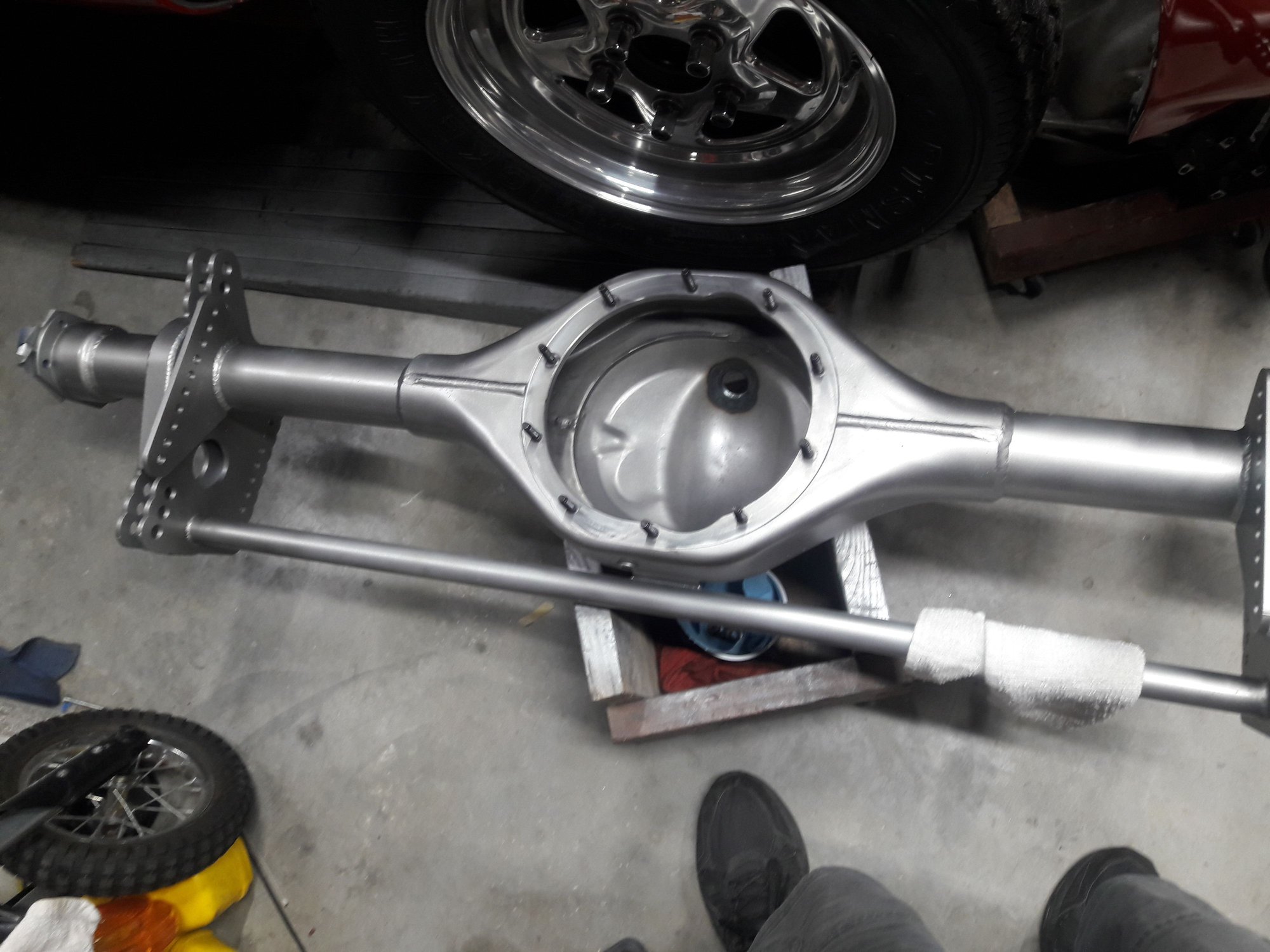

Here is a partial shopping list for those of you considering a live axle conversion ...
The housing ... axles ... bracketry (4-link , shock mounts , frame brackets , locating device (panhard , diagonal link , wishbone , or watts) ... The link bars (tubing , rod ends , threaded inserts , welding) ... Coil over shocks and springs ... brakes ... Lots of grade 8 fasteners , washers , locknuts , etc ... The differential itself with gears (9" has an abundance of ratios available) , LSD carrier (Clutch style posi , locker , spool , True-trac), housing (nodular is stronger than aluminum but aluminum will save around 15#) ... driveshaft ... exhaust mods ... wheels with an offset that works under the vette restraints ... Driveshaft hoop ... Transmission rear support ... transmission (700R4 or 4L60 will not survive long , especially if you have a trans brake)
I paid just under $2500 delivered for the housing (as pictured above) performance axles , complete new rear brakes .
Bought a nodular diff on Ebay with spool and the gear ratio that I wanted for $750 shipped
Afco double adjustable shocks about $800
I probably spent $1500 on all of the misc. hardware , link bars , heim joints , panhard (I am lucky that A.R.T. is in my county) ... don't buy your bolts and nuts from Home Depot or Ace hardware ... find a fastener store .
My wheels 6.5 & 7.5 backspace used with D44 , worked with the dimensions that I provided to Moser
My driveshaft worked also but I had to source a 1310 pinion flange for the 9" (there is a 1310 GM & 1310 Ford)
I know that I forgot some important pieces so keep that in mind when you set your budget ... these are 2021 prices .
Diz , I still have 5 or 6 outer stub axles , halfshafts , and bearing hubs for the factory D44 .
