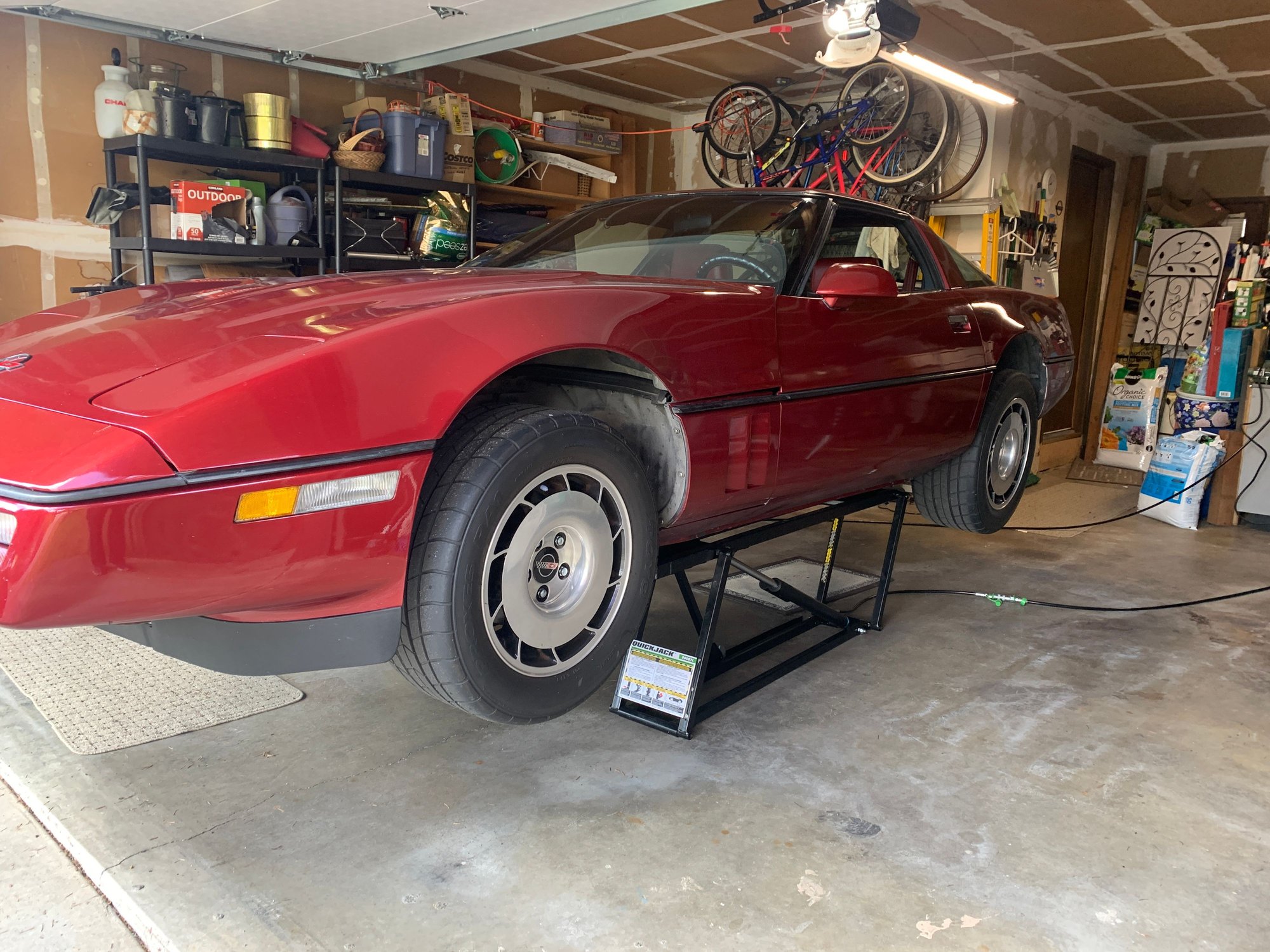

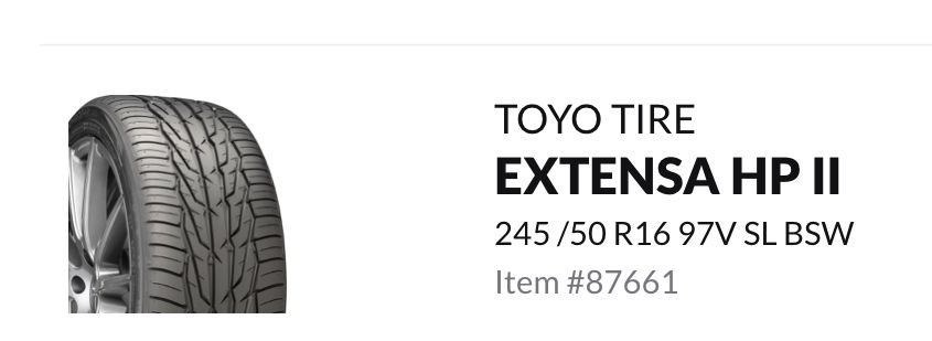

I’m running these 245/50 -16 on my Z51 rims. NO issues whatsoever.. they handle well, look good and are about $100 each at Discount tire.

I put 245s on Z51 wheels. Its fine. Its what the car had on it when I got it, I put 255s on it and now it has 245s again. Its true the manufacturers dont recommend it, but it works fine and honestly I like these tires better than the 255 sport comps or whatever they were.
