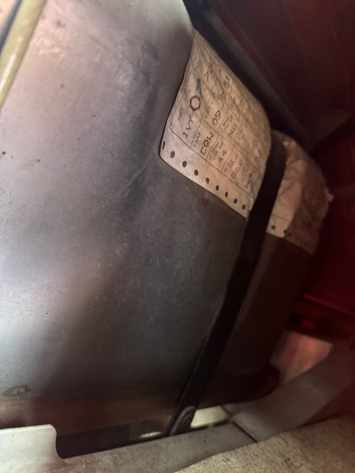

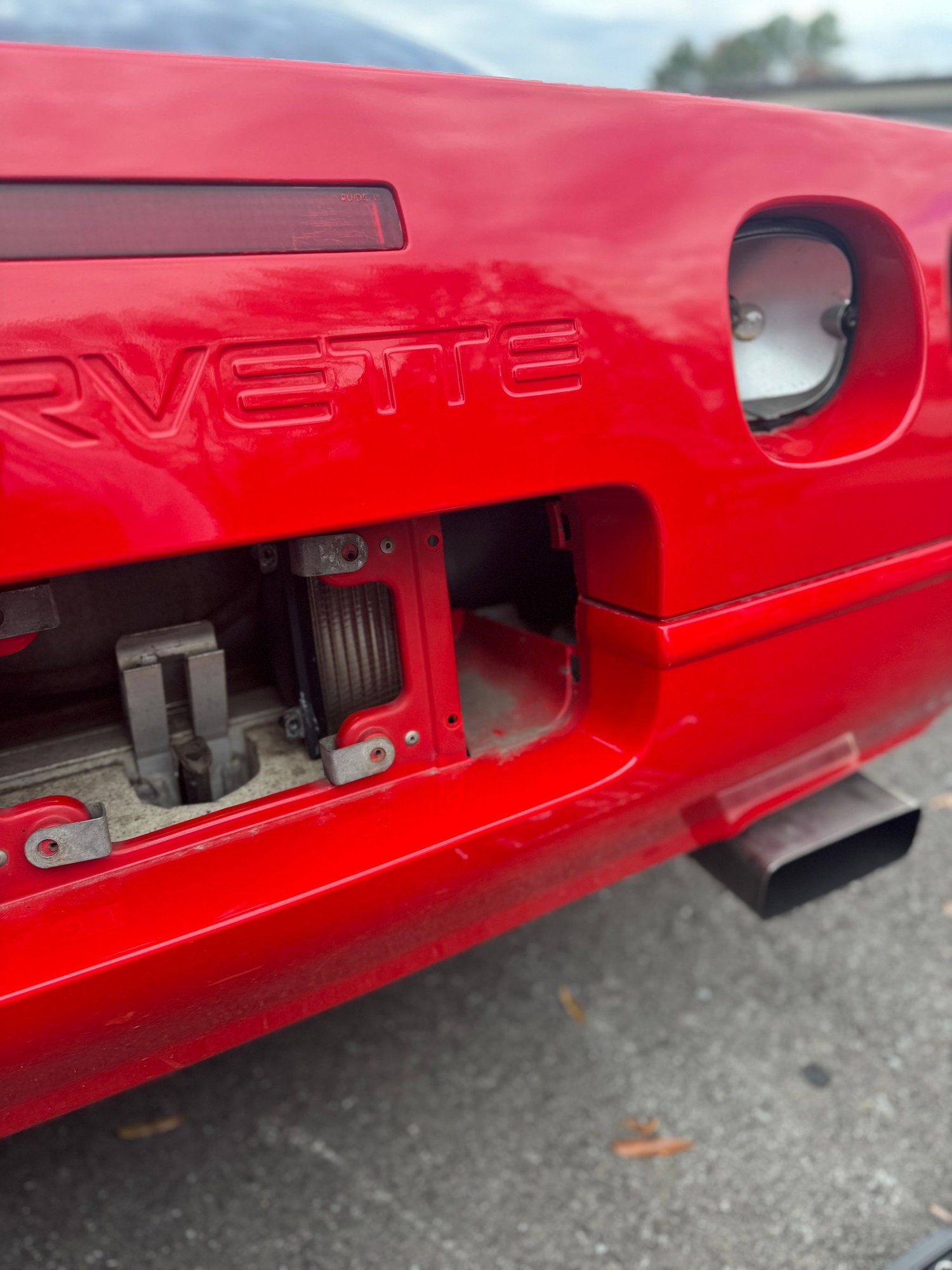

Looking to remove my original build sheet on my 95 base coupe. It’s in tact behind the right tank strap on my gas tank.
Can I just loosen the strap and pull it out from the taillight lense?

You could do that by just loosening the strap.
But the thing is that it'll still be stuck on there. You're gonna have to be very, very careful and pull it/ blade it off very delicately.
Mine was pretty much disintegrated when I replaced my fuel tank.
I ended up just throwing it away. Couldn't even read what was left of it.
Yours looks to be in pretty good condition, though.
But not much room to work through the plate opening.

Only the passenger-side tank strap. Clean (wire brush) and lubricate the bolt threads on the strap, as they'll likely be encrusted in decades of road crud. If you don't do this, you run the risk of twisting the strap into a pretzel as you remove the nut.
With both passenger-side taillight housings out you've got great physical and visual access to the tank strap and your build sheet. Follow the tips listed in my link above and recovering your build sheet is an easy, satisfying job.
As noted in my link, be as careful and gentle as you can removing the four bolts that secure the backside of the two taillight housings, as the plastic bolt bosses will likely be brittle with age.
