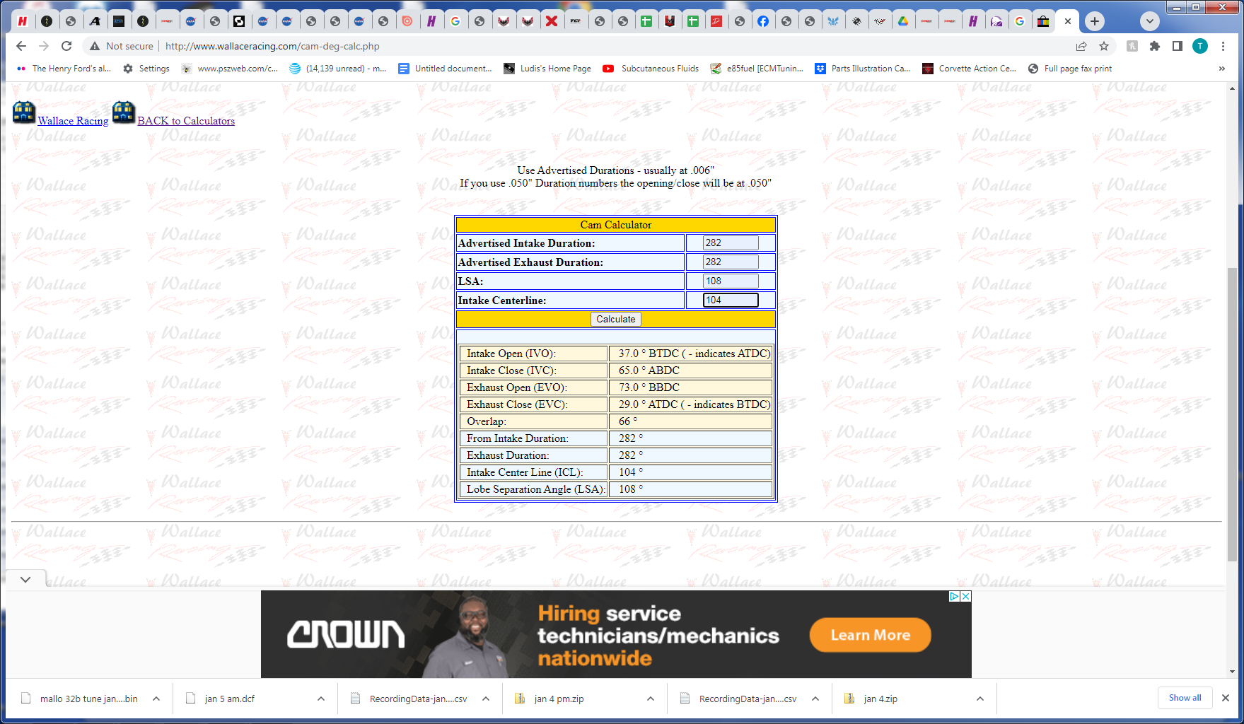

Wallace Racing has pretty reputable calculators, from my understanding. they're a little cumbersome going back & forth one at a time, but they seem to work well so long as you know & input the correct values.
http://wallaceracing.com/Calculators.htm

I sincerely appreciate your feedback. Yeah, something didn't quite pass the giggle test with it. I think I've set myself up for as efficient as possible. eg: Running some mahle powerpack pistons . . . seriously, what idiot pays $900+ on pistons to make 275hp? (answer: me).
Thanks for the heads up on the core material, another rabbit hole I get to dive into
