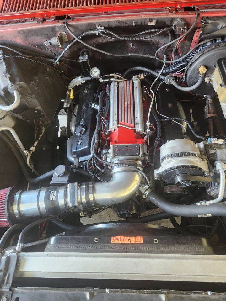

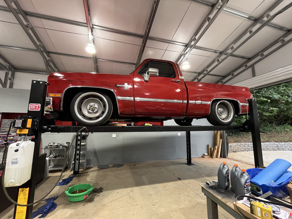

Good afternoon, y'all. I picked up an '86 C10 with a slightly hot rodded (cam, comp rockers, etc., nothing too serious) LT4 in it a while back and am running into some pretty significant oil consumption issues, oil on plugs, etc. Since I'm kind of an all or nothing guy, instead of doing a piece meal reseal, I'm thinking about just pulling it, doing a ring/seal job on it.
My question is - is there a comprehensive list of all the gaskets/seals (outside of obvious ones like, intake/exhaust/head/valve/etc) I would need out there? I tried doing a search, but didn't come up with a lot.
Couple pictures of the rig.
