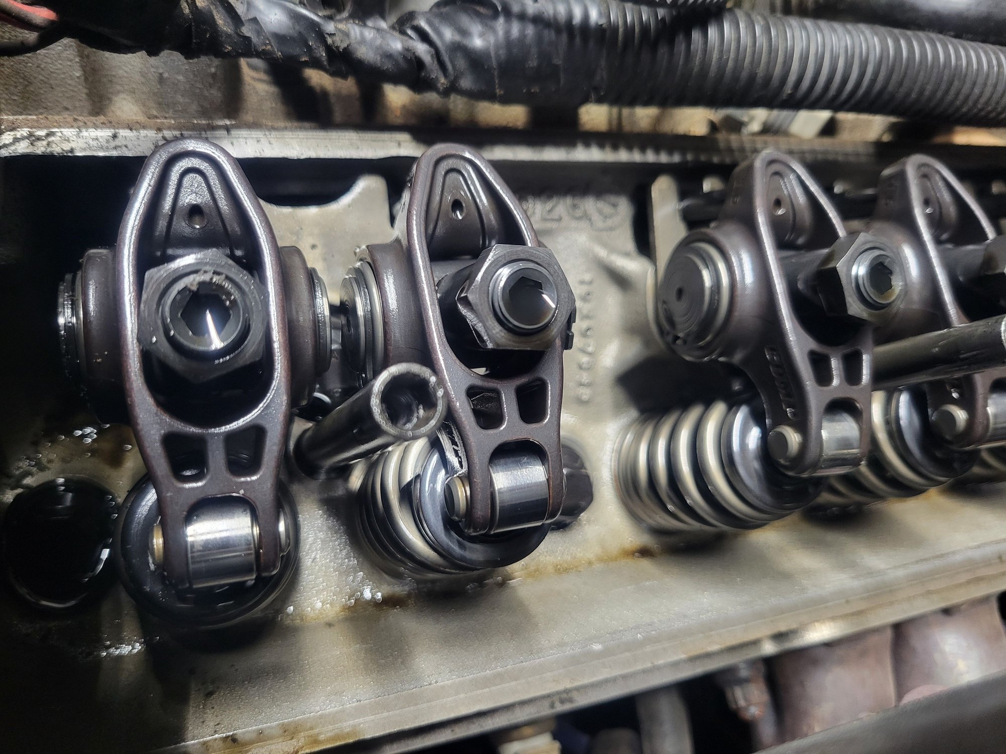

Started to tear apart to see what was what and this was my first clue something was awry. Valve spring is nearly completely out of the top hat on cylinder #1.

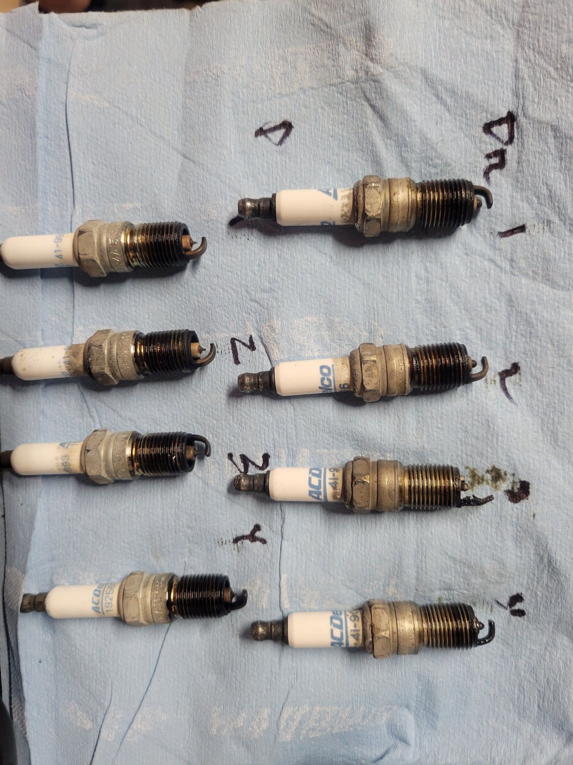

Pulled the plugs and knew something was very wrong. Check out cylinder #5's plug (labeled as Drivers 3). Yikes. Also two completely different plugs in this set. No idea as to why on that.

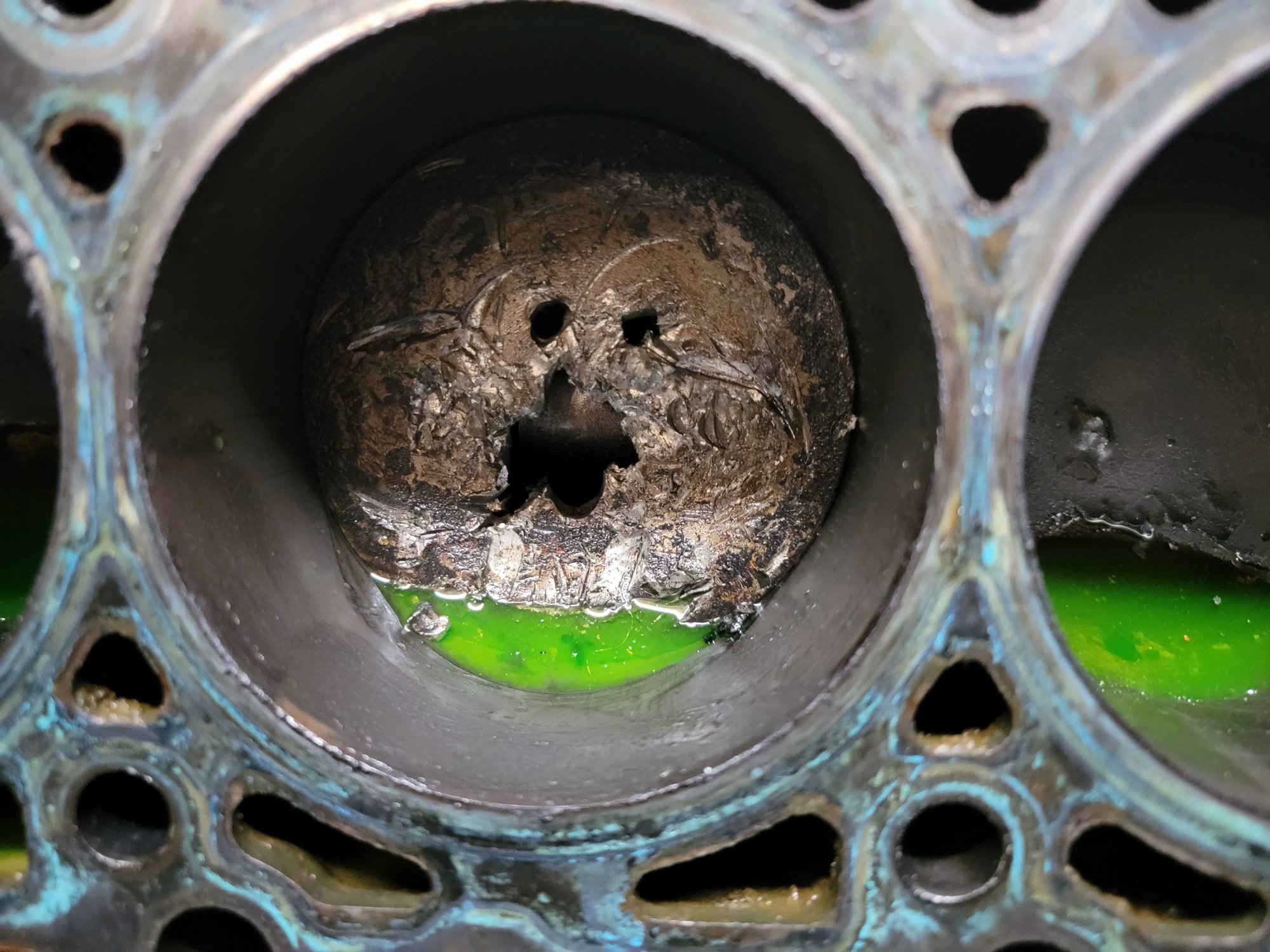

And here it is. Big ol hole in piston #5 and you can see some of the shrapnel in cylinders #3 and #7.

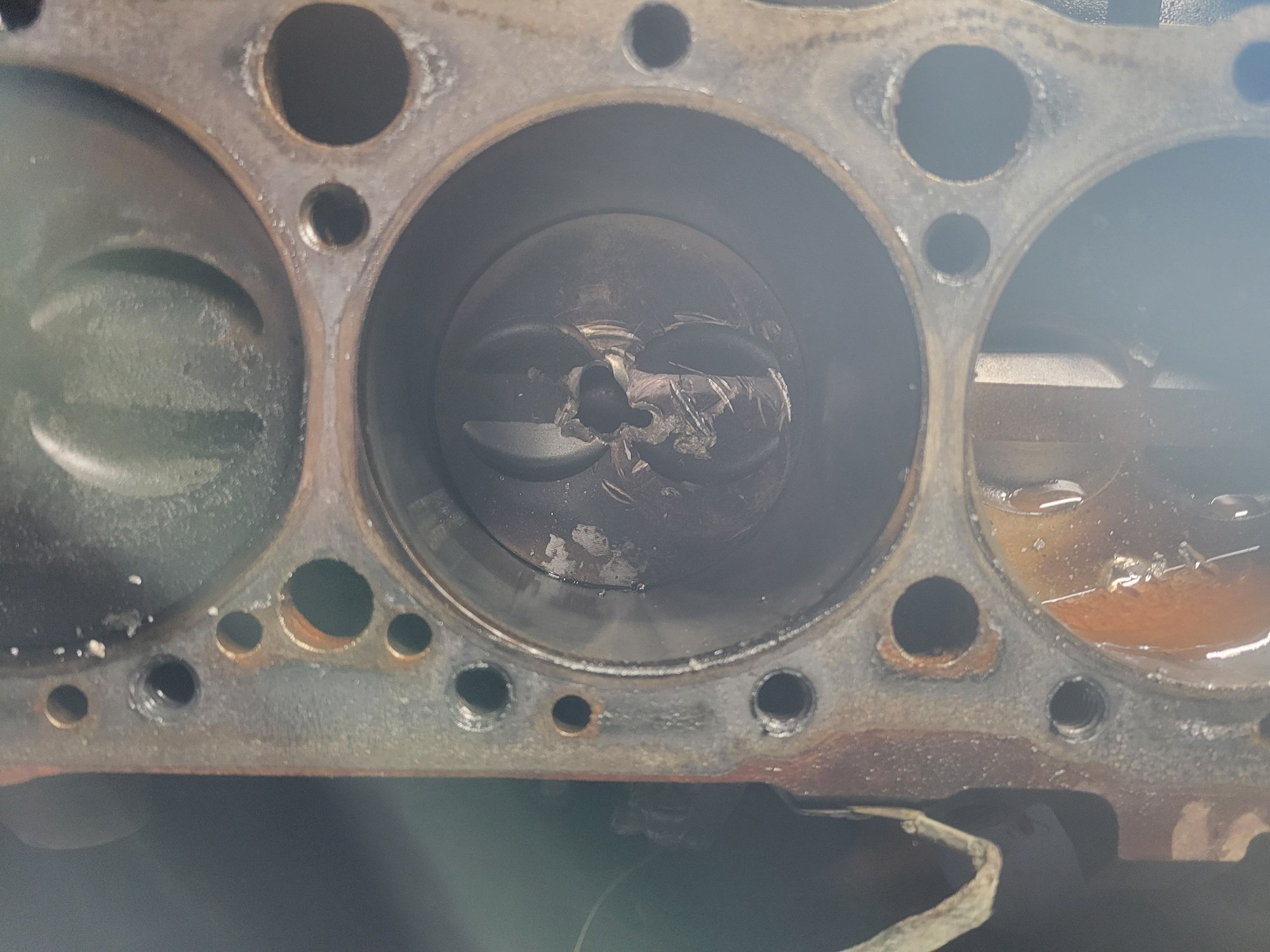

Some of that metal made it through the intake over to cylinders #6 and #8 as well. Lovely.

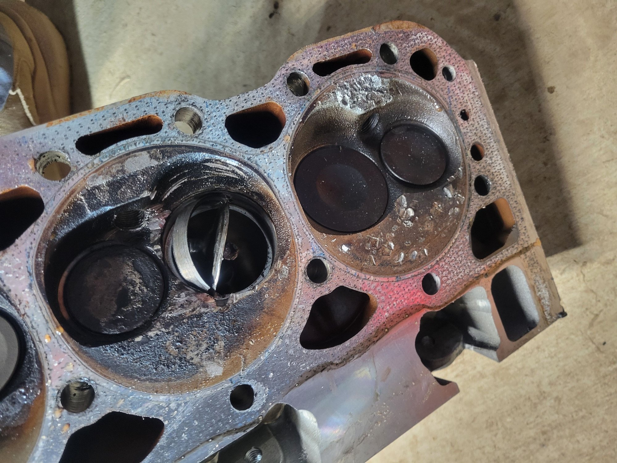

Here is the drivers side head. Intake valve snapped clean in half and twisted in the seat.
So my question is what caused what? Current hypothesis (though this is just a guess tbh) is that I had valve float causing the spring clip to pop off and the valve to drop and contact the piston. If you have another explanation I am very curious. Also, cylinder #1 looked totally fine yet its valve spring is nearly completely off the top hat - would the same thing have caused that as well?

OUCH!!! With an out right hole punched in that piston and not just a top ring land broken off I would say you have it right as to what happened.

Ouch..been there before. Was the spring install height checked when built? Coil bind maybe and the spring let go?

More than likely it got hot enough to drop the intake seat.... valve hung open, smacked by the piston a few times and eventually, boom.

OK that explains that Cylinder but what about the one next to it ? Had to come from the Intake and had to be multiple parts for multiple cylinders.

Collateral damage is the easiest one to explain. The #5 intake valve is broke in half and wedged in the seat sideways. So everytime that piston came up it forced debris back into the intake around the broken valve.

Also, that valve spring on no.1 appears to be broken. Hard to tell but they look like beehive springs.
