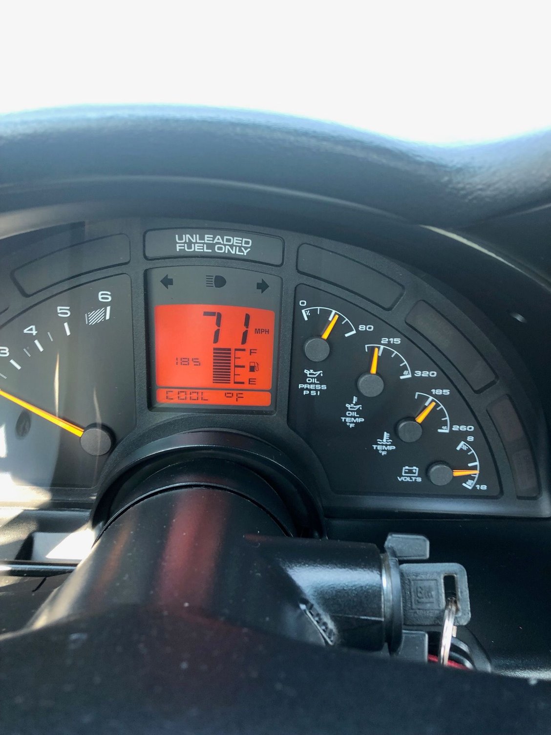

my factory fans plus my DeWits radiator keep my car in the 185-195 range and I live in the Mississippi Delta where you can fry eggs on the sidewalk mid summer
