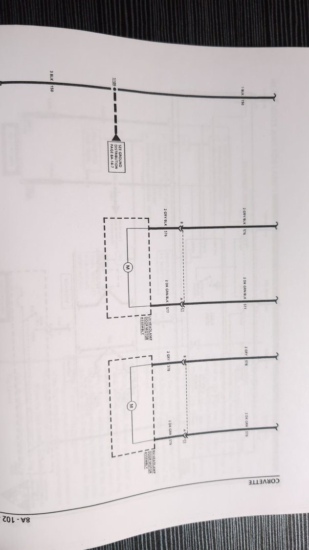

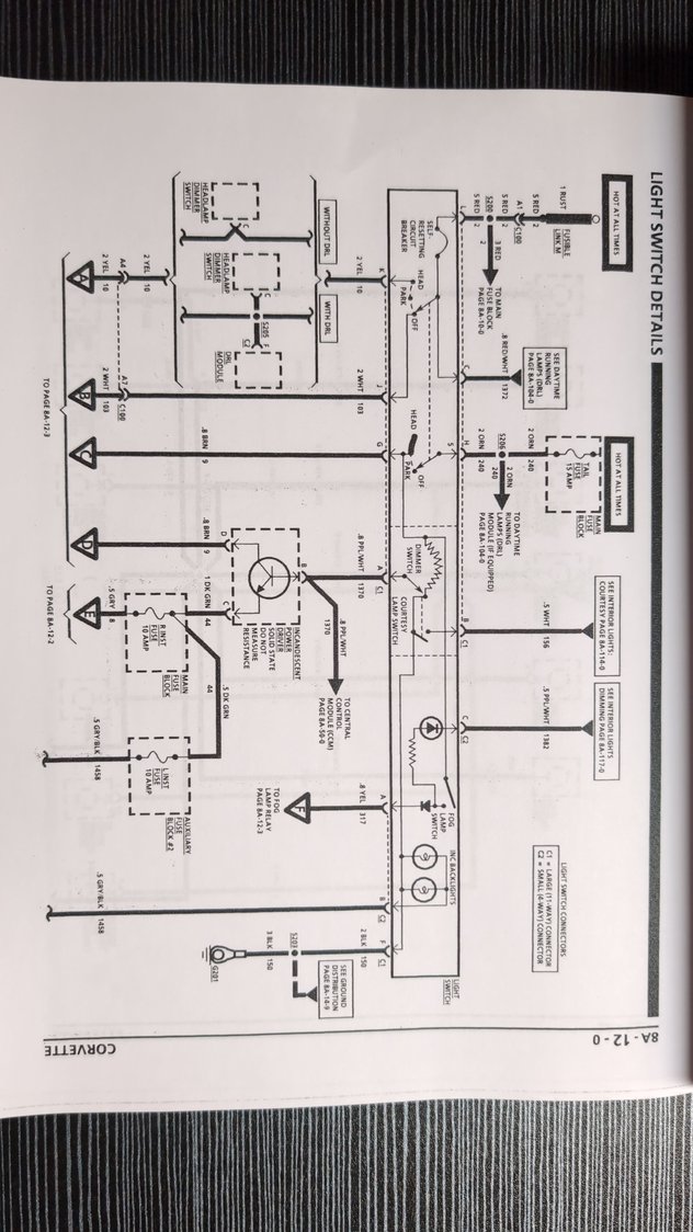

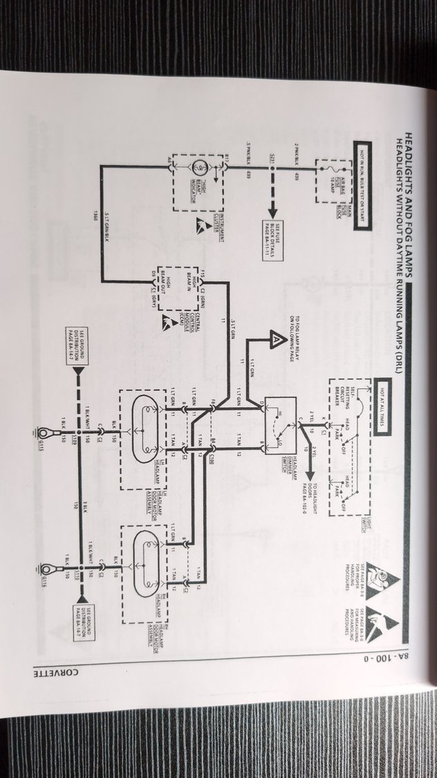

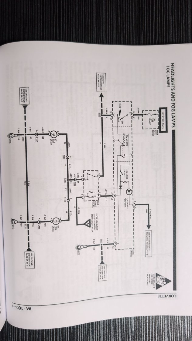

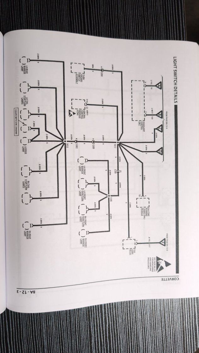

Hi have attached some headlight diagrams from my 91 shop manual, may be helpful to fault find.
Should be same with your 90, you can get canbus decoders a resistor device. They came with my led lights however I did not need to use them, some modern cars do require these for resistance or shows
a light fault on dash.
