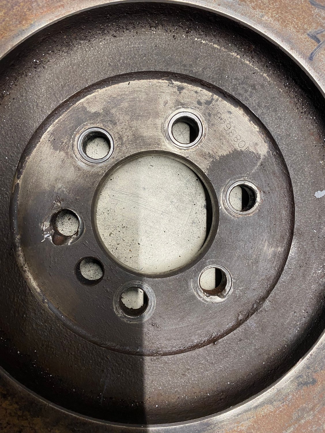

I replaced the clutch and flywheel some months back, new LUK clutch and flywheel and ARP FW bolts.
This is a pic of the original GM flywheel, and shows some really sketchy work, this is why my thinking is the engine has had some work, and not correctly done. The FW bolts were a mixture of OEM and hardware store grade, and not sure what caused the bolt hole damage, but damn, that’s pretty bad. So this is what I’m dealing with; past crappy repairs and no history. This vibration is driving me nuts.

The part # 14088646 would have been correct for any L98 Corvette '86 - '88
I understand that, and that was never a question, but before I replaced the clutch, I didn’t know if the FW had been replaced, so when I replaced the clutch I bought and installed a new FW. I was hoping to find a neutral balanced FW which would have explained my vibration, but no such luck. Though the original FW has seen some things, which tells me a lot of work has been done.
