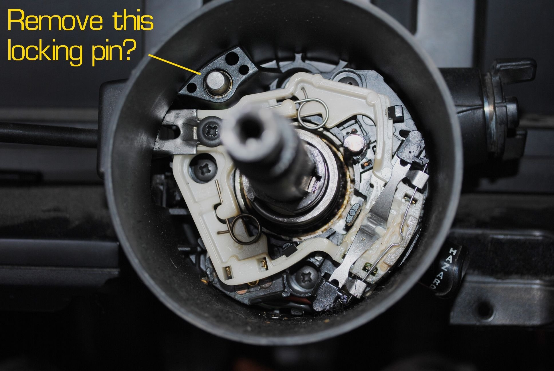

I'm in the middle of replacing the key cylinder on my '89 and since I think I've hit a necessary pause in action with the stupidly brittle plastic carrier snap ring insulator disintegrating into three pieces on me, I'm thinking about finding a way to disable the steering wheel lock function.
I don't know about y'all but that function scares me. I'd rather take the hit to theft deterrance and remove any possibility of my steering wheel locking up on me while driving. Forgive me if I don't have a ton of confidence in GM's engineering of this system...
So what's the best way to do it? Ideally I'd remove the locking pin to achieve a reversible modification. Is this feasible?

Your car is an M6 or an A4? You want to only defeat the pin that locks the upper lock ring that has 12 I believe slots?

Yeah, I was thinking that pulling that pin out seems like the simplest solution, versus cutting down the lock plate or something.
Here's a shot for anyone unfamiliar with the guts of this assembly. Visible here is the notched plate into which the pin inserts. In fron of that is the yellowed c-clip insulator piece that is apparently made of dried snot. This is the "before" shot.

Does anyone know how that locking pin comes out? If I pull the key cylinder back out, does that pin simple push through to the backside and fall out?

You need to go deeper into the column to actually remove/defeat. The spring that actually stabilizes and gives movement to the rod might actually rely on the pin to position it properly for cylinder pawl and rod to ignition switch to function. You're hell bent on trying to defeat things that ain't creating any misery! How much do you need to 'bust' to be happy?
Here's an exploded tutorial that might educate you. It's NOT a Corvette column but it's very educational.
https://www.crankshaftcoalition.com/...ck_Rebuild.pdf
*** With out that pin the spring that retains and allows the 'pawl' to rotate won't function correctly. See pages 23/24/35/36 in that tutorial.

I'm definitely not hell bent on this. In fact, I decided I was out as soon as I read "deeper into the column." That ain't happening right now. Maybe some day when this isn't my daily driver but right now I really just want to get back on the road.
It does seem now like omitting the locking plate might be the simplest way to go, though. I don't think it performs any other function. Maybe replaced with a washer, since the C-clip does push against it. Oh well--not a concern right now..

Lock plate orientates and locates the cancelling cam I believe, loads the spring for upper travel. Just a washer I wouldn't think would get the job done.

On second thought, maybe I am going to pursue this. Just read through this thread about it:
https://forums.24hoursoflemons.com/v...c.php?id=38975
And, wouldn't you know it, what's the car they give as an example of unintentional wheel lockages resulting in recalls? Of course.. the Chevy C5 Corvette.
I have a spare column from an '85 so I'm going to tear it down and if the lock ring is intact, I'm going to cut its notches off and use it on my car.

That should work and much better idea than a washer. The plate is part #'d the same '84 - '89/

Yep, I just got my spare column apart and found that its plate is indeed identical. A lot rustier, actually. Also, this piece looks, sounds, and feels like it's hardened so this could turn out to be a real chore.
The horn contact ring/cancelling cam has the same flat on it as the locking ring so it would stay put on the shaft without the plate in place but they do interlock and I assume this is to provide extra rigidity to the horn contact, which makes sense. Another nudge toward retaining the ring and cutting the notches off.
